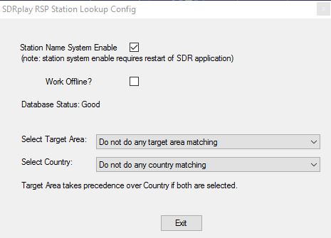

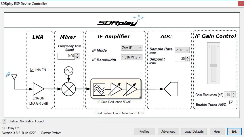

I have been having the same issue. Just discovered the button in the lower left corner, but it reads No Station Found. See attached screenshots..Thanks

No Station Found means that it hasn't found a station on the frequency you are on. What frequency have you tuned to? Not the LO frequency, but the VFO frequency.
Also, after the station system has been enabled, it requires a restart of the SDR application you are using before the system is functional. However, it reports the database is good in your screenshot so you should be good to go.

I finally got it working. Apparently I hear a whole lot more than is in the database.

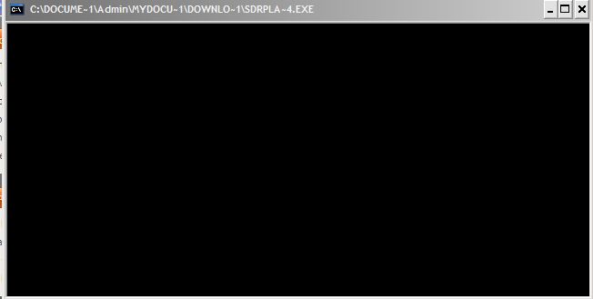

My mistake (and apologies), this window which had nothing but a cursor randomly doing odd things (NOT A DOS WINDOW)...i may be getting too old for this.

Hi,
I still don't know what that is - can you explain what you did to get that window - I don't recognise it and I'm concerned it's something malicious.
Could you send a screenshot of the directory listing where this executable is run from to support@sdrplay.com
