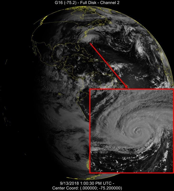

Hurricane Florence full disk and mesoscale images received from GOES 16 this morning:
GOES 16 FD and Mesoscale - Hurricane Florence September 2018 - 2.jpg (155.9 KiB) Viewed 56936 times

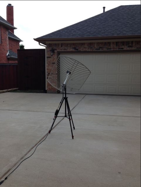

RSP2user wrote: In the United States for GOES 16, the polarity that works best is a diagonal polarity from bottom right to upper left when facing the satellite.
Can you clarify this? I'm behind the antenna looking south through the mesh, so I put the right side lower and the left side goes up. But in your pictures it appears to be the other way?
RSP2user
Posts: 108
Re: HRIT and LRIT Low-Cost System
Post by RSP2user » Wed Sep 19, 2018 12:04 am
Rob,
The "right side being lower" is referring to the position of the feed element, not the primary reflector. The polarization angle plus skew angle should look like this for GOES 16. Even though the specified polarization for GOES 16 is vertical, a diagonal position has been found to work better based on the skew angle and location for many users. Try adjusting for the skew angle to see what works best for your setup. To determine the location to point the antenna and the skew angle, you can use the following site to locate GOES 16 at 75.2W: http://www.dishpointer.com/
IMG_3271FA v2.JPG (40.81 KiB) Viewed 56293 times

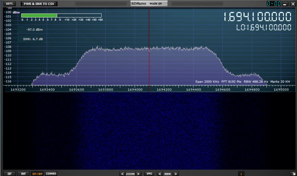

Once you have the antenna positioned, and the LNA hooked up and properly powered you can use SDRuno and the RSP to verify you are receiving the GOES 16 HRIT signal on 1.6941 GHz. Use 4 MSPS sampling rate for SDRuno. You should see the following signal:
Initial Test - NooElec SAWBird GOES using SDRuno on G16.JPG (118.7 KiB) Viewed 56291 times
