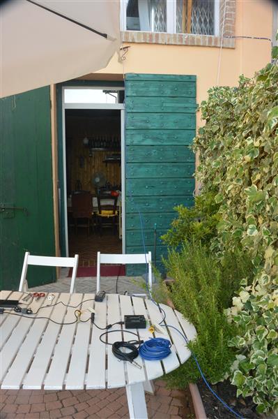

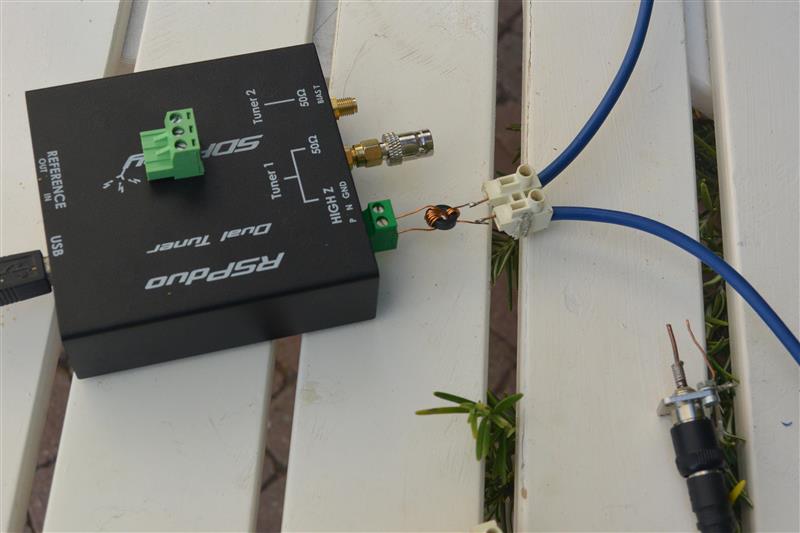

More pics.
- DSC_1112 (Medium).JPG (70.37 KiB) Viewed 36174 times
- DSC_1111 (Medium).JPG (140.83 KiB) Viewed 36174 times
Re: Testing RSPduo receiver sensitivity with noise generator

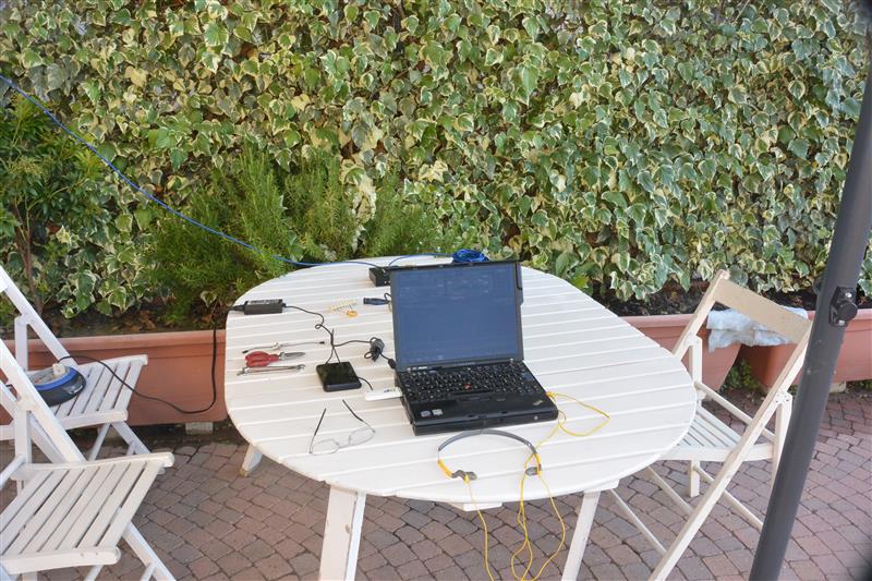

Great pics, Gianfranco, lovely day for you and us, beautiful winter sun all day. We have our house on the market and today was an inspection which kept us busy in preparation.
BTW it was good of you to put out that extra couple of chairs for us, sorry we couldn't make it. We are settling in to a nice bottle of soft McLaren Vale Merlot though, a contrast to the big bold brassy reds of yesteryears.
It will be interesting to see if you are able to tell the difference with your trial with the lower feed point, it is very hard subjectively isn't it, with variable band conditions one's hopes can play tricks.
The move does seem worthwhile from a modelling point of view. I got the chance to add a 2m extra wire from the top of the horizontal through your window as I think you have it. It makes a difference, the table speaks for itself. I suppose I should do the same at the 560 ohm termination end but I'm not quite clear how that is organised.
Dear Phil, Thank you for the updated calcs., but about this technical aspect later. I am sitting in the sun, it is going to be a very hot day, just protected by the big umbrella. Preliminary report is that there is no question about not one, but two very big improvements.
1) The antenna lead does not come off the window. I pulled the cable off the hole and just added 2.5 m of thick copper wire to the operating table. Then I connected a 1 m. same copper wire to the earth stud and came straight to the RSP. (a) direct connection either to the Hi Z or to the 50 Ohm input simply does not work (80, 40, 20 & 15 m). Floor noise level goes up by 10 to 15 dB and signals are eaten away. (b) By putting in the wireline balun and using the proper taps the system started working, PULLING IN CROWDED 80 / 40 & 20 m bands in DAYTIME as I have never seen before I started testing the RSP's. It is going on still now, 10 hrs local time. I also heard, for the first time, signals on 15 m, a Greek guy coming in S9.
2) But friday also came the material 43 toroids I had ordered for higher frequency baluns, hoping to get to 30 MHz. Yesterday afternoon I quickly made one, separate windings, not wireline and yesterday I got such results on noise I did not dare to post until I had more confirmation. The results are too good to be true, but I shall post the details next week. I am enclosing a pic., just to show what I mean.
Kind regards,
Gianfranco

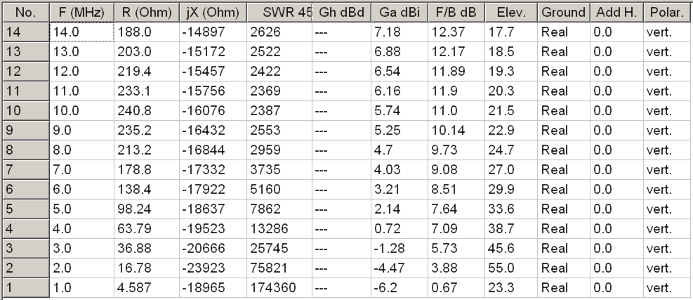

Dear Phil, pse look again at the last antenna modeling table: it seems to me impossible such an incredible variation caused by just two m. of added length!

Regarding the last table of results I posted that you have asked me to check, the significant difference would likely be feeding it from the bottom directly against ground as per your test. That latest 'guesswork' model was with the feed arrangement at the top of the vertical, all my other figures and models were with the feed point at the grounded end of the vertical.
Trying to guess the layout of your earth wire and the 2m extra horizontal piece wouldn't help, but then I'm also not sure of your wire layout at the far termination end.

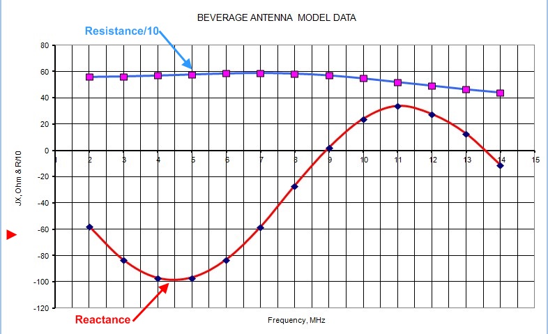

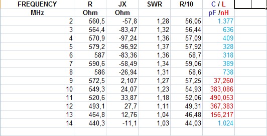

Dear Phil,
I enclose the data / graph resulting from your modelling table of Sat. June 30. I am still working on the noise improvement data, but wish to have a second confirmation and this I can have only when there is excess noise on air.
Kind regards,
Gianfranco
Kind regards,
Gianfranco
- Beverage 2-14 Graph.jpg (94.55 KiB) Viewed 35996 times
- Beverage 2-14 Data.jpg (48.16 KiB) Viewed 35999 times

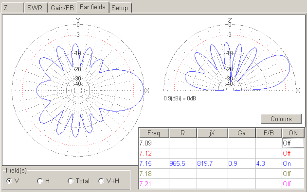

Dear Gianfranco, so sorry I missed your message, I don't log in unless I wish to post and so it remained invisible, please accept my apologies for that.
Your chart above is an interesting view of the data, well done. Great to hear that signals are good too, despite what are at the moment very poor band conditions globally.
Of the two models built so far, the first tables came from the Beverage as illustrated on page 3 with the feed point at the bottom of the vertical wire at the earth point. The last table was based on the top fed arrangement with the extra two wires as per the pic below.
You can see my approximation of what I thought looked like the arrangement of the wires into your house, the bold black wire is 2m long, the feed point is the red dot.

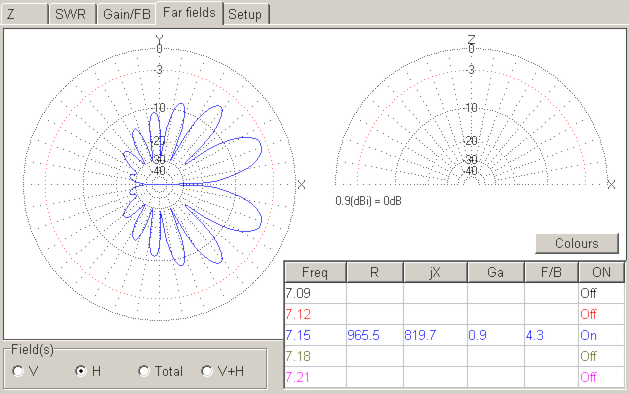

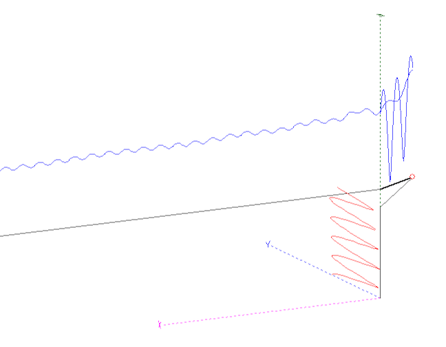

Just for fun here is a closeup of the (red) current distribution on 144.1MHz. That frequency makes the current characteristics more obvious and I have zoomed them so they are exaggerated.
The following two pics give an insight into the vertical v's horizontal components of the 40m radiation pattern of the second model: Horizontal: So we need to decide on what antenna configuration needs to be modelled next before putting any reliance on the data, and correct errors in regards to the feed wire arrangement and the termination at the other end.
Hoping that helps!!
Best regards, Phil
Hoping that helps!!
Best regards, Phil

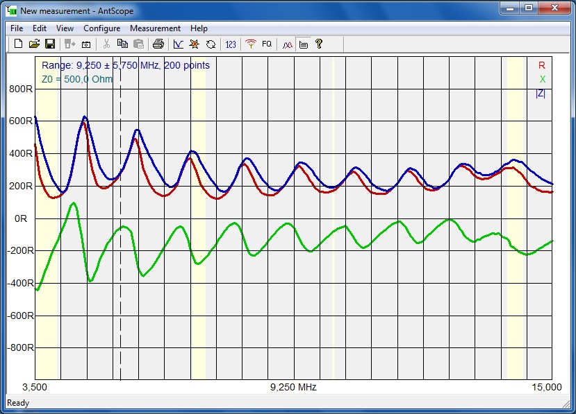

The "PERFECT" wideband antenna??
Dear Phil,

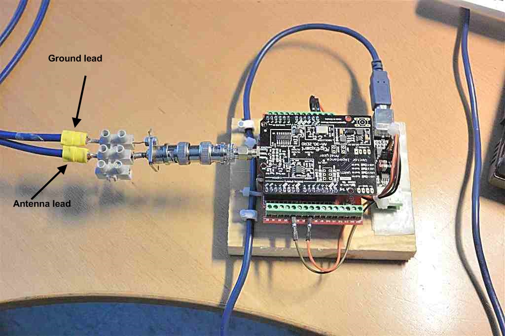

Yesterday I received a brand new Rig Expert's AA-30.ZERO Vector Impedance Anayser. It took 24 hours to make it work, because of a small problem on the PC board, but now it works. Enclosed is the Z = R + JX plot obtained by connecting the antenna leads on my desk to the analyser, range 3.6 - 15 MHz. Unfortunately I had disconnected the antenna termination resistor, to check back directivity, so this is a plot of a "wide open" bidirectional antenna: it really look like a travelling wave. Tomorrow I shall re-connect the termination.
The Real part oscillates between 600 and 200 Ohm. Reactance is always capacitive and fairly constant with frequency. More testing, study and thought necessary....
Kind regards,
Gianfranco
Dear Phil,
Kind regards,
Gianfranco
- The Vector Analyzer in operation
- The AA-30.ZERO.JPG (144.41 KiB) Viewed 35903 times
- First 3.5 - 15 MHz R + JX plot
- First Beverage R+JX plot.jpg (113.53 KiB) Viewed 35911 times
