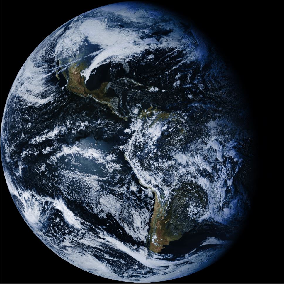

Post by RSP2user » Mon Nov 12, 2018 12:00 am
USA-Satcom has just released v2.1.0.0 of the XRIT Decoder. Along with enhancements for the XRIT Decoder, a new RSP Streamer X has been released and is operable with the RSP1A, RSP2, and RSPduo - new features include operation with two streams simultaneously (provided that the PC being used has sufficient processing power and an RSPduo or more than one compatible RSP are being used). Also new is the XRIT File manager which allows for improved operation with both LRIT and HRIT files, improved LUT for excellent false color images, user-selectable automated black filling of the white background on full disk visual and false color HRIT images, and country as well as state map overlays.
The new color enhancements are excellent:
GOES 16 Earth Full Disk LR.JPG (92.35 KiB) Viewed 65757 times

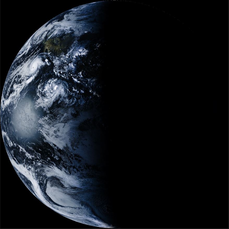

Post by RSP2user » Sat Nov 17, 2018 7:45 pm

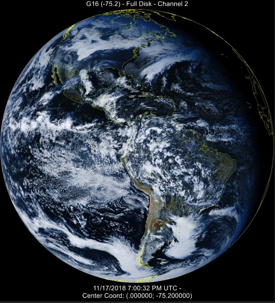

Now that GOES 17 is transmitting images, you can get an even better view. (Note: GOES 17 is not yet in full service at this time.) The HRIT images from both GOES 16 and GOES 17 provide a nice view of the Earth via the SDRplay RSP2 (or RSP1A or RSPduo), NOAA GOES Satellites, NooElec SAWbird GOES LNA (5v 30mA version), and USA-Satcom XRIT software. Very nice Earth images.
GOES 16 Full Disk 11-17-2018.JPG (181.05 KiB) Viewed 65453 times
GOES 17 Full Disk 11-17-2018.JPG (219.66 KiB) Viewed 65453 times

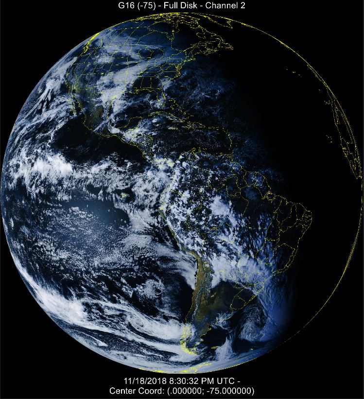

The new country and state boundary feature of the USA-Satcom GOES XRIT File Manager allows determining where weather phenomena are occurring by state more easily.
GOES 16 Full Disk Image With New State and Country Overlay 11-18-2018.JPG (158.44 KiB) Viewed 65397 times

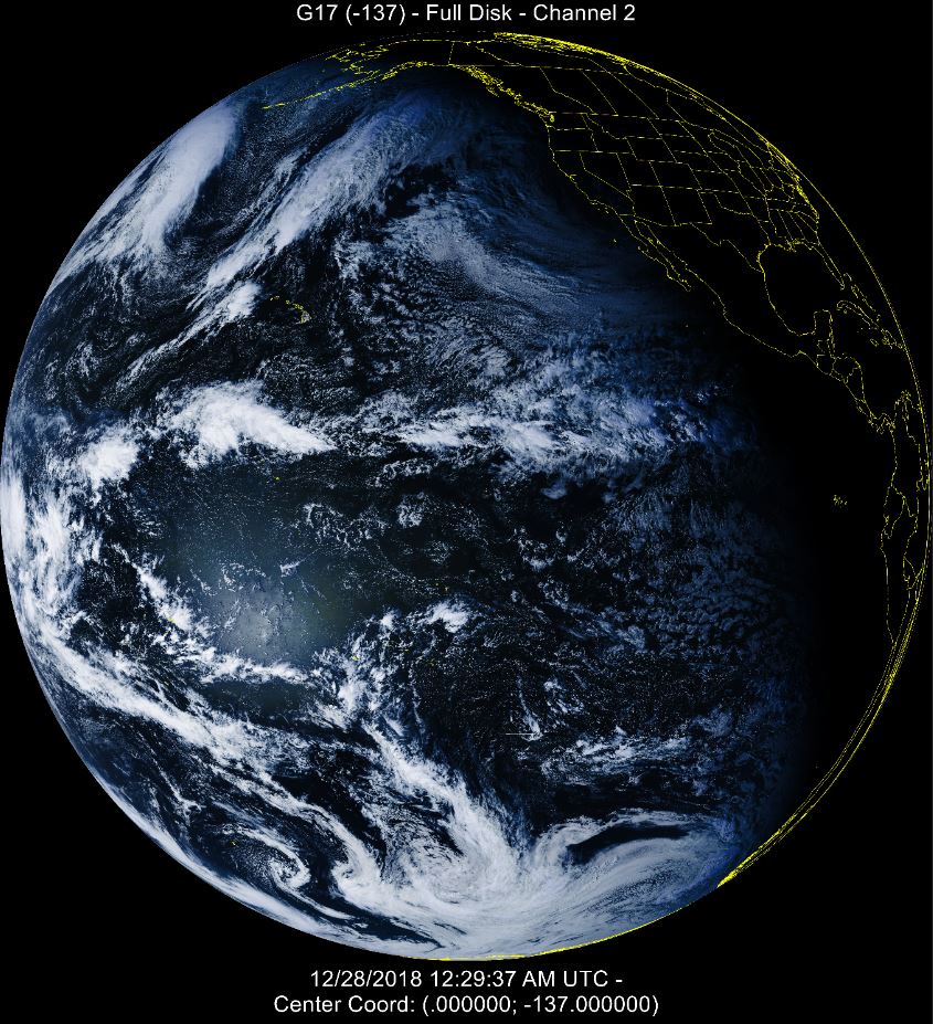

Post by RSP2user » Fri Dec 28, 2018 6:06 pm

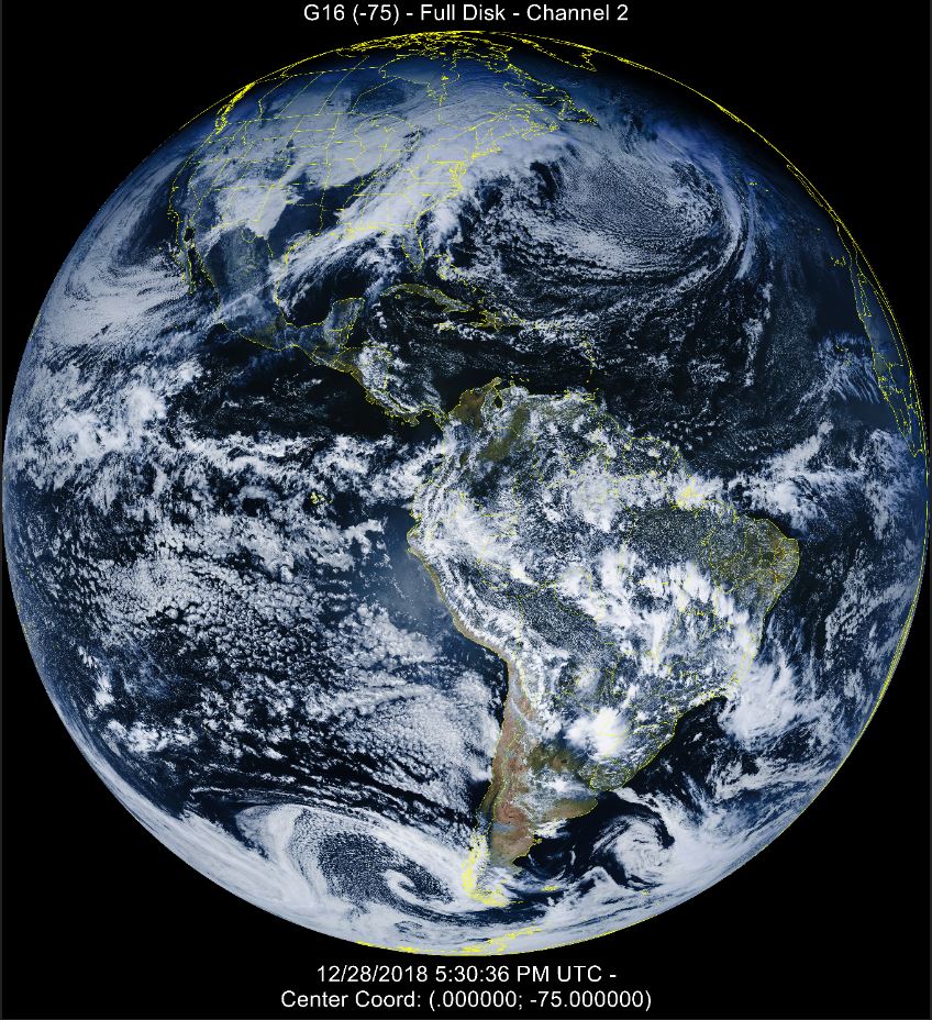

USA-Satcom has continued improvement efforts on RSP Streamer X, the XRIT Demodulator, XRIT Ingestor, and now added an XRIT File Manager. New features include mapping overlays, improved file management, and improved automated false color capabilities. The software is operable with GOES 15, GOES 16, and GOES 17 satellites in the United States. Contact USA-Satcom for operability with other satellites. GOES 17 is not officially in full service yet.
G16 - 28DEC2018.JPG (242.16 KiB) Viewed 64353 times
G17 - 28DEC2018.JPG (196.73 KiB) Viewed 64353 times

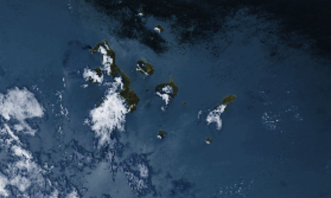

The improved image clarity reduces image artifacts at the Earth-space boundary of the image and improves the overall aesthetics of the colorization of the full disk images. The images are quite amazing. The resolution is far better than what can be shown here due to image size limitations for this site. Below is a full disk GOES 16 image from February 17, 2019 and a corresponding zoomed in portion to get an idea of the resolution and clarity (the actual full disk images are approximately 40MB PNG images each which are much greater resolution than the below image):

Zoom-In on Galapagos Islands:
Zoom-In on Galapagos Islands.JPG (61.66 KiB) Viewed 63038 times

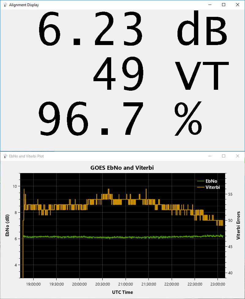

The antenna Align Mode is a great new feature that allows users to view the Signal Quality, Viterbi FEC, and Eb/No from a distance using large numeric values. This mode enables users to better view these values when fine tuning adjustments to GOES receiving antennas. The Eb/No and Viterbi graphing enables users to see how well their receiving system is doing throughout the day (e.g., over temperature and while the sun is in alignment with the receiving path). Here is an example of each:
Align Mode and EbNo and Viterbi Graphing.JPG (102.17 KiB) Viewed 63038 times

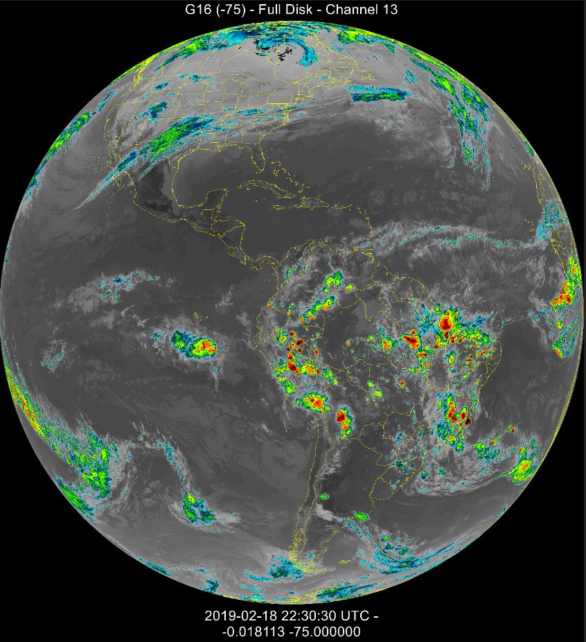

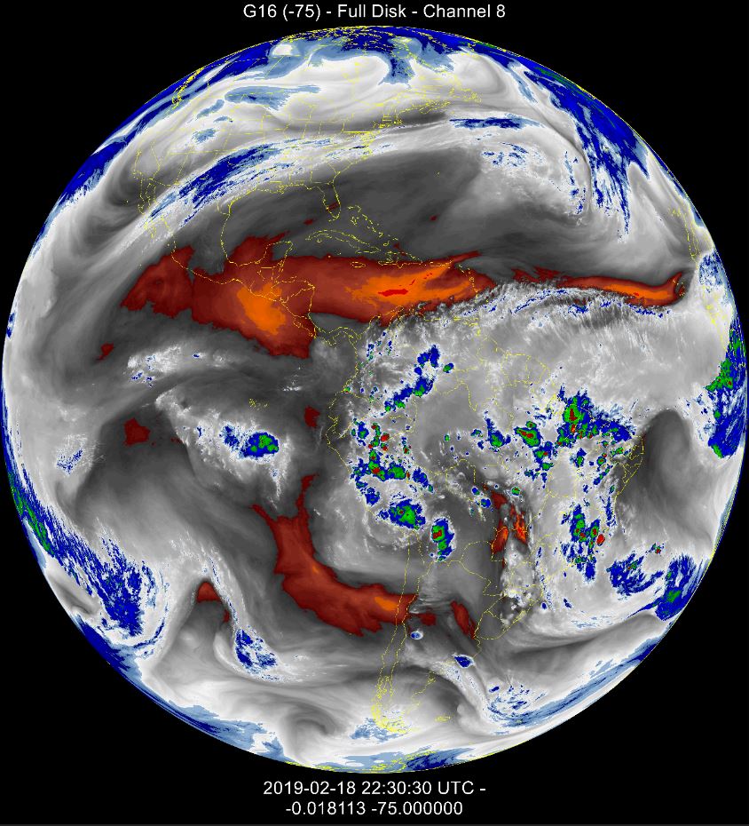

Post by RSP2user » Mon Feb 18, 2019 11:42 pm
More updates from USA-Satcom to the XRIT Decoder software with a new patch from today. The XRIT file manager now provides IR image enhancements for GOES Bands 8 and 13. Here are some examples:
Band 13:
G16 CH13 Enhancements 02-18-2019.JPG (163.38 KiB) Viewed 62975 times
Band 8:
G16 Band8 Enhancements 02-18-2019.JPG (169.21 KiB) Viewed 62975 times

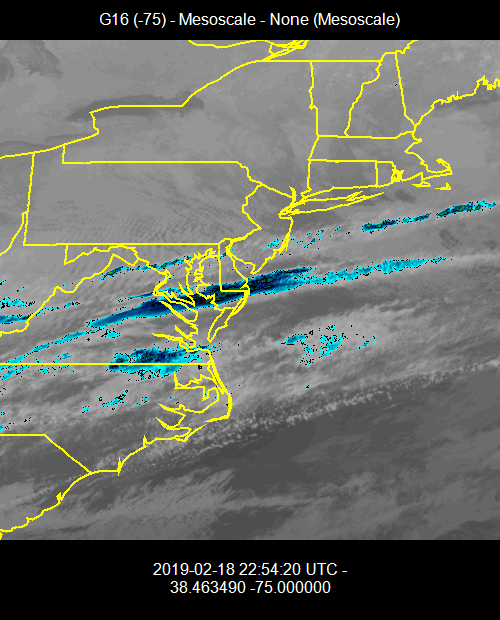

The IR enhancements are also available for mesoscale images:
