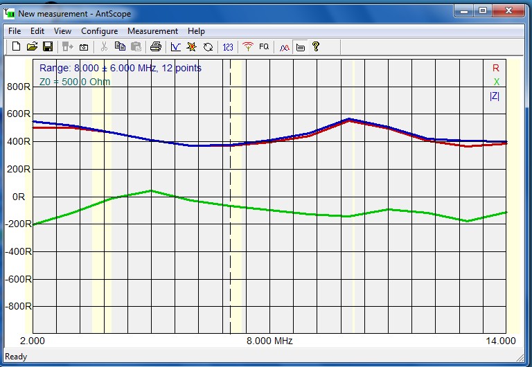

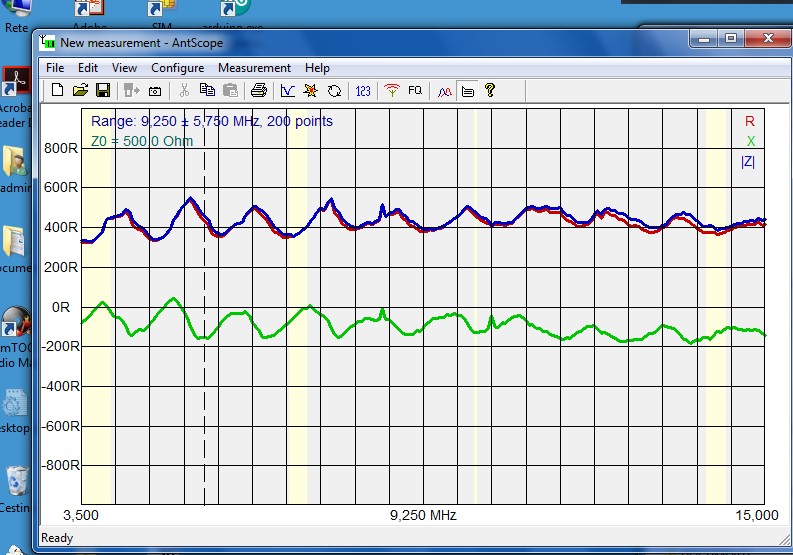

Today I took readings of the Beverage iust at the starting point, no lead-ins and did the scans both in the unterminated and the terminated condition. Comparing with yesterdays' results today's graphs are a real eye opener. I also downloaded the CS files and will work on the data in Excel not only to get useful quantitative results, but also to compare actual data with your model data. No leads and proper termination really put order and cleanliness in the picture! There is a lot to do.
Have a great sunday!
Gianfranco
Eart Con. = 0.8 m / antenna drop to Anayzer: 5.5m- No termination at far side.
Short conn. unterminated 08.07.18.jpg (112.98 KiB) Viewed 40142 times
Eart Con. = 0.8 m / antenna drop to Anayzer: 5.5m- 560 Ohm termination at far side.
Short conn. terminated 08.08.18.jpg (103.46 KiB) Viewed 40142 times

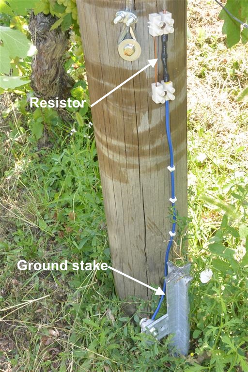

Antenna termination: 560 Ohm (10 resistors 5.6 KOhm in parallel). Termination is shown in Figure 1.

Figure 1 - Far end 560 Ohm termination

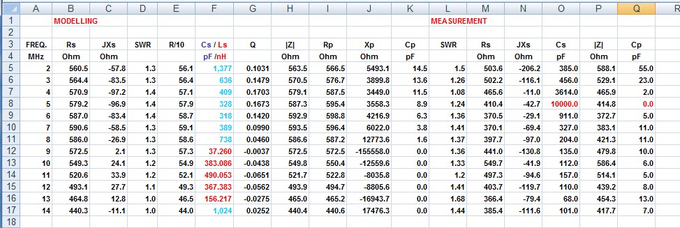

Table 2 - Modelled & measured data
Table 2.jpg (123.31 KiB) Viewed 40100 times
Figure 2 - Measured plot - Earth conn. 0,7 m to analiser - Ant. conn. drop 5m to analyser.
Compare 2-12.jpg (88.25 KiB) Viewed 40100 times

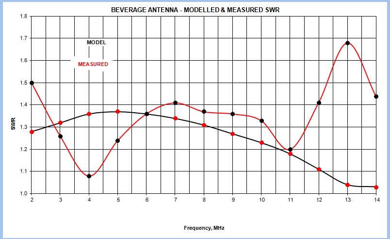

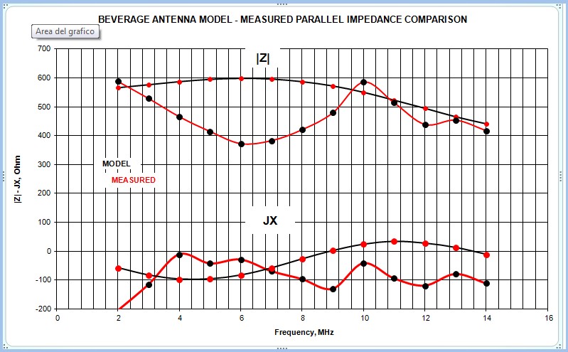

COMPARISON BETWEEN CALCULATED AND MEASURED DATA
In order to be able to compare modelled and measured data, I had to reduce the resolution of the Vector Analyser to just 12 points, so frequencies 2 to 14 MHz could be paired in both sets of data. With this resolution all measured parameter oscillations in between each MHz gap become invisible (look at Figure 2, previous post). Looking at Table 2, previous post, one can see that parameters, |Z| and Cp had to be computed from Rs and Xs originally available in both sets.
Looking at Figure 3, there is a fair correlation in antenna impedance |Z| and also in reactive part Xs. The surprising result is that actual impedance between 2.5 and 9.5 MHz is lower than modelled, while it was expected to be higher, due to the fact that the average antenna height, at 6 m. is significantly more than commonly used (see previous posts). Because of this result, I shall attempt to lower the termination resistance to 470 Ohm. In any case the Beverage antenna offers a very nearly resistive impedance over a very wide band: in fact Rs, Rp and |Z| coincide over all the frequency range considered.
There is also a fair correlation in SWR, as shown in Figure 4, not bad considering we are covering a frequency range of almost 3 octaves. However SWR was and is expected to improve with increasing frequency, as the ratio wavelength to antenna length becomes more favorable. This unexpected phenomenon will have to be investigated.
In Figure 5 we look at the equivalent parallel capacitance seen from the receiver. As expected parallel equivalent capacitance is significantly low at an average value of 15 pF, thereby "eating" very little received signal. This also explains the quite noticeable difference when the antenna terminal is pulled indoors thru the window: parallel capacitance goes up and the received signal goes down.

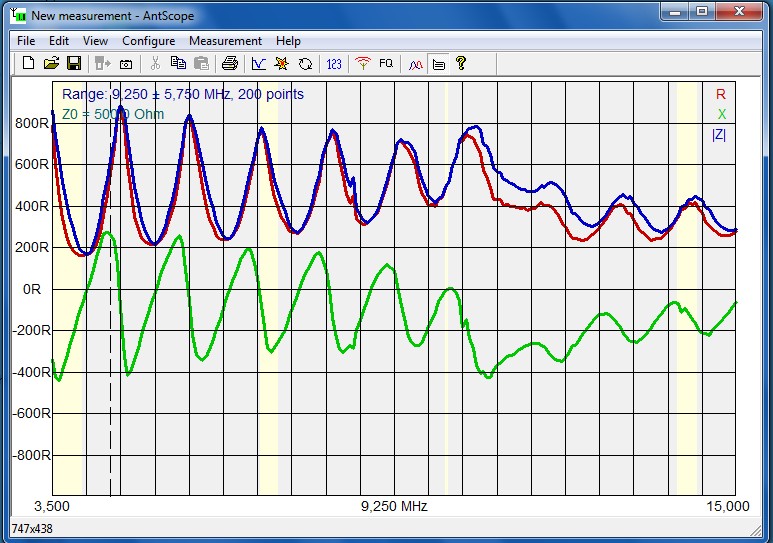

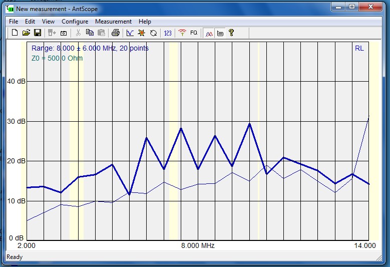

For completeness here is Figure 6 showing antenna return loss 2 to 14 MHz, thick line. Thin line is return loss with the Material 43 toroid transformer in between. The antenna exhibits series capacitive reactance across most of the frequency range and it is easily tuned with a series coil: this would only be useful if one wished to use the antenna for transmission.
Using the triple purchase tensioner it is possible to change the average height of the antenna wire. Changing height from 6 to 3 m, impedance unexpectedly increased from 370 to 420 Ohm. More research is in order.
Figure 6 - Return loss 2 to 14 MHz
2-14MHz Return loss.jpg (84.89 KiB) Viewed 40068 times

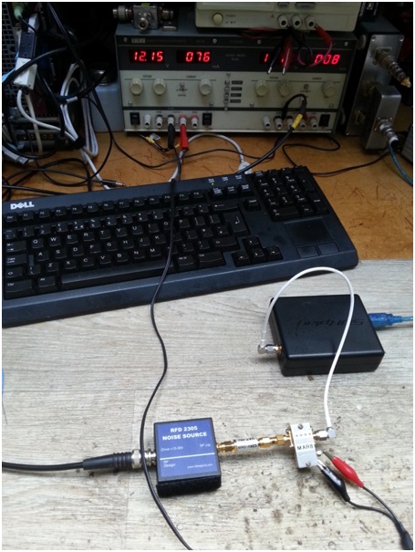

After buying one of the Chinese noise sources from EBay, I was quite disappointed with the measurements I obtained with it, I couldn’t get repeatable results, and as I couldn’t be certain of its flatness nor it’s ENR, I was never sure if my problem lay in the RSP or the noise source! I was also aware of the huge amount of noise that was coming from the source and left wondering if the combined noise power of it all may damage the RSP front end. I also noticed that the MMIC’s run incredibly hot from 12V. Within a few months all of the above became irrelevant when the output MMIC died the same as the original poster here ‘glovisol’.
I then purchased a noise source here in the UK from this company http://g8fek.com/index.html. They not only sell calibrated noise sources but also general purpose ones which are suitable for amateur use. I originally brought a noise source to do simple tests of receiver noise figures by using the application note supplied on their website here (g8fek.com/uploads/9/4/4/3/94435411/rfdesign_an_-1_intro_to_noise_sources.pdf). I used their BBGen which has a flat +-1.5db output from 100KHz to 5GHz (datasheet here http://g8fek.com/uploads/9/4/4/3/944354 ... 090211.pdf) which produced some repeatable results using an RMS voltmeter, but I've since moved on to using the RSP (I use an RSP1 now discontinued) with the AGC off to produce the two noise on noise off results for the y factor measurement. There is a good tool and information on this method of noise figure measurement on the pages of Owen Duffy here (https://www.owenduffy.net/software/nfm/index.htm), I use the NFM application with manual entry to do the calculations.
To sweep filters I have followed the BBGen with a wideband MMIC based homebrew amp to sweep cavities at 177MHz and also filters at 28MHz using the RSP as the detector with manual gain adjustment. The same company sells a range of wideband amplifiers BBAxx (http://g8fek.com/lna.html) which have predicted gain and flatness, I have brought their BBA1 as the amplifier following my noise source to get a higher output level to enable me to add a return loss bridge between the output of the source and the antenna port of the RSP, that way you can look at the RL of ‘devices’ that you put on the unknown port of the bridge.
I have just noticed that they now sell an "RXGen" which has a +/-0.5db accuracy from 2MHz to 2,4GHz. Somewhat better than my original BBGen!
I have been to a few rallies and talked with the designer of these products, we even tested the RSP against a calibrated noise source at the Newark Hamfest last year, and all the numbers stacked up.

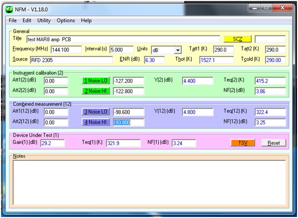

I eventually brought an RFD2305 calibrated source so that I could make meaningful measurements. For this post, I did a quick and dirty measurement using the RSP1 and the NFM app to show the gain and NF of a simple MAR8 MMIC amp in a milled box (Images at end of Post)
As you can see, the results are pretty good, the image below was taken from The MAR8 datasheet:-(Images at end of Post)
You just have to bear in mind that we are not talking about several thousand pound systems here; we are talking about low cost tools that will comfortably give you some meaningful and reproducible results within the ‘Amateur’ budget. As long as you keep the RSP device in its linear range, and make sure that you don’t overload the front end by adding too much amplification, the results that I have obtained have always stacked up with professional test kit within a db or so.
