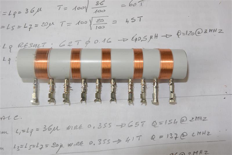

Filter practical construction - the multi-coil technique

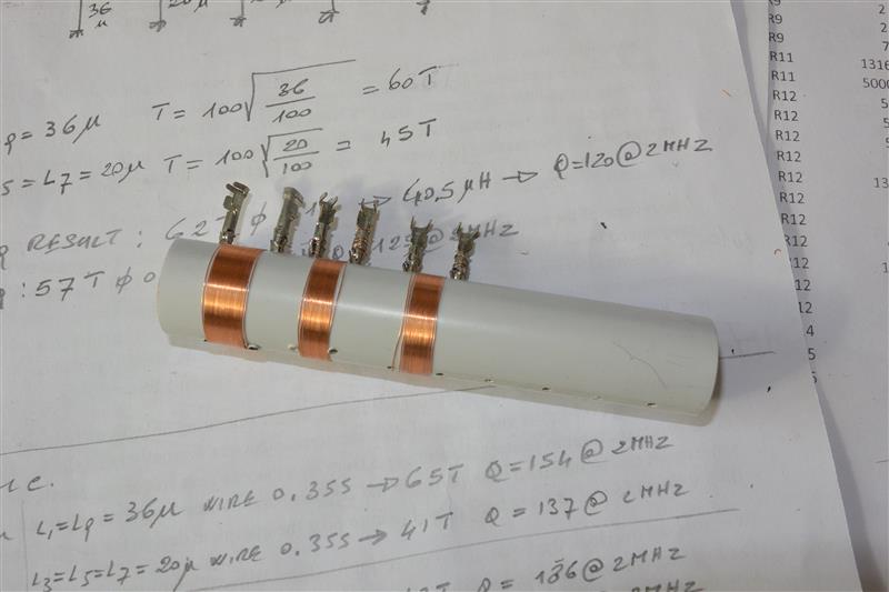

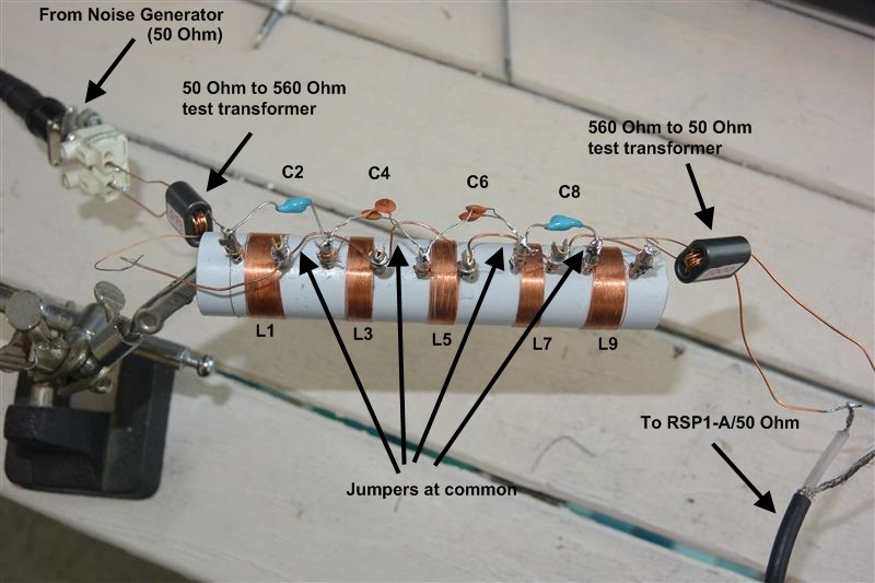

As previusly stated, the main problem with the filter's construction was that the size of the coils developed in the prototype (#7) were too big to fit the entire filter in the die cast utility box. As nothing is really new, a technique I had seen in German surplus equipment of WW-2 came to my mind. You wind all coils on a single dielectric tube with a significant reduction is size and much easier winding of the enamelled copper wire. This is the multi-coil technique. I used a 20 mm dia. PVC electrical conduit pipe, made a drawing of the in-line positions of the 5 coils and drilled 10 holes of 2 mm diameter. The holes hold pins that are forced in and are the coil terminals.
To construct the filter, you push the first pin in, solder the coil beginning, then you wind the first coil. At the end of the winding you push another pin in and solder the end of the first coil and so on. Figures 1 and 2 give a better idea than one thousand words. The beauty of this is that, once you know the number of turns, you wind the entire filter in less than half an hour. As we have seen already, coil Q's are in the order of 150/200, so no problem with filter performance.
With this type of assembly all wiring is done on the tube itself: each coil beginning is connected to the next beginning wth bare copper wire while every coil end joins the next coil end trough a capacitor: this becomes very clear looking at the schematic (look at #7, several posts ago, to have an idea).

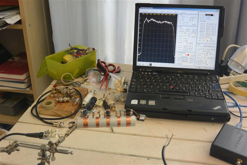

Another advantage of this technique is that, by replacing the wire jumpers with capacitors you have a truly balanced filter, equisymmetrical to ground. Figure 3 shows the complete filter being tested with Noise Generator/RSP1-A - RSP SAS Spectrum Analyser. Once you see that the filter is working, e.g. you did not make mistakes with coil turns, you glue the coils in place with cyanoacrylate liquid.

Figure 1. Coils L1, L3 and L5 in place
Figure 2. All coils, L1, L3, L5, L7 & L9 in place
Figure 3. Filter mounted and under test, note the binocular impedance transformer at each side for 50 Ohm matching

Hi glovisol, thanks for your reply in the other thread on noise gen. In figure 1 I see many holes below in the tube but pins are above. You use these holes for what?
Posts: 662
Location: Piedmont, Italy
Re: HIGH PASS FILTER FOR OPTIMUM HF RECEPTION
Post by glovisol » Mon Feb 18, 2019 9:19 am
Hi Sdrom33,
The holes below were made before I had a definite idea on how to proceed with the preparation of the tube. They are not necessary at all and serve no purpose.

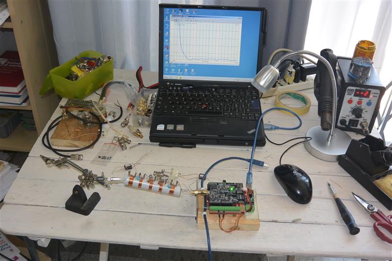

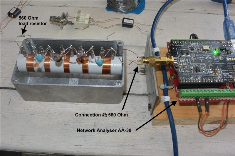

With the proposed filter construction it is possible to completely assemble and test the filter out of the shielding box, as shown below. Bandstop and bandpass testing is done at 50 Ohm level, using the Noise Generator (50 Ohm) connected to the filter's input via a 50 to 560 Ohm wideband transformer and the RSP-1A ( 50 Ohm) driven by the RSP-SAS software and connected via a 560 to 50 Ohm transformer. The return loss /SWR measurements are done at the 560 Ohm to 560 Ohm level because the AA-30 Network Analyser can accept any impedance. So the generator is the AA-30 with an output adapter made with a double SMA male and a PC board female connected to the filter's input and the load is a simple 560 Ohm resistor. These setups are shown in the Figures 4 & 5 below.

Figure 4. Testing with Noise generator/Spectrum Analyser
Filter testing 1.JPG (122.75 KiB) Viewed 104253 times
Figure 5. Testing with Network Analyser
Filter testing 2.JPG (152.87 KiB) Viewed 104253 times

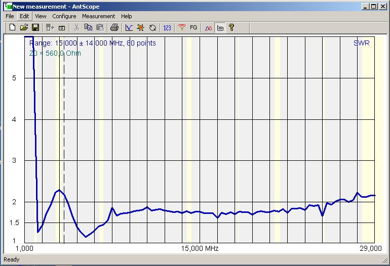

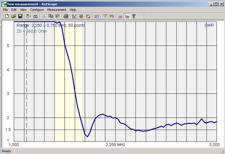

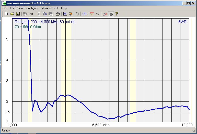

Figure 6. SWR 1 to 29 MHz. NOTE: this test is 560 to 560 Ohm & no WB transformer to 1 KOhm
HP HI Z 1.5K-29K.jpg (104.58 KiB) Viewed 104253 times

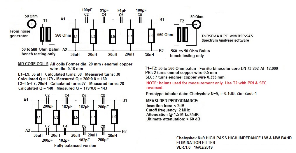

Filter schematic and data
This high impedance filter is more critical than the 50 Ohm unit as far as components are concerned. Coil winding must be done very carefully to ensure the exact number of turns specified. Coil inductance measurement helps, if the facility is available. The same holds for capacitors and exact values can be selected from a batch of several. This is easy for the 100 pF standard value. For the 91 pF value use a parallel of selected 39+33+22 pF.
Chebyshev N=9 HI PASS FILTER DATA #10.jpg (163.43 KiB) Viewed 104216 times

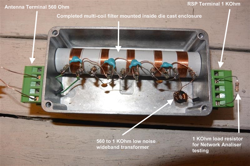

Completed filter

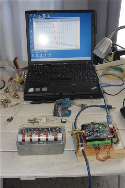

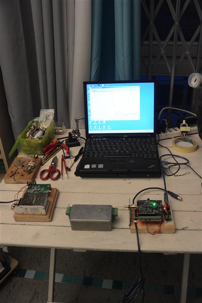

Below pictures of completed multi-coil filter mounted into the die cast aluminium enclosure and one test screen showing bandstop/bandpass transition with lid closed. All tests to be uploaded in next posts done with the built-in 560 to 1000 Ohm wideband low noise toroid transformer, e.g. the filter as shown is ready to be connected between a long wire antenna and the HI Z input of the RSP receiver.
More in the following posts.

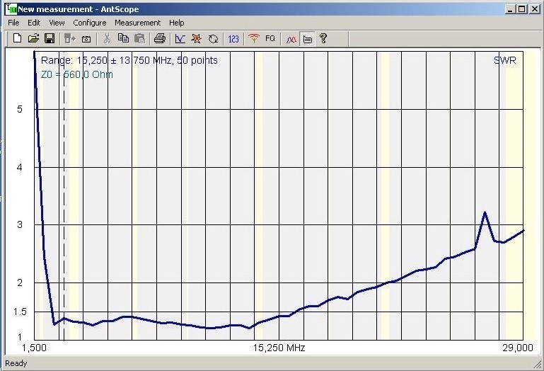

More SWR plots
7. HP 1-10 M.jpg (62.86 KiB) Viewed 104174 times
8. HP 1-29 M.jpg (65.84 KiB) Viewed 104174 times

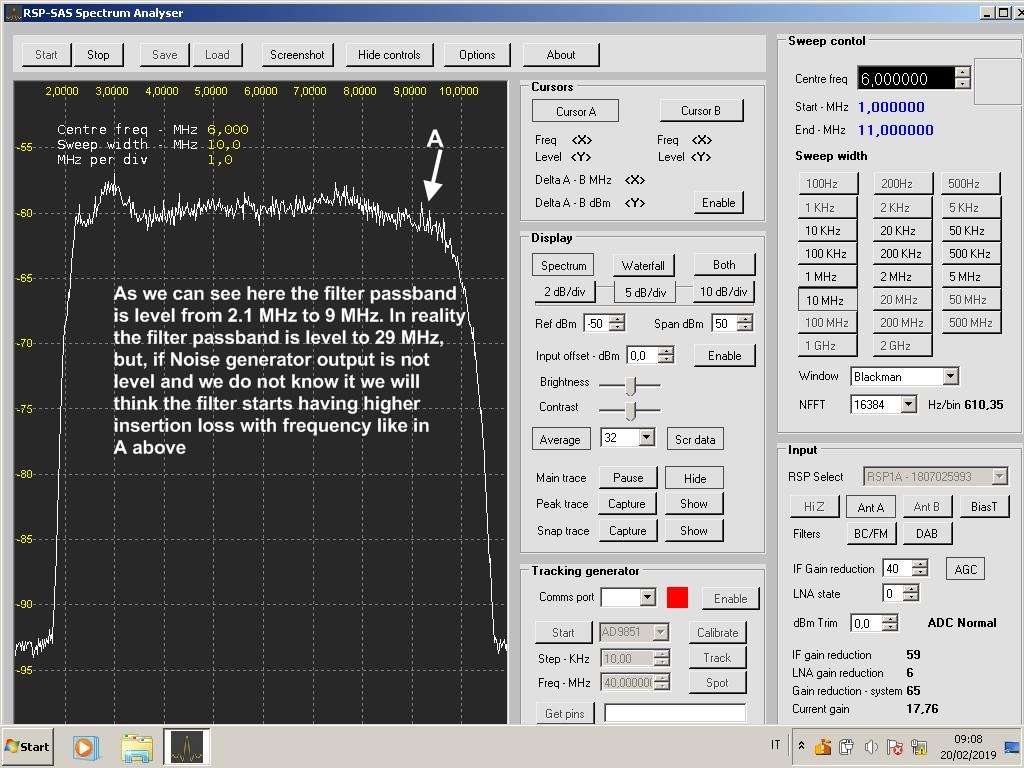

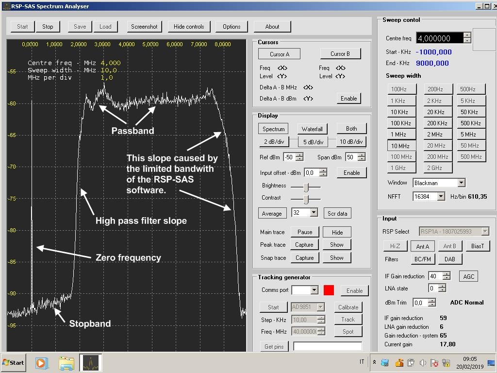

Amplitude/attenuation testing and discussion on the Noise Generator levelling shortcomings.
In the following screens we can see the amplitude performance of the completed High Pass filter and the explanation of the effect of the levelling imprecision of the Noise Generator, as mentioned in the relevant thread: "A close look at low cost Noise Generators".
