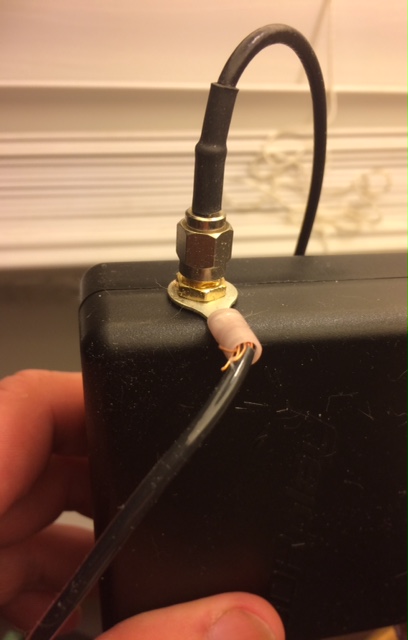

Post by NN4F » Fri Nov 04, 2016 3:09 pm
Grounding your RSP will make a big difference to....I did it via the SMA connector with a simple lug
Paul Jones - NN4F, Charleston SC
