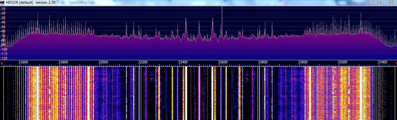

Possible bug?
under HDSDR & SDR# when I hit load defaults with the radio running, I get a mirror image around the LO frequency, when I stop and start it goes back to a normal display? see attached image...
Paul
Paul
- defaultsscreen.JPG (162.65 KiB) Viewed 42843 times

Re: EXTIO V2.1 Well done!
Hi all!NN4F wrote:Possible bug?
... I get a mirror image around the LO frequency, when I stop and start it goes back to a normal display? ...
I get the same problem ("mirror spectrum") (in my case it seems to be independ from [LOAD DEFAULT]).
Unfortunately sometimes you need some time to realize you are in that situation.
Usually I stop and restart sdr# to get rid of this.
Anything at 2 MS/s or above is the 'real sample rate' anything below that is effectively achieved by decimation (sample rate conversion), but the ADCs still run at 2MS/s and this data is passed across the USB interface.
We are investigating the issue first brought up by NN4F, but it appears to be a bug.
