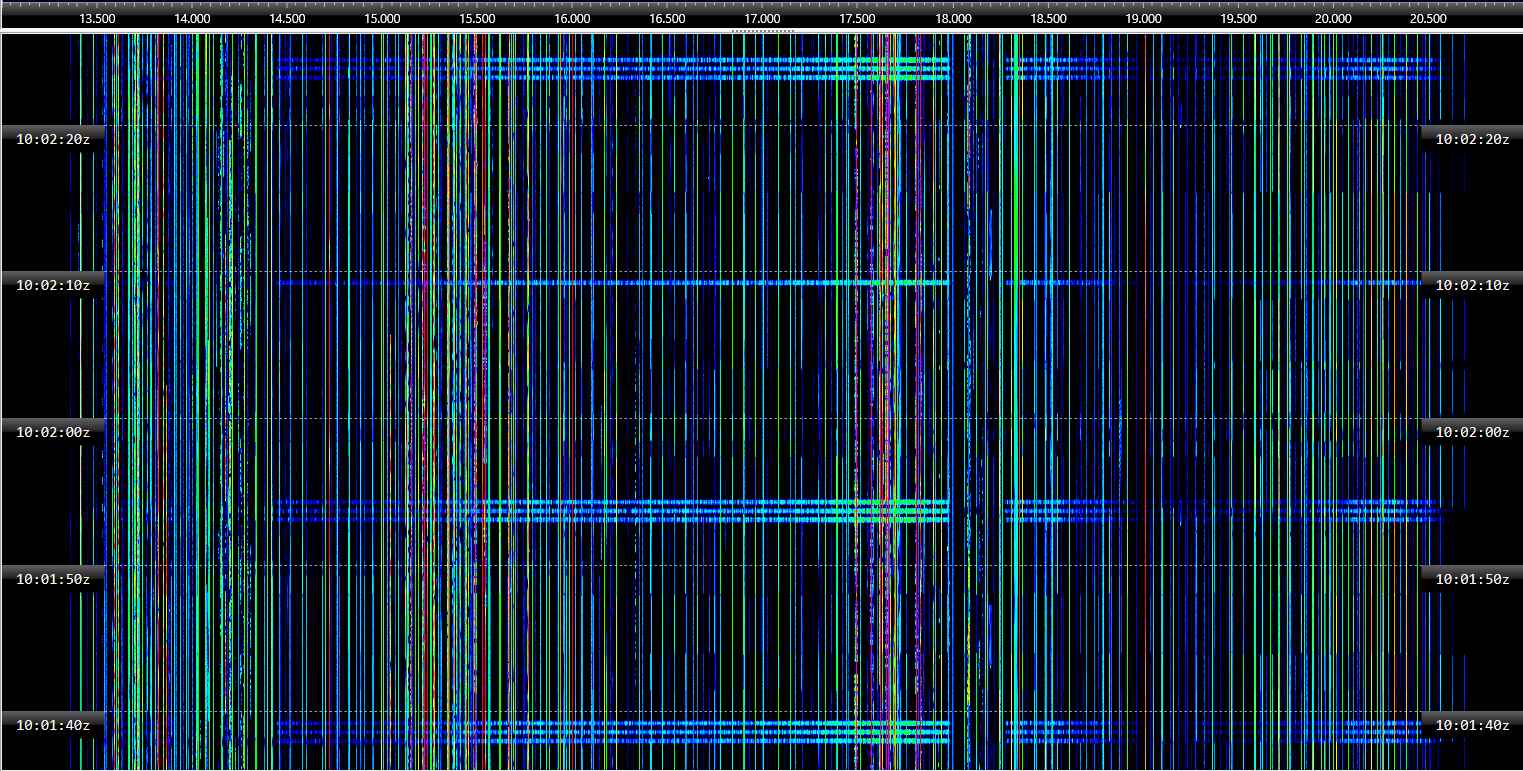

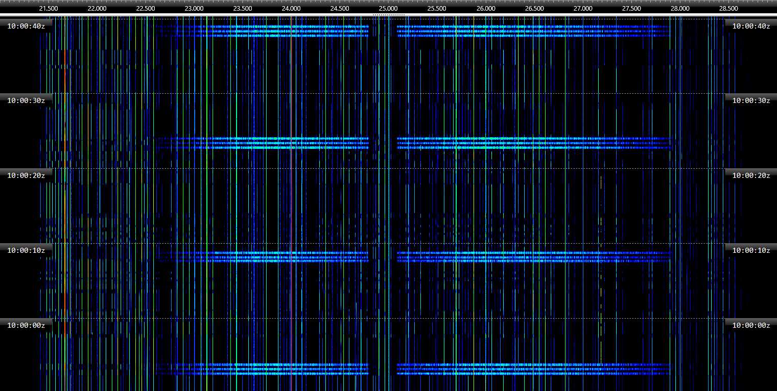

Approximately every 15 seconds, I get 3 (occasionally 1 or 2) short bursts of interference over most of the range 10 MHz - 30 MHz. (qrm1.jpg & qrm2 jpg). Looked at in more detail, the interference seems to have some kind of sub-carrier structure with a spacing of about 780 Hz (qrm3.jpg). There are small frequency ranges where the interference disappears: 13.9-14.45, 18.0-18.25, 20.9-21.55 and 24.8-25.1 MHz.
Anyone know what this is (& whether I'm likely to be able to do anything about it?!)

Interestingly the gaps in the frequency correspond to amateur radio bands plus a small guard band either side. - so someone is avoiding upsetting the amateur radio community

This is a typical pattern of "Homeplug Powerline" (PLC/PLT) modems. They are used in millions of European households (and elsewhere, but Europe is the leader) and transport network data (mainly internet via WLAN extenders) through the mains lines in the house. According to the latest European standards they are allowed to work with broadband signal levels up to 105 dBµV.
They are fully legal and produce interferences between 1.6 and 78 MHz within a radius of up to 400 metres and more. When they were allowed in Europe one of the argument of the lawmakers was: "Nobody needs shortwave radios any more. You can hear every radio station on the internet nowadays." Objections of several national spectrum authorities (and even the NATO!) were neglected. The lobbyists of the manufacturers were stronger.
After heavy protest of amateur radio clubs the producers agreed to notch the ham bands from the spectrum. But the latest PLC modems have such high levels that they produce intermodulation in the semiconductors of the households where they are used (power supplies, Monitors, TV ...) that partly the ham bands also are filled up with noise.
I myself am a victim of several(!) such PLC modems in the neighbourhood appr. 40 metres away from my antennas. I called the local (German) spectrum authorities several times for assistance, but they said the noise levels are absolutely within European limits. That means: Noise of up to S9+20 dB all over the shortwaves. DX-ing outside the ham bands is practically impossible. All totally legal.

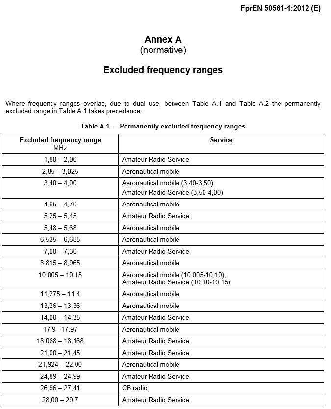

Here I post an excerpt of the current "static" notches vaild for such modems. If you have a similar noise pattern you can identify PLC modems from their noise gaps.
Note: The older standard did not notch all these frequencies, e. g. the CB band is not notched. Your neighbours can still have legally allowed older modems (legal signal levels on the mains line up to 65 dBµV) which do not notch all these frequencies.

I think what you see there on the screenshots (thanks for them, nice examples I may refer to in future discussions!) is an idling PLC modem. In other words, it could get more nasty if there's actually data being transferred.jpsa wrote:Oh, thank you. That makes sense: we've had a new neighbour move in recently. Looks as if I'll just have to put up with it.
