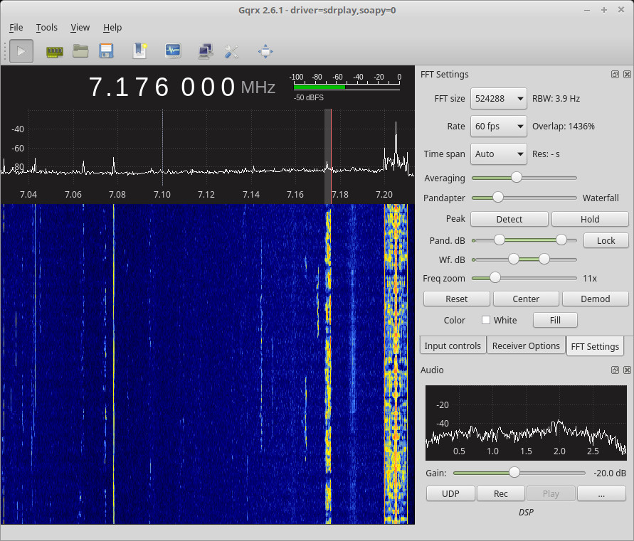

If all goes well gqrx should be available in Mint-Menu - All and you can right click on its entry to put a launcher on the desktop (or panel...). It should run and it works with a .raw I/Q stream recorded with gqrx and my RSP2 on my other partition.

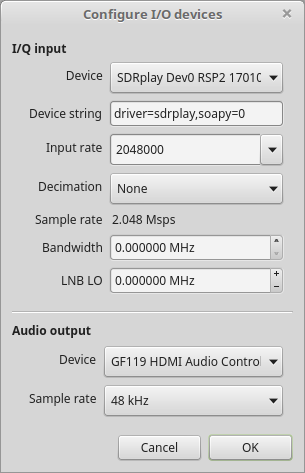

Try double clicking your new (resizeable) desktop Gqrx icon and you should find your RSP2 in the list of available devices. It works, for me, with the default 'Device string' which is 'driver=sdrplay,soapy=0' as below.
It also works with just 'sdrplay'.
