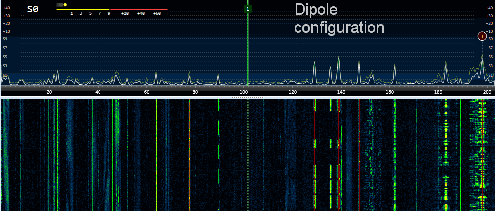

Glad you get reception "down there" now. :) However, while a miniwhip-style antenna gives surprisingly good results even "down there", a simple wire loop will beat it on many occasions.
Here's a comparison of VLF and NDB reception with a dipole vs. a loop of the same wire length. Actually it's the very same antenna, which is a rather odd contraption I made (by accident) specifically for the RSP, meant to give both good SNR, good wideband capabilities and some built-in attenuation to keep the RSP overloading in check. It's basically a 2x10m dipole with a deliberately not matching balun (the infamous NooElec 9:1 balun) used on both sides of the coax. Putting that thing at the very same spot (in some trees in my case) into a delta (or whatever kind of) loop configuration by simply connecting the wire ends is fundamentally changing its properties of course, to the benefit of low frequency reception.
Here are some animated GIFs to demonstrate:
This shows the impact of the configuration on VLF reception. As you can see, the difference is quite noticeable, spurious signals tend to disappear and actual on-frequency signals get a much better SNR. You can clearly see (and hear of course) the 60 and 77kHz time signals, that were much in the noise before in the dipole configuration.
Here's the NDB band:
The difference is obviously even more pronounced here. The NDB band more or less doesn't exist in the dipole configuration, in the loop configuration I get some additional muck but also a lot of NDBs. Here's what the band typically looks like then:
As you can see, there's quite a lot of them to see clearly, and a lot more of them to pick up in much noise using narrow CW filters and a lot of patience (since they're often fading in and out slowly, interfering with others on a nearby frequency and so on). To my own surprise, I found hunting NDBs a fun challenge, at least for a few days and I'll most likely do it again!
Here's a typical log of 3 days of NDB hunting, they're from all over Europe:
