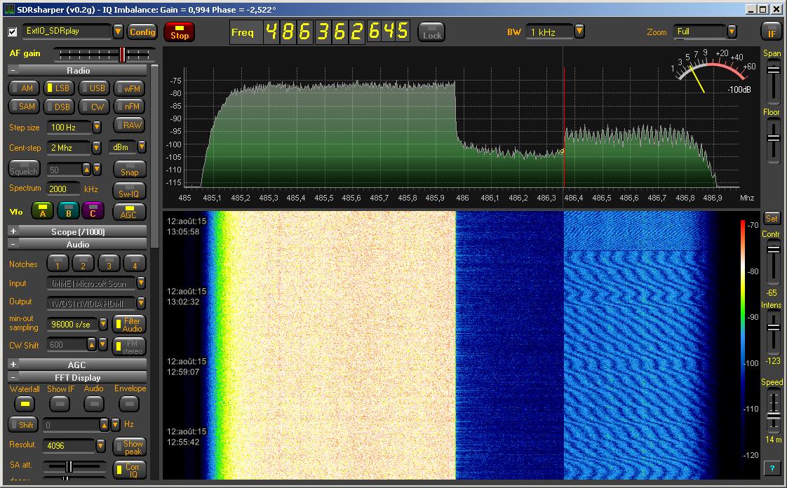

g1hbe wrote: There's not a lot to see with digital TV, just 'blocks' of what looks like noise.
That is not true :)
If the top of the noise is not flat it indicates either a badly oriented aerial with echoes or SFN or MFN interference.
Here you see the difference between channel 22 correctly received and the 23 where two SFN TX are interfering
There was a sudden frequency drift between the 2 transmitters as can be seen in the waterfall.
You can also see the +166KHz offset of french TV transmitters.
The snake like display in the waterfall is typical of interference from 2 TX .
For echoes the lines are straight.
