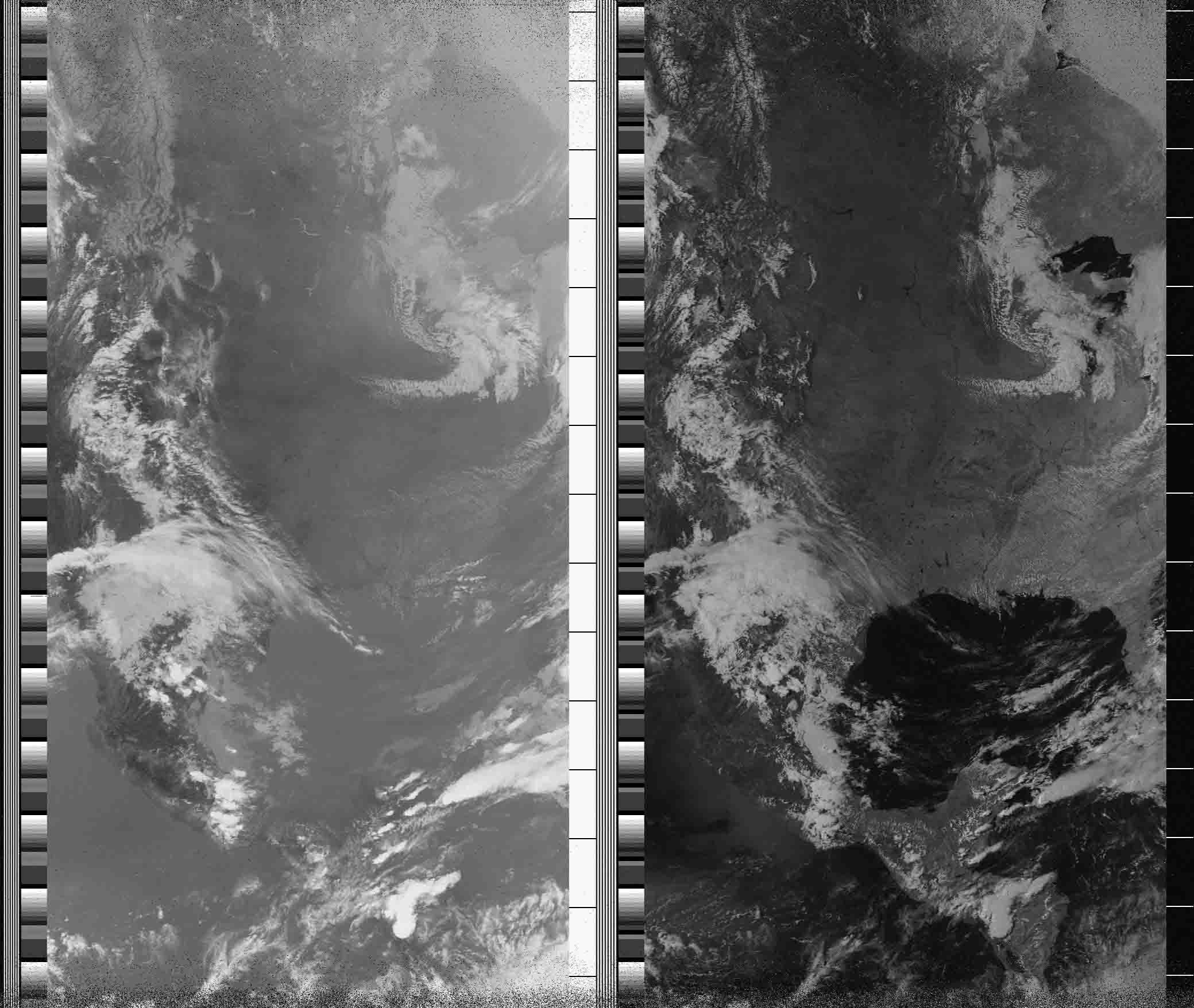

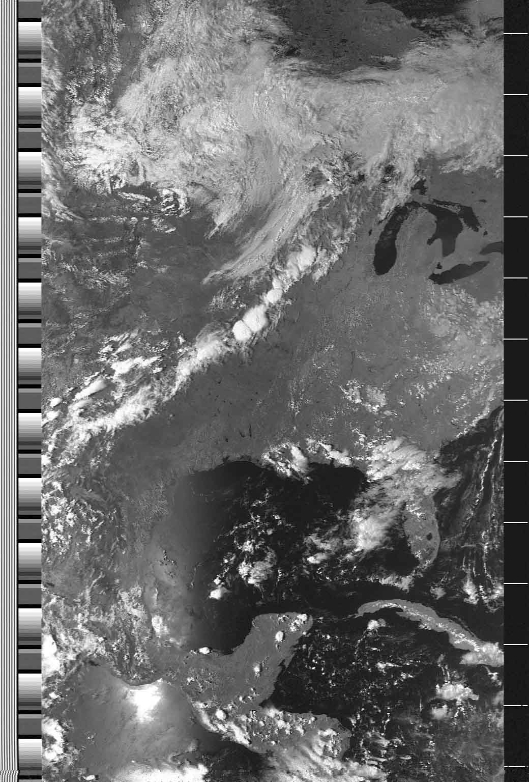

APT weather satellite image reception is very straight forward and easy to do from almost anywhere on Earth. Currently, as of 2017, there are still a handful of orbital weather satellites transmitting the APT or Automatic Picture Transmission format. As a minimum, you will need an antenna, a radio receiver capable of receiving FM frequencies from 137.1 to 137.9125 MHz having a bandwidth of 30kHz to 50kHz, such as the RSP2, a personal computer with a reasonably fast microprocessor, and image decoding software. To gain a much better range for receiving images, an 18dB low noise preamplifier is required. Without the 18dB preamplifier, you can get good APT reception for about 40 to 60 degrees of an overhead satellite pass when applying the antenna below and the RSP2. With the preamplifier, you can potentially receive images within a few degrees of horizon-to-horizon. With the configuration described below using a backfire quadrifilar helix antenna and applying an 18dB 0.6dB noise figure or better low noise preamplifier mounted at the antenna, you can use the RSP2 to obtain some very nice APT weather satellite images, such as those shown in the following examples:
NOAA 19 64E Chan A.jpg (153.32 KiB) Viewed 81870 times
NOAA 19 59W.jpg (157.98 KiB) Viewed 81870 times

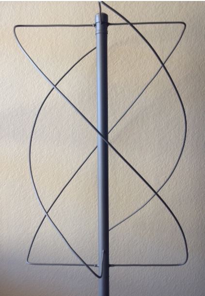

A very effective antenna for receiving the right hand circular polarized APT signal from orbital weather satellites is the backfire quadrifilar helix.
QFH Antenna.JPG (38.77 KiB) Viewed 81870 times

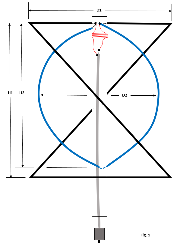

Read the following information carefully and be clear on the construction, before starting. First review the antenna images and figures below to get a good idea of how to form the antenna. Your exact construction of the antenna will depend on tools and materials that you have available. The antenna elements are made from the continuous piece of 6 awg copper wire by bending it at the required bend points to form the elements. You will need to use a permanent marker to first mark where the bends in the wire will be. Do not start bending the 6 awg wire yet, just mark it. You will need to cut notches in the top of the long acrylic tube and drill all of the holes needed to form the antenna and balun. Review the corresponding sections below. You will then need to cut two 0.25 inch (0.625 cm) lengths of the 0.625 inch (1.5875 cm) diameter tube to form thick acrylic washers. These thick acrylic washers will be used to support the 6 awg copper wire at the top of the tube.
QFH Dimensions.png (60.52 KiB) Viewed 81871 times
Fig. 1 Dimensions:
Large Loop (Black)
D1 = 15.11 inches (38.38 cm)
H1 = 21.92 inches (55.67 cm)
Length of Vertically Wound Section of Half Large Loop = 32.31 inches (82.07 cm)
Perimeter of Entire Large Loop = 94.85 inches (240.92 cm)
Small Loop (Blue)
D2 = 14.16 inches (35.86 cm)
H2 = 20.53 inches (52.14 cm)
Length of Vertically Wound Section of Half Small Loop = 30.26 inches (76.87 cm)
Perimeter of Entire Small Loop = 88.84 inches (225.67 cm)

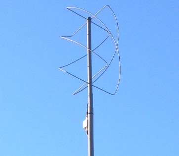

QFH Antenna Side View.JPG (46.36 KiB) Viewed 81871 times

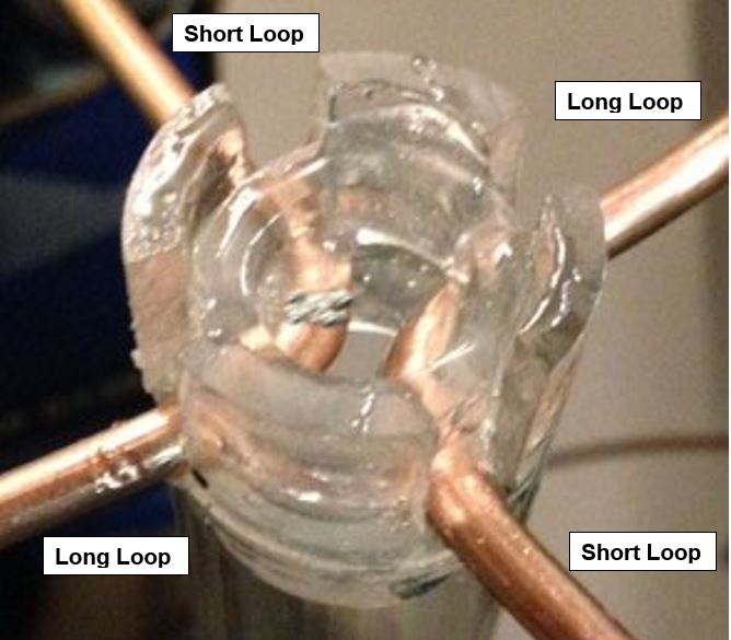

QFH Loop Connection Top.JPG (55.48 KiB) Viewed 81871 times
Drill the required holes and cut 4 notches into the long acrylic tube as shown (it helps to drill 4 holes; one at the bottom of each notch and then use a coping saw to cut down to each side of each hole). Make the holes for the 6 awg wire in the acrylic long tube just large enough to snugly fit the 6 awg wire through. With industrial glue, glue one acrylic washer inside the long tube so that its top edge is in line with the bottom of the 4 notches. The 6 awg copper wire will rest on this and be glued in place to it later. Let the glue for the washer dry overnight. Next form the balun using the 18 awg magnet wire. Drill 1/16 inch diameter holes to feed the 18 awg magnet wire through. The balun will be located at the top of the tube, just under the acrylic washer. Make the top two wires of the balun long enough to extend out of the top of the tube where they can be attached to the 6 awg wire later without melting the acrylic tube. At the bottom of the balun, you will need to drill a larger hole on each side so that you can temporarily pull the bottom wires of the balun through and the wires from the coaxial cable through and solder them. Once these are soldered, you will cover them with heat shrink tubing and carefully push them back to the inside of the acrylic tube. Fill these holes with 5-minute epoxy, once the soldering is completed. Glue the balun in place with 5-minute epoxy as a coating.

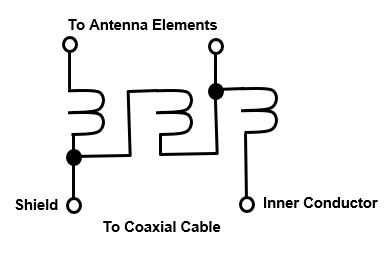

The balun is formed using 18 awg enamel coated copper magnet wire wrapped around the long acrylic 1 inch (2.54 cm) diameter tube, just under where the top of the copper elements are seated. Drill three pairs of vertically spaced holes placed 0.297 inch (7.5 mm) apart at 90 degree intervals around the tube. Each of the three inductor coils are to be wrapped counter-clockwise two turns when looking down from the top of the tube. With the two holes for the center coil facing you, start wrapping the first coil for the balun from the top left hole and evenly space the windings, ending in the bottom left hole. Next wrap the center coil, winding it from the top center hole going between the windings of the first coil so that no overlap occurs and ending in the bottom center hole. Now wrap the third and final coil starting at top right hole and wrapping it between the existing coil windings so that no overlap occurs and finish in the bottom right hole. Connect the top of the center coil to the bottom of the left coil (first coil). Connect the bottom of the center coil to the top of the right coil (third coil).
Balun Diagram.JPG (17.36 KiB) Viewed 81850 times

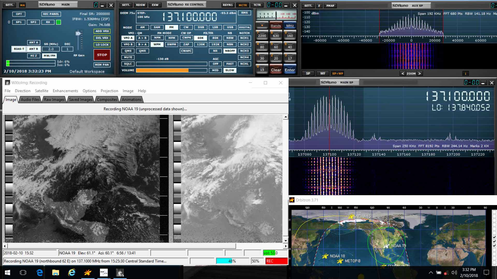

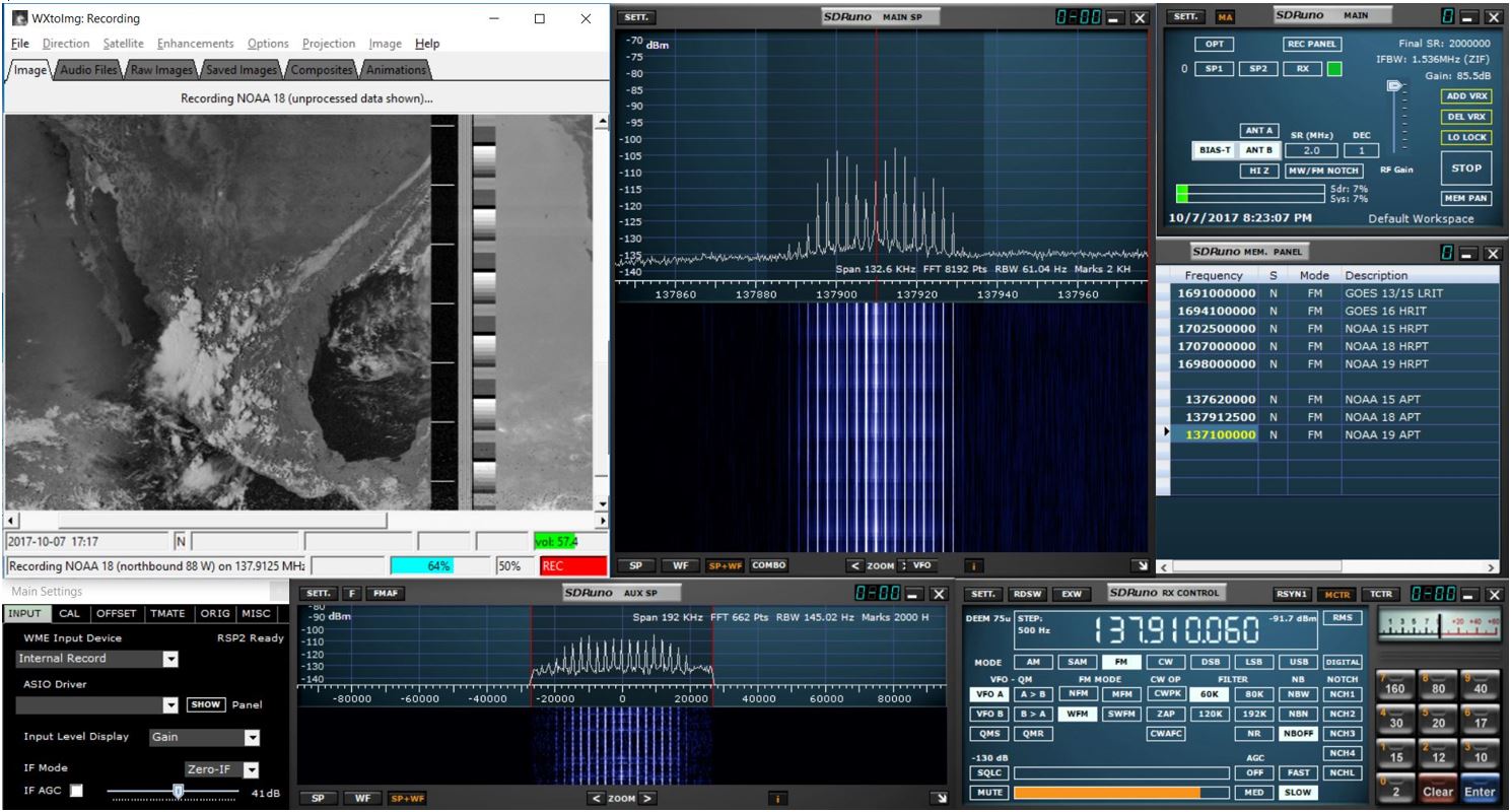

In your first few attempts at capturing APT images, do this manually so that you can get a feel for how WXtoIMG works. When you are ready to automate the frequency control, then go to the Options>Recording Options setting of WXtoIMG and set the receiver type to Kenwood. The RSP2 emulates the Kenwood commend set. Set up VSPE for a single serial port (Device Type: Connector) and map both WXtoIMG and SDRuno to that port, Note that the serial port must be in the range of 1 to 8 and not otherwise used by the personal computer or its peripherals in order to operate. Once the serial port has been set up through VSPE and is active, then start SDRuno and from the RX Console select SETT>CAT and set the COM Device. Set RX MODE CTRL. Set the baud rate on both WXtoIMG and the SDRuno CAT tab to 57600. Select ENABLE & CONNECT on the SDRuno CAT tab. On the next recording pass of an active satellite under WXtoIMG, the WXtoIMG software will now control the frequency setting of SDRuno. You can now set up to completely automate the capturing of orbital weather satellite images. If you do not have the professional version of WXtoIMG, you will not be able to set the receiver type to Kenwood and automate the image reception using WXtoIMG.
For optimized operation using SDRuno, set the Sample Rate to 2.0 MHz, DEC 1. Set the IF Mode to Zero-IF, Set Input Level Display to Gain. When applying an 18 dB preamplifier, set the RF gain to 84.5 and set the IF gain to 40dB (IF AGC is off). Ensure that the bandwidth is set to WFM 60 kHz and then under AUX SP, reduce the bandwidth slightly to 50 kHz. Make sure NR is not selected and that NBOFF is selected. Set AGC on the RX Control panel to SLOW. Refer to the image below. To obtain a clean view of the signal waveform in the Main SP window, select Main SP>SETT>FFT and set the value to 32.
WXtoIMG and RSP2 with SDRuno.JPG (219.64 KiB) Viewed 81850 times

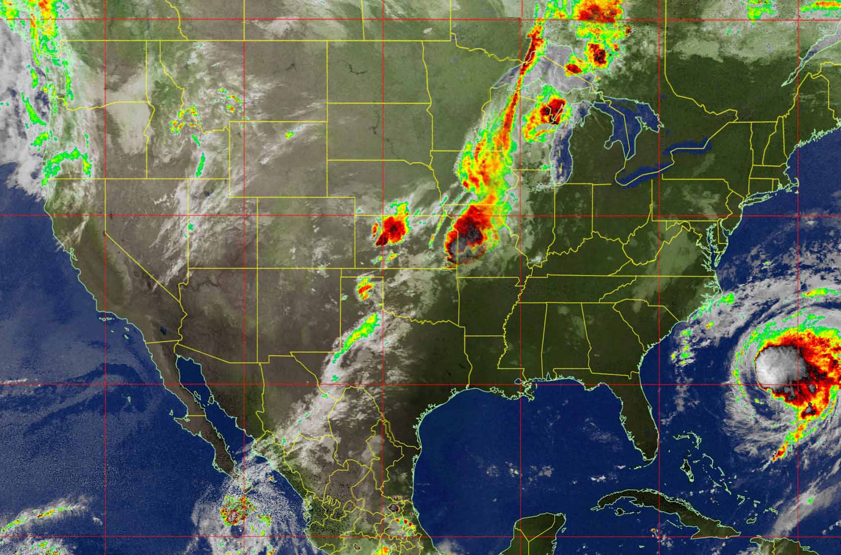

Below are additional images made using the setup described.
3 satellite pass composite image. In many instances, just two passes will cover the United States; however, a third pass was collected in order to obtain a better view of the hurricane just off the East coast.
NOAA 18 and 19 IR Compilation.jpg (211.12 KiB) Viewed 81476 times

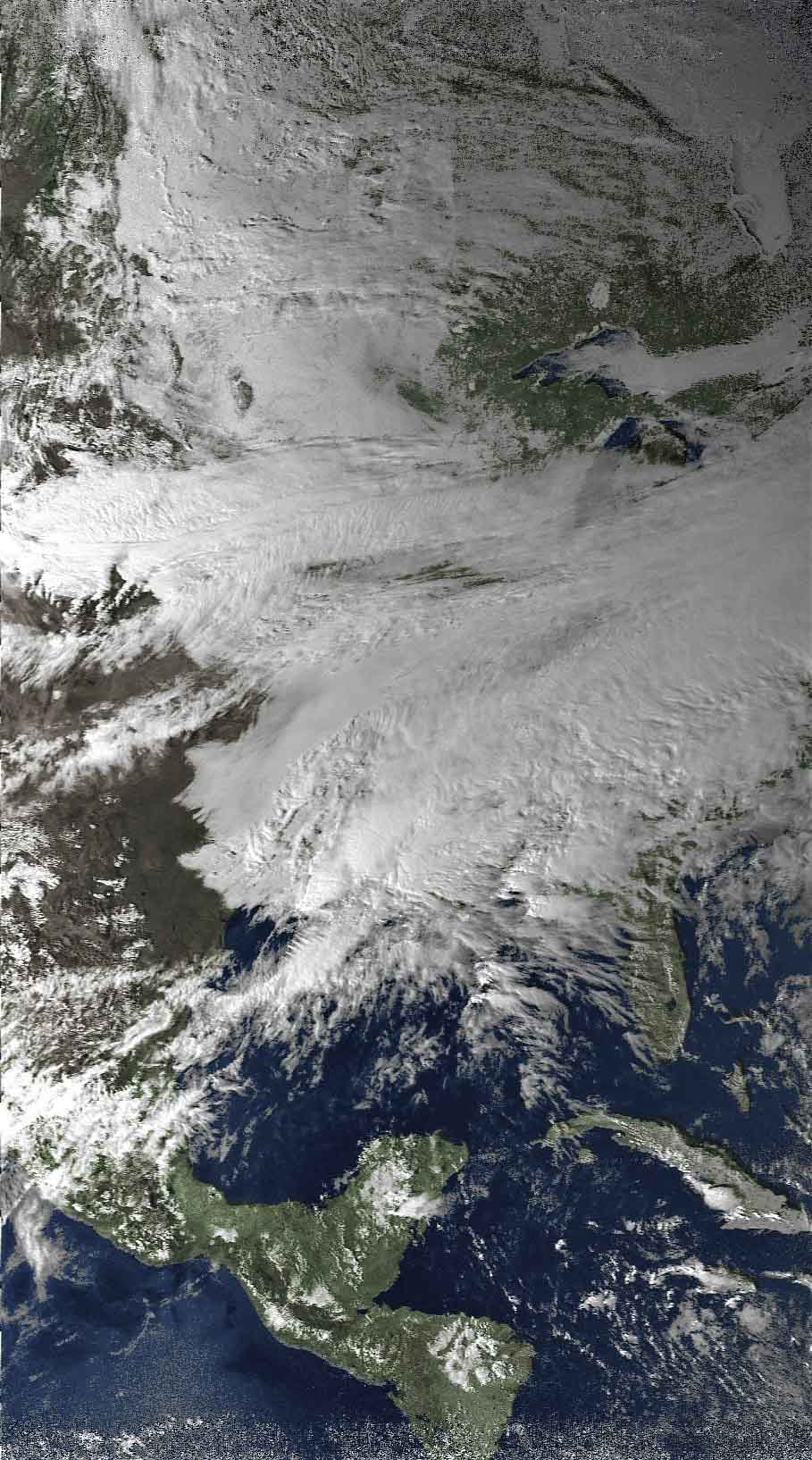

Near-overhead pass with maximum reception duration (note that the image stretches from just below the arctic circle to just above the equator).
NOAA 19 86E IR.jpg (245.23 KiB) Viewed 81476 times

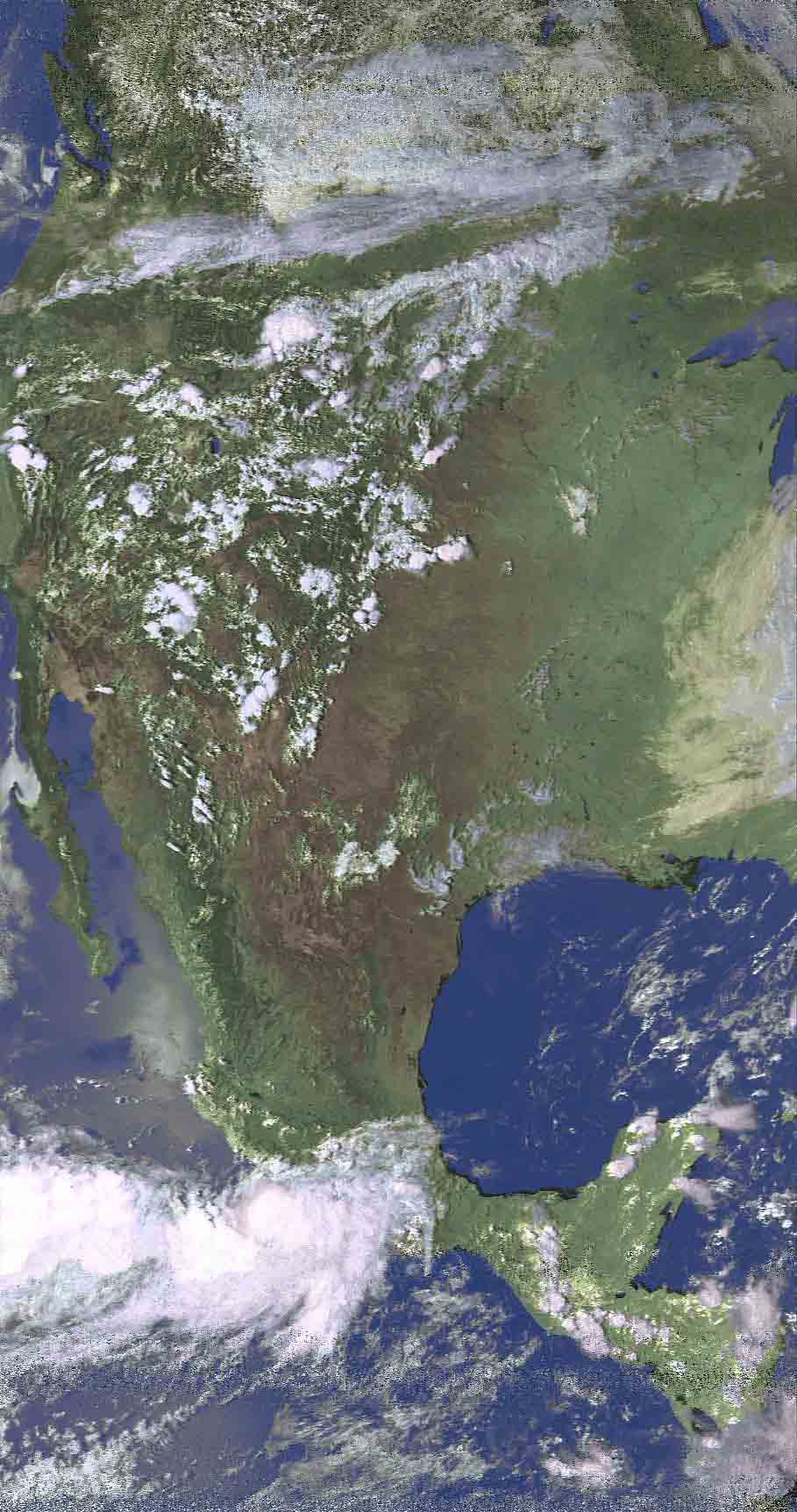

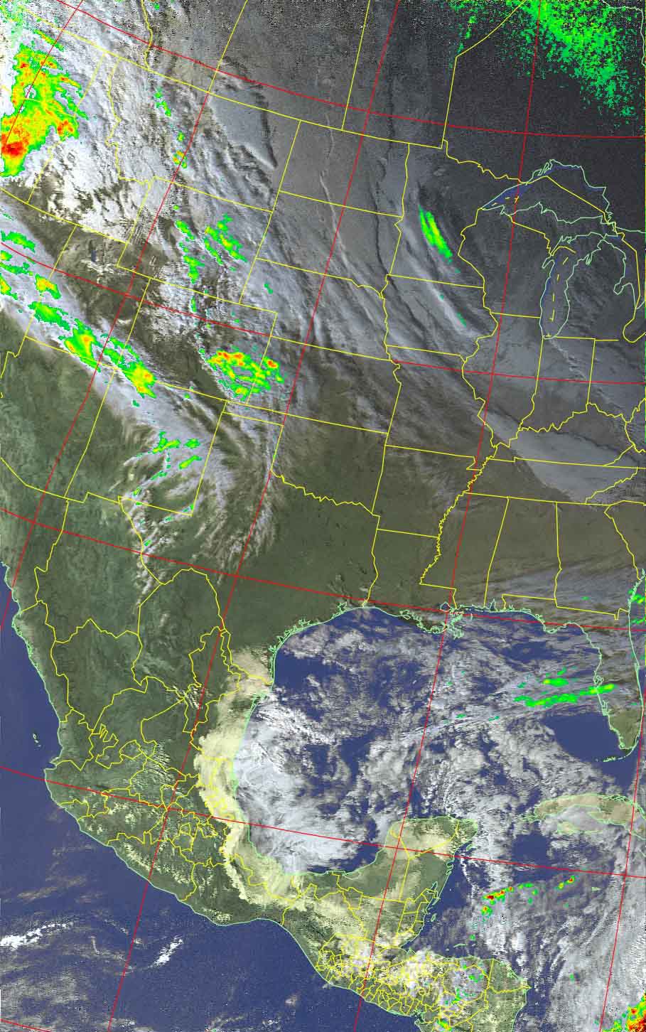

NOAA 19 201801052139 HVCT APT with Precip.jpg (182.15 KiB) Viewed 79438 times

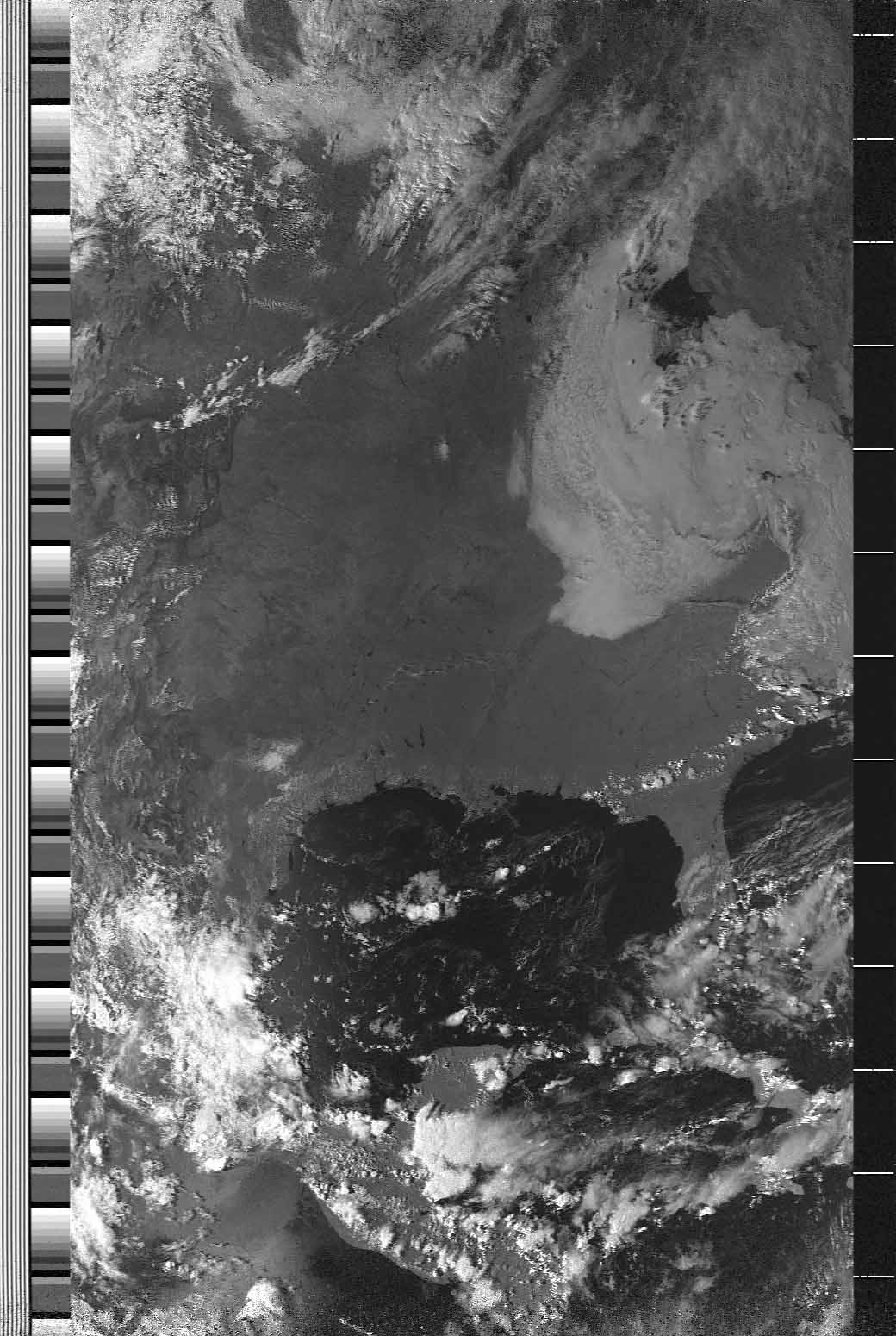

Post by RSP2user » Sat May 26, 2018 9:14 pm
Here are some updated APT images, The increased maximum range was due to monitoring and adjusting gain in SDRuno at the beginning and end of the pass.
201804272152 APT BW NOAA 19 LR.jpg (218.86 KiB) Viewed 76585 times
Here is another recent APT image:
201802102125 MSA 62E 2 N19 LR.jpg (210.68 KiB) Viewed 76585 times
Here is SDRuno in operation with WXtoImg:
NOAA19 pass SDRuno RSP2 LR.jpg (218.88 KiB) Viewed 76581 times
