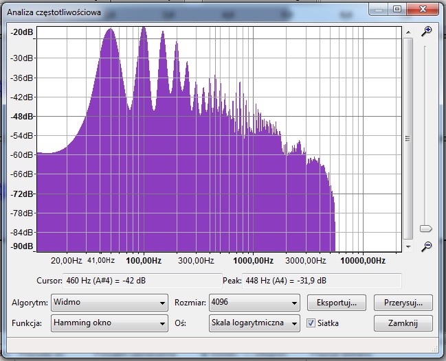

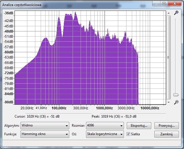

I did spectrum analysis for the first 5s (antenna_1)
and for the 15-20s (antenna_2)
If you look at antenna1 analysis it looks that this buzz is like 50Hz and its harmonics. Why?
Paul

There are often ground loops between the antenna ground and PC/audio amplifier ground. You seem to have a lot of 50 Hz and harmonics in both receivers. I think the SDR software for the RTL dongle has a highpass filter suppressing the 50 Hz part more than SDRUno. Or do you use the same SDR software for both?
A solution could be either an isolating RF transformer at the receiver coax input or an isolating audio transformer at the audio amplifier input (something often used in young people's car audio power amps). I use the latter. Without it I also have a lot of hum in my PC speakers. Even at normal sound playback when no receiver and antenna are involved.

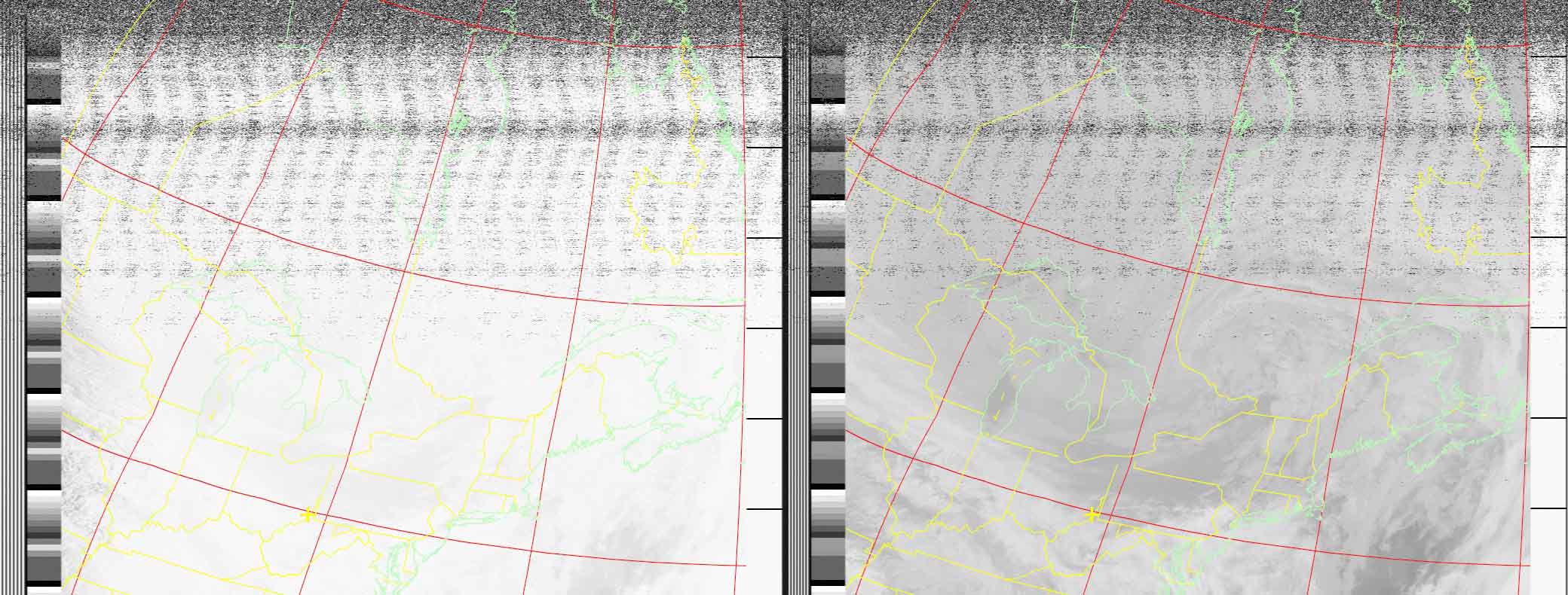

I've been plagued with this issue for years. Not sure where the noise originates but my guess is that it's power line related (corona discharge across insulators perhaps). It is not an everyday occurrence. It is more intense in wet weather and days with high humidity. It's a wideband noise that extends into the VHF region.
Here it is in the upper half of this partial 137MHZ satellite image:

Hi Mike, join the club. For the last few years I've had an intermittent rough buzz across LW, MW and HF and it is even audible on 70 MHz. I keep hoping that whatever it is will blow up or the owners will move away, but it just keeps on.
It's coming in via the antenna (Wellbrook loop) but it will only null down by a few dB so I suspect it is radiating from the local mains wiring.
