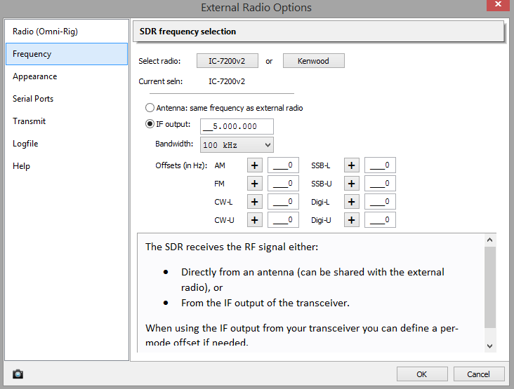

Did you mean "first stage IF output" . If so did you configure SDR Console for IF out as shown below? You can check the logfile as shown below to see if there are any errors. Make sure you are using latest version of SDR-Console which is Dec. 14 2017.K2PAA wrote:HI,

- IF Out.PNG (24.73 KiB) Viewed 8250 times
