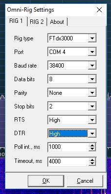

Have been running the setup for some time with SDRuno tied to OmniRig and the FTDX3000. With the latest 1.22 update I have started having a problem with SDRuno/Omnirig cutting the audio out repetitively. It is making the radio cut to transmit and rx very rapidly.
I am not sure what has changed. All my other apps still work correctly with the radio and comm port assignments. Has something changed with this version and ties to Omnirig?
Please help.

I believe the issues is DTR and RTS enabled in Omnirig.
I recall when I had 3000 I needed to disable one of them (In the com port under device manager, omnirig and in the physical rig)
Check videos 11 & 12
