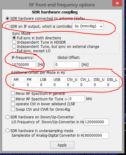

In order to display the frequency you will need to have a communication link between your K3 and the SDR Radio program. This done by using Omni-Rig. I assume you have that running. It is my understanding from other users' post that SDRUno does not have all the panadapter features that are in the HDSDR program. HDSDR has many options for the panadapter and should be able to handle the offset for you. It is a free program so why not try it out. Here is a screenshot of the setup options.GM4FDM wrote:Hi Roger, I asppear to have it working with SDR Uno. I cant quite get my old head around it. This is new technology to me.

- panny.PNG (37.71 KiB) Viewed 17175 times
