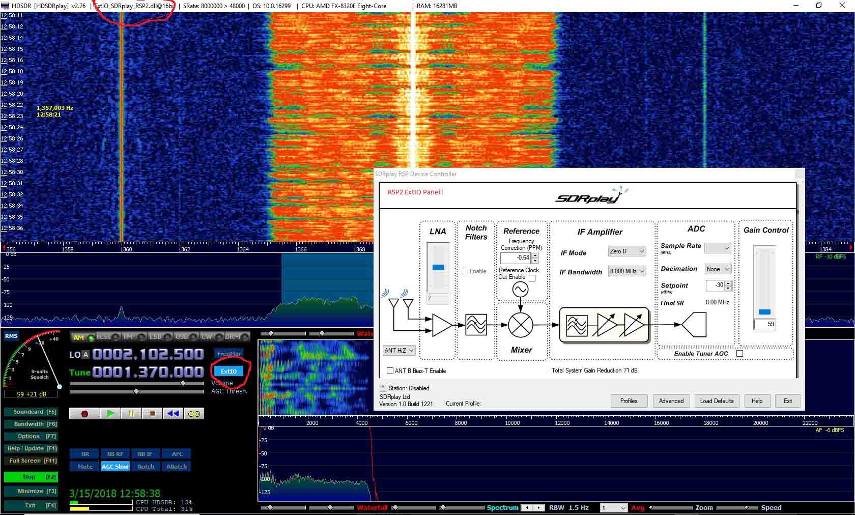

My guess is the extio dll was not loaded. You should be able access the extio control panel by from within hdsdr. If you can not then that is likely the problem.
- HDSDR.JPG (195.53 KiB) Viewed 15697 times
