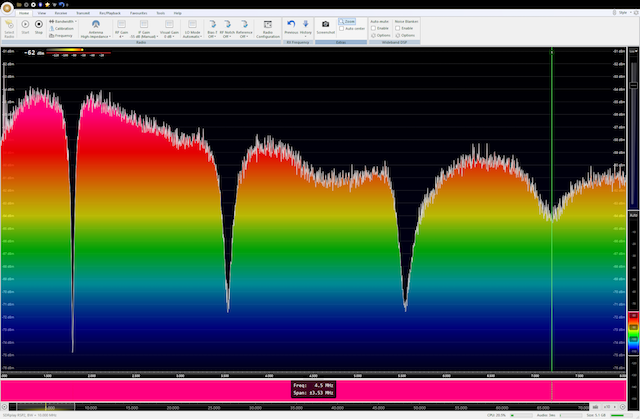

Here are a couple of screen shots of one of the 160m loops, SDR-Console software was easiest to adjust for spectrum range and colour.
Links to originals:
http://www.vk7jj.com/public/HFloop1-1-8.png
http://www.vk7jj.com/public/HFloop2-11-19.png
With the accessibility of SDRPlay hardware and the range of software and it's uses, we can confirm on the bench that the sky is the limit ;-)

Very nice Phil, and those spectrum plots are so PURTY! :). I'm off to take another look at SDR-Console for this.
