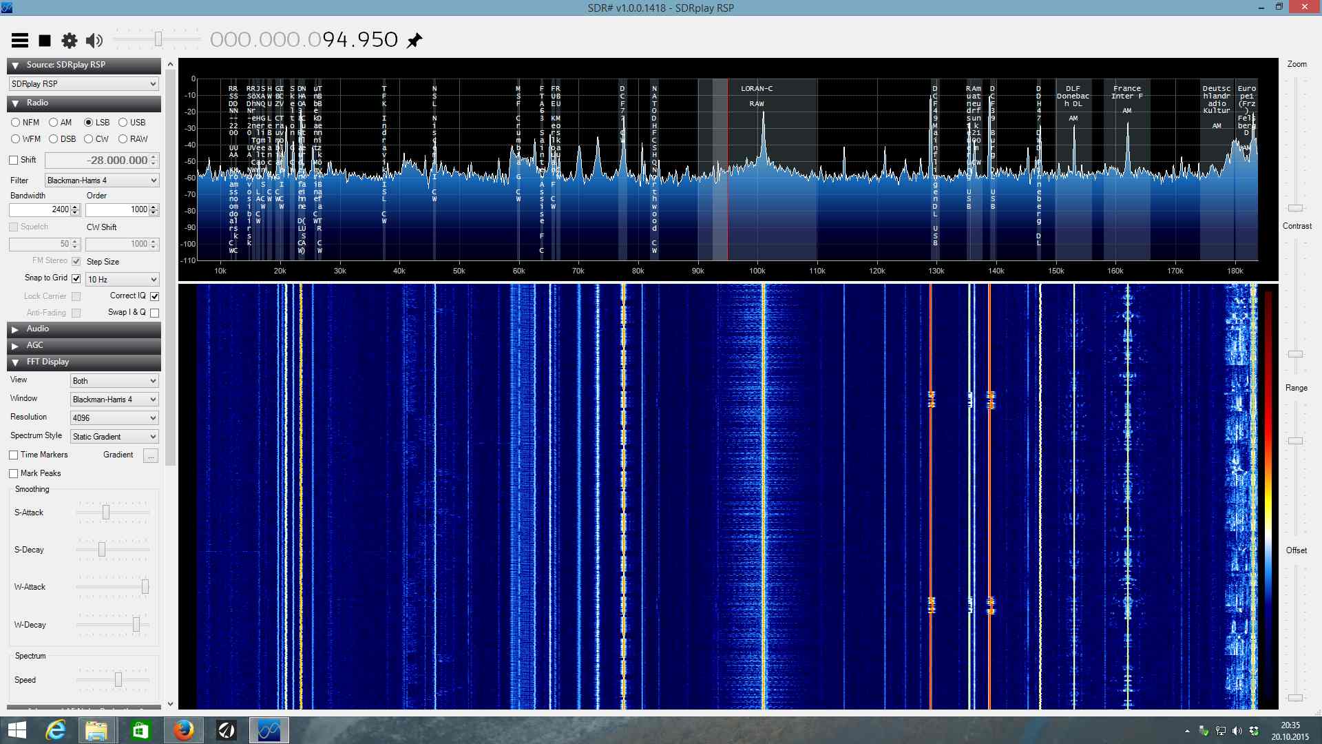

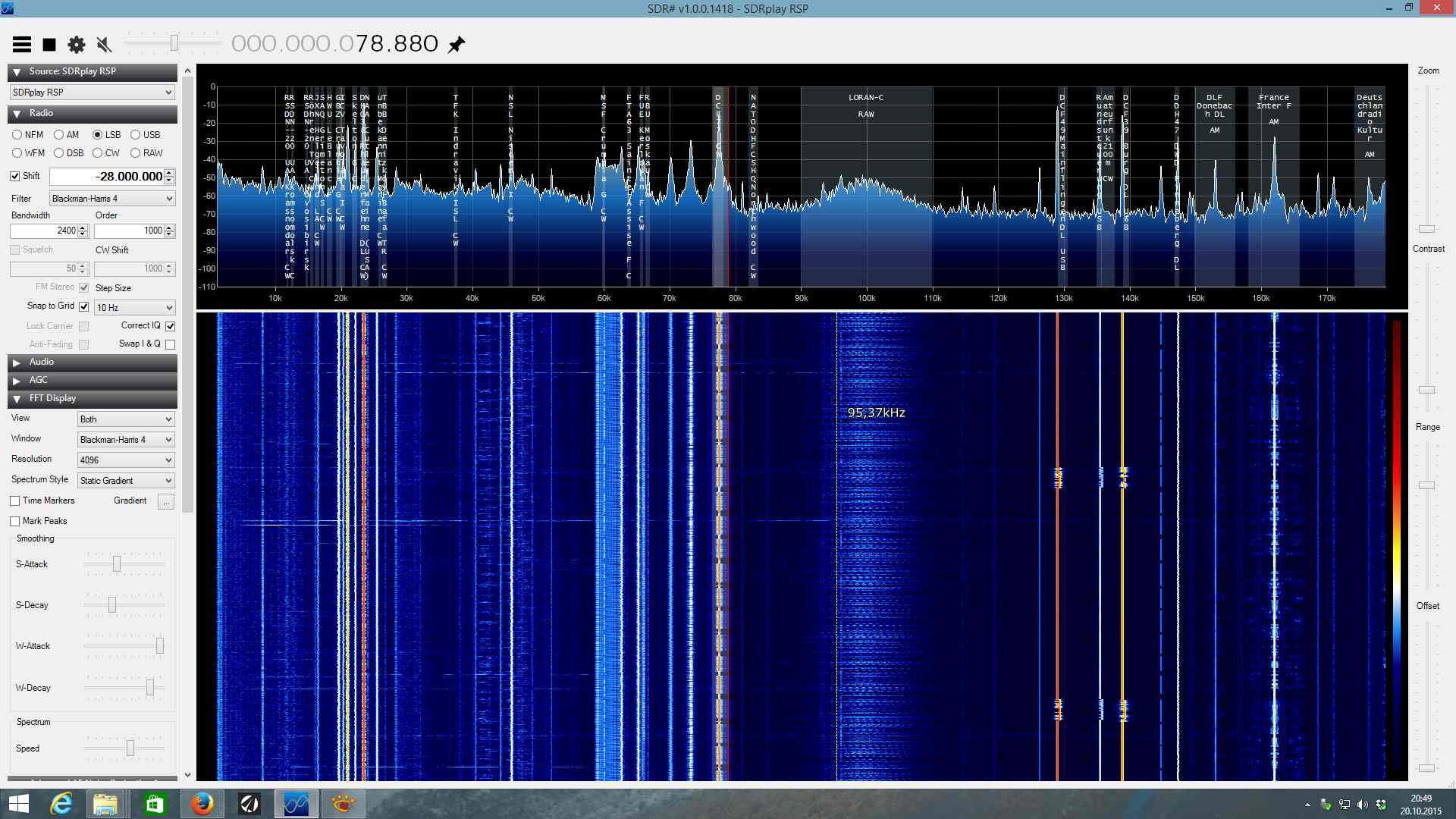

I tried VLF reception without a converter today. My SDRplay works down to approx 24 kHz. DHO38 (23,4 kHz) is the lowest station i can identify between lots of mirror frequencies. DCF77 is no problem, MSC Crumbia is slightly visible, too. ELF stations like Russian Alpha RSDN20 are not visible. Setting sample-rate, filtering preamp etc. is quite tricky. Sometimes i had to restart SDRsharp.
I´m located right in the middle of Germany, my antenna is a Diamond Diskone D3000 (not really a VLF antenna, but it works perfectly with my Datong VLF converter), i successfully copied SAQ last time.
I attached two screenshots of the VLF spectrum, received with the same antenna at the same daytime and optimized settings for each setup. VLF can be received directly, but is difficult to get usable results.
73´s Joerg DL2ZBK
SDRplay VLF with DATONG
SDRplay with DATONG.jpg (195.4 KiB) Viewed 40960 times
SDRplay VLF direct
SDRplay direct.jpg (194.65 KiB) Viewed 40960 times

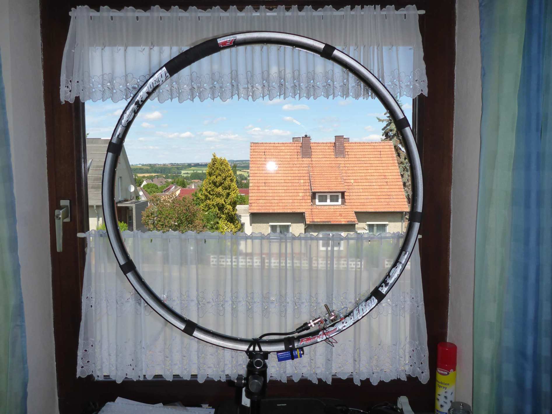

Unbelievable, but i get best results with my Diamond D3000 Diskone antenna with approx. 15m H155 Antenna cable. I built up a magnetic loop trimmed exactly to 17.2 kHz, but the Diskone has a better SN ratio although the signal level is lower than the signal level of the loop. I´ll try to get my loop weather-resistant until christmas and will try again on christmas eve.
Joerg.
2015-06-28 142947 Bike-Loop SAQ.jpg (198.6 KiB) Viewed 40761 times
