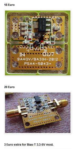

I have an RSPduo and am trying to drive a lna4all at the antenna with the built in Bias-t. I am not getting any voltage out of the RSPduo on Tuner 2 port when I have Bist-t selected in SDRuno so I am unable to drive the lna4all? Please advise?

The RSPDuo's Bias-T outputs 5 volts@100ma. Some versions of the LNA4All have their own on board 5 volt regulator and require a 6 to 9 volt Bias-T supply. Another version can operate with a 3.3-5V Bias-T according to the LNA4all website. http://lna4all.blogspot.com/. Was a spec sheet included with it?
