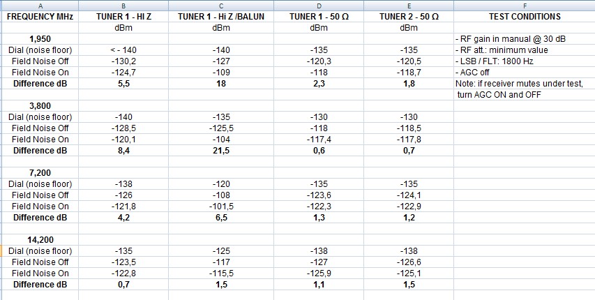

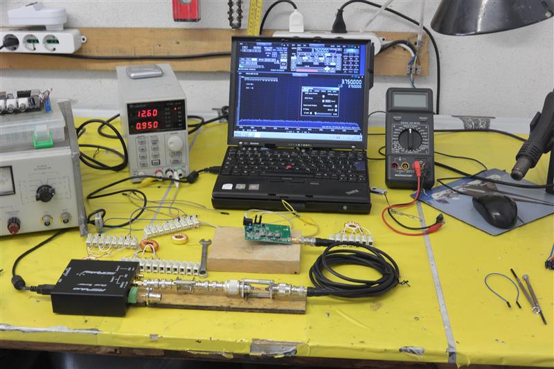

After reading the excellent articles of this thread:
viewtopic.php?f=7&t=1562

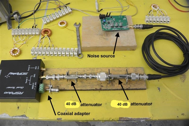

I purchased one specimen of the wideband noise generator described therein in order to test the RSPduo receiver sensitivity at the various inputs and to set up reference data which would allow me to check receiver performance from time to time. This activity was also stimulated by the realization that receiver sensitivity on the Hi Z port appeared to be significantly better than on the 50 Ohm inputs, so relative measurements among inputs would be very useful.
This post concerns the HF range from 1.9 to 14 MHz. The noise generator in this frequency, with a 12.6 V supply, outputs a level of roughly - 50 dBm. To test sensitivity NF style it is necessary to feed the inputs with a very weak signal which can barely increase the S/N ratio.
To bring the noise level to the needed weak signal of nominal -130 dBm, I built two -40 dB attenuators. The receiver is set up as shown in TABLE 1:
- IF gain in manual @ 30 dB. Note that in the table it is wringly mentioned as "RF gain".
- RF att. minimum value.
- LSB.
- Filter 1800 Hz.
- AGC OFF. Note that somentimes the receiver audio mutes in these conditions. Just quickly turn the AGC ON and then OFF.
The test procedure is simple. Just connect the text fixture to the desired input with the NG (Noise Generator) OFF and note the noise floor on the receiver's (RSP1) dial & the field noise. Then turn on the NG and note the MINIMAL difference: you should barely hear the difference in noise. If the difference is more than 10 dB, it means you have to increase the attenuation, to come near the receiver's noise floor. The DIFFERENCE between the NG OFF and ON gives you a fair idea of the receiver's sensitivity, as well as telling you if (God forbid!) one input is not operative. Test results can also be recorded as a reference for future tests.

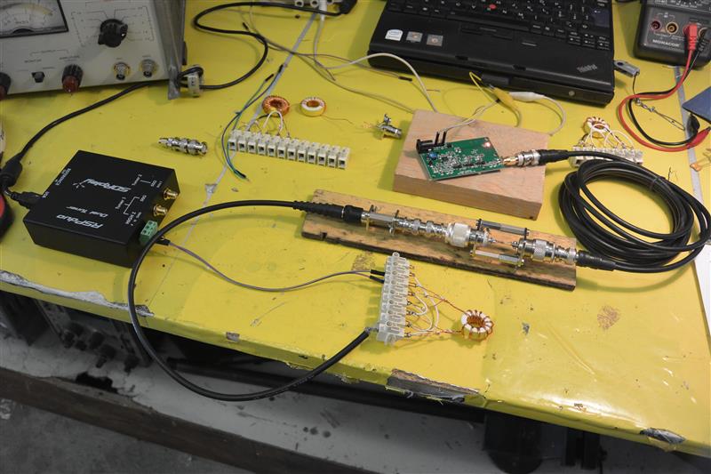

Looking at TABLE 1 it is evident that the HI Z input is the most sensitive up to 7MHz. I wa also aware that at 7 MHz and below the receiver was significantly more alive using the HI Z port with a 9:1 balun (and a long wire antenna) as compared to the 50 Ohm ports. This is confirmed in TABLE 1, where the advantage is between 15 and 20 dB up to 3.8 MHz and goes down to 6 dB at 7 MHz. This advantage is much lower at 14 MHz, probably due to the fact that a different, lower inductance balun must be used here.
- LSB.
- Filter 1800 Hz.
- FIGURE 1 - GENERAL TEST SETUP
- General test setup.JPG (103.43 KiB) Viewed 45957 times
- TABLE 1 - TEST RESULTS
- Sensitivity Table.JPG (74.36 KiB) Viewed 45957 times

Sorry: the system did not let me post additional files. Here they are. To conclude the tests have demonstrated excellent sensitivity in all HF bands, considering that the minimum detectable signal is always at or below 0.14microvolts.
ERRATA CORRIGE: Please note that the final single attenuator value that was used in the tests is 46 dB, not 40 dB, so the total attenuation to use in the test behind the NG is 92 dB, i.e. the output of the NG in this frequency range is in excess of -40 dBm.
WARNING AS OF 05/07/18 :I used the noise generator with a supply voltage of 12.6V. The last amplifier stage of the generator failed after 15 days, probably because this supply voltage is NOT suitable. Better be safe and use no more than 10.0 V
- FIGURE 3 - TESTING HI Z INPUT WITH A BALUN
- Testing with balun.JPG (97.58 KiB) Viewed 46071 times
- FIGURE 2 - TEST FIXTURE DETAILS
- Test details.JPG (151.87 KiB) Viewed 46071 times

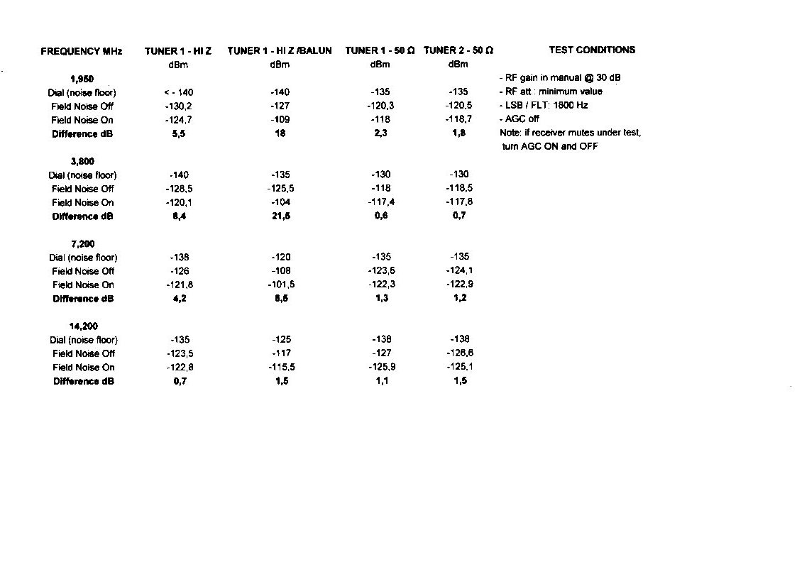

I post here a clearer version of TABLE 1.

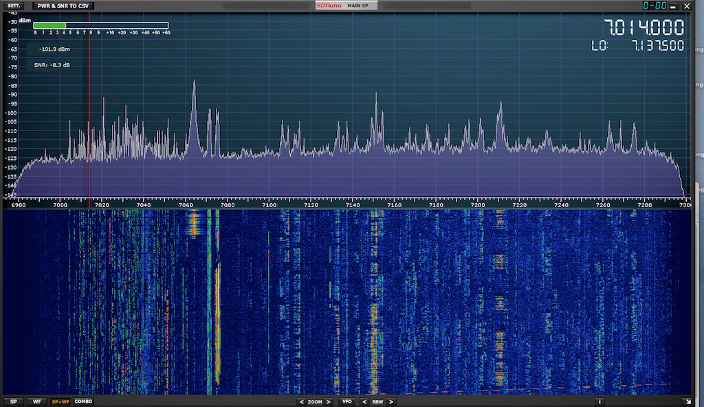

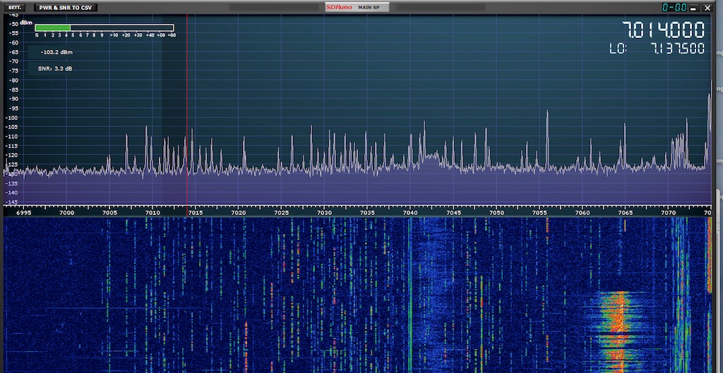

Hi glovisol, thanks for your post, most informative. Just for comparison here are a couple of examples of real world low noise performance on 40m from an RSP1A.
The only noise on the waterfall apart from that generated by the multitude of ham SSB stations appears to be at 7.042MHz and that appears to be generated within the RSP1A as it's not present in the RSP2.
Only one of the SSB stations was within Australia, all the CW and the remaining SSB stations are around 13,000 - 17,000km away from my Tasmanian location being mainly in Europe and the US.
As you say the RSP2 appears to offer generally slightly better low-noise performance from it's HiZ input but it was active on WSPR at the time of these pics. Looking at the traces makes one wonder how WSPR manages! Excuse the fuzziness of the low quality jpgs.
The slight slope on the noise floor follows the slope of the antenna's gain.
The RSPs truly are excellent receivers.
Regards, Phil VK7JJ
Overview of 40M CW segment
Regards, Phil VK7JJ
