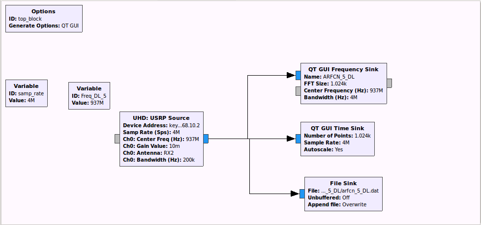

2. Recording the Time frames from the configured freq using GNUradio companion. (.grc file is attached below).
Center Freq - 937Mhz.
Channel Bandwidth - 200Khz
SAmple rate - 4Ms

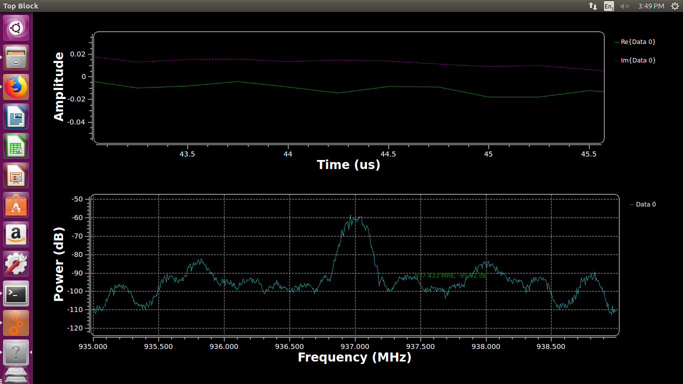

Gnu radio Freq FFT analyzer doesn't show up the spectrum from the configured center frequency. Instead complete 200Khz bandwidth is having the same signal level (around -60 dbm).

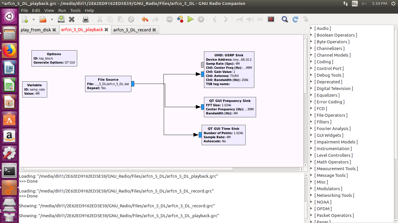

3. I tried playback of recorded RF signal (from freq 937Mhz) which is captured in the point 2. (playback .grc image is attached below).
Observation:
But we observe only noise from the playback using USRP. Noise is more when compared to data. Unable to recreate the recorded RF signals.
