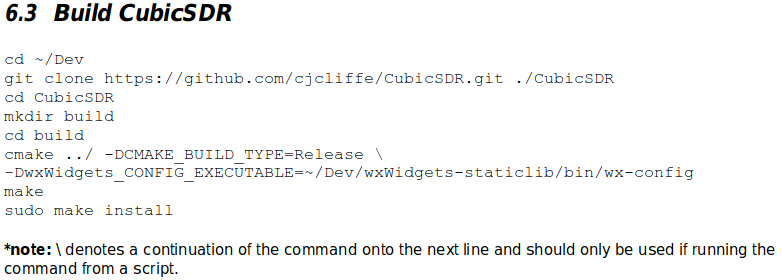

The sdrplay document has formatting problems which prevent proper copy and pasting of the commands needed. I thought I fixed the errors in the document, but clearly I missed something. In the very last step (section 6.3 of the support document) I get an error.

Yes, the above single line is a paste directly from the support document.
Below section 6.3, there is a note stating that the ‘\’ symbol is a continuation of the same line. I tried to paste that message into this post, but it fails, presumably due to more formatting errors in the document. The only way I can copy it into this message is to take a screenshot of the message, see attached.
I believed the line in question should have been:
Code: Select all
cmake ../ -DCMAKE_BUILD_TYPE=Release-DwxWidgets_CONFIG_EXECUTABLE=~/Dev/wxWidgets -staticlib/bin/wx -config
Note that the above is a single line, not 3 different lines as it appears to be when formatted by the forums text format software.
I have no idea what I should enter into the terminal to finish up the build.
Hopefully someone can suggest a remedy-I’m in above my head as I don’t have experience building software from it’s source code.
TY
ABA

Try this:
Code: Select all
cmake ../ -DCMAKE_BUILD_TYPE=Release -DwxWidgets_CONFIG_EXECUTABLE=~/Dev/wxWidgets-staticlib/bin/wx-config
Blank before -DwxWidgets_...
No blanks before -staticlib and -config
