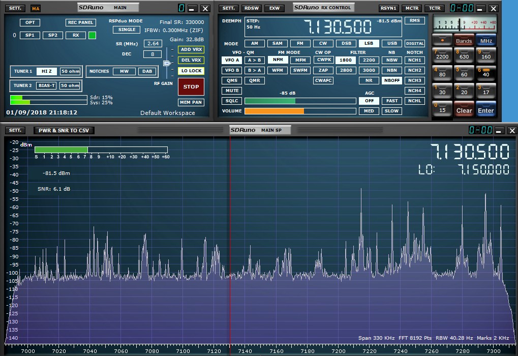

ANOTHER TRICK - UNKNOWN BUT UNBELIVABLE PHENOMENON IN HF BANDS (ONLY TESTED 80 & 40 M)
1) Turn receiver ON and make sure AGC is OFF.
2) Disconnect antenna terminals.
3) Reconnect antenna.
4) You will see the signals on the display and hear them perfectly, BUT THE BACKGROUND NOISE IN YOUR AUDIO WILL HAVE GONE ALMOST AWAY!!
My receiver is RSPduo. Software SDRplay. It seems like some gain parts of the RSP become locked in a special position.
This effects I cannot explain, but provides fantastic S/N in the audio output. Promise I had a glass of wine only for dinner...
- I am listening to a very weak signal invisible in the display, with virtually no noise in the headphones!
- ScreenHunter_227 Sep. 01 21.18.jpg (194.64 KiB) Viewed 30693 times

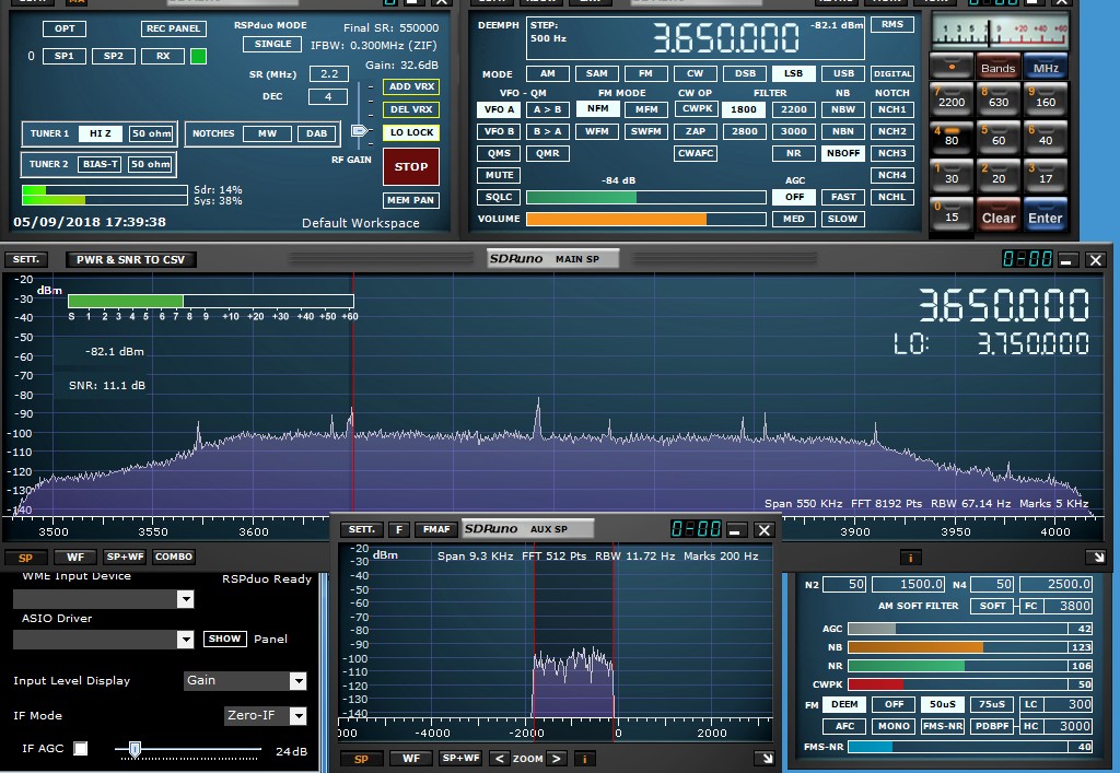

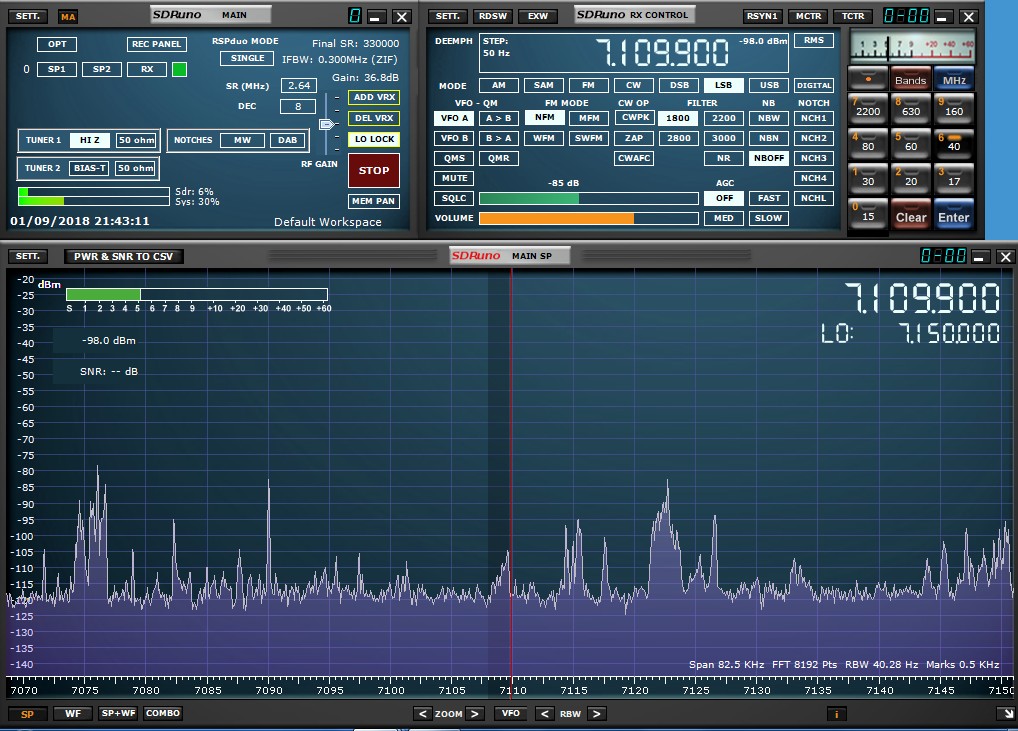

Re: HF weak signal reception in presence of noise
The explanation of the "low noise" effect should be as follows:
1) With AGC "OFF" and no antenna the system sets for minimum gain: e.g. the noise level internally generated.
2) When you re-connect the antenna the gain stays at the previous level (internally generated noise) and the weak signal is available and readable, provided it is at a level higher or equal to the antenna noise, but the antenna noise cannot be boosted by the AGC action, because AGC is OFF.
3) This mode of operation provides reception similar to that of squelched operation in the FM higher bands by removing most of the noise.
Hope other operators can confirm the effect on this thread.
- "Noise free" reception with AGC OFF
- ScreenHunter_228 Sep. 01 21.43.jpg (201.25 KiB) Viewed 30656 times

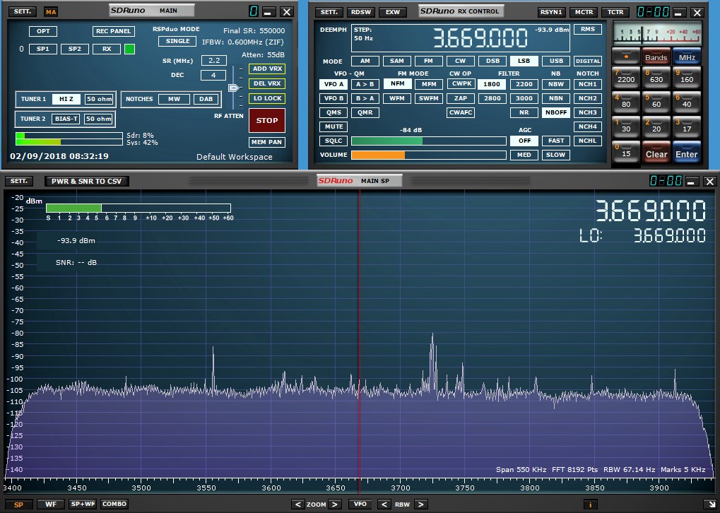

To reiterate and summarise after a lot of listening, this "noise advantage" is very marked as long as the antenna noise is high, in the order of -100 to -110 dBm and becomes less and less significant for antenna noise at or below -125 to -130 dBm. With my setup, Beverage antenna on the 80 & 40 m bands, it makes the difference between copying perfectly an S6 signal on S6 noise and not copying at all.
- Exploited "noise advantage" on 3.5 MHz
- ScreenHunter_229 Sep. 02 08.32.jpg (190.01 KiB) Viewed 30605 times

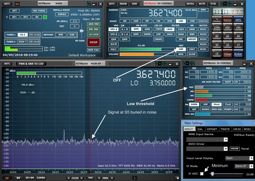

Another example with AGC + IF AGC in manual and at minimum with perfect copy of S5 signal in S5 noise.
- Weak signal reception in noise.jpg (296.12 KiB) Viewed 30486 times

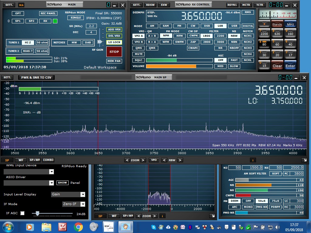

NOISE BLANKER EFFECTIVENESS WITH STRONG IMPULSE NOISE
Noise blanker adjustement when in presence of strong antenna noise plus impulsive noise is extremely critical, not to say impossible, without resorting to manual gain and keeping RF and IF AGC OFF. On the contrary, with the AGC's OFF, Noise Blanker performanceof the RSP receiver is simply exceptional, considering that in most receivers it is just a useless control.
In the enclosed screens you see an S5 signal received on the 80 m band in presence of impulse QRM. Without Noise Blanker nothing can be copied. With Noise Blanker this weak signal can be copied with no problem, while the noise floor has dropped by 10 dB!! The trick is to kep the gain thresholds as low as possible, otherwise controlling the NB slider wil become very abrupt and simply clean off all received signals.
Best performance is acheved by keeping the two AGC thresholds at a very low level and DELICATELY adjusting the NB slider. Also RF gain must be kept as low as possible!
Cheers,
Cheers,
- Noise blanker ON - Noise floor: -110 dBm
- Noise Blanker ON.jpg (233.13 KiB) Viewed 30404 times
- Noise blanker OFF - Noise floor: -100 dBm
- Noise blanker OFF.jpg (206.71 KiB) Viewed 30404 times
