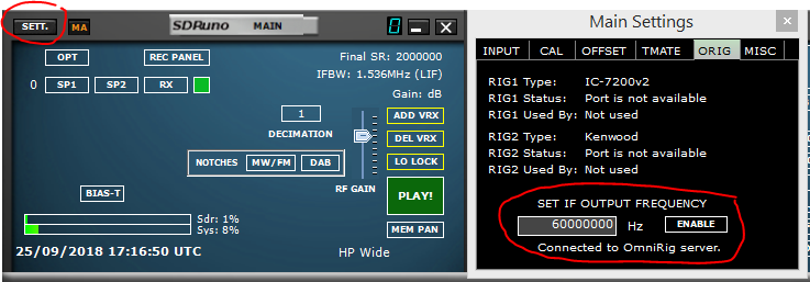

This may help you.... viewtopic.php?t=1347
Have you set the IF frequency in the main settings?
See the other settings in the post linked above.
