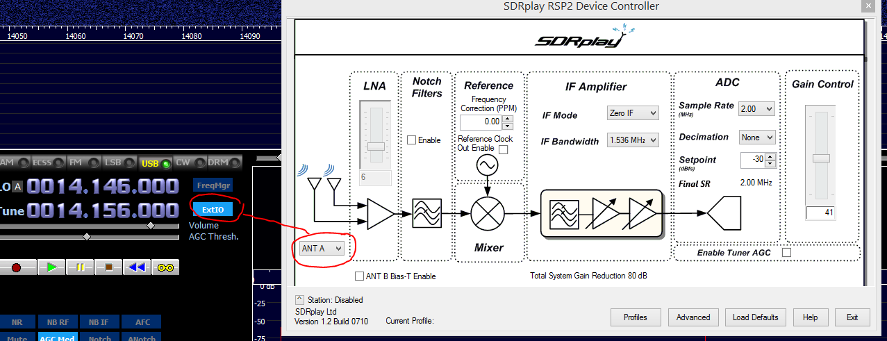

Click the EXTIO button and select your antenna from the popup. This is also how you configure all the other settings for the RSP.
- hdsdr.PNG (95.22 KiB) Viewed 18068 times

Re: HDSDR And RSP-2: selecting Which Ant. For Program ?
You need to install the EXTIO.dll so that HDSDR is able to run with your RSP.
If you install the SDRplay version of HDSDR it will install everything for you and create startup icons for your RSP2. You can download the RSP version of HDSDR here:
https://www.sdrplay.com/downloads/
Uninstall your copy of HDSDR first before running the SDRplay install package
