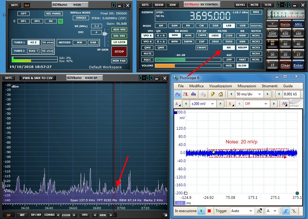

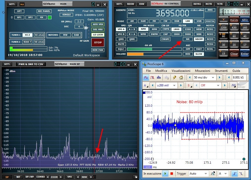

With my RSPduo and RDSuno 1.23 the slider does not seem to work, even if I wait a few seconds. However the noise reduction is very good, as shown in the enclosed PC screens with oscilloscope. Noise is reduced by 12 dB from 80 to 20 mVp.
Screen scope shows NR OFF
NR OFF Oct. 19 18.57.jpg (295.7 KiB) Viewed 23656 times
Screen scope shows NR ON
NR ON Oct. 19 18.57.jpg (287.14 KiB) Viewed 23656 times

Hi Mike 2459, apologies, you are quite right. It takes 10 seconds approx., but then the action of the slider at 200 is quite noiceable! Thanks.
Amended 20/10/18: The NR device has two response times: there is an immediate and very noticeable partial reduction effect, followed by a final adjustment with a response time of 30 seconds approx., when moving the cursor from 2 to 200. Once set, NR can be switched ON and OFF and noise cancellation is immediate, with no further delay.
In effect the noise reduction, with slider at 200, is much higher that 12 dB, while not altering the weak received signal, apart from a slight cut of the highs, which does not impair readability. Tomorrow I shall post much more accurate and up to the point measurements.

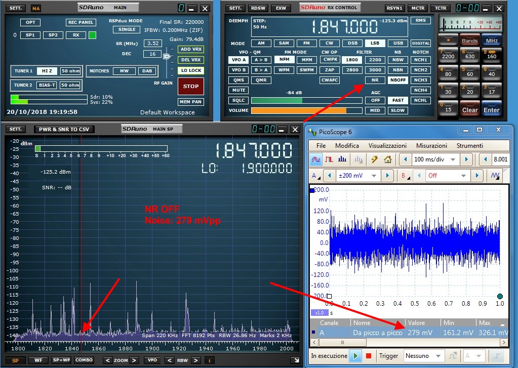

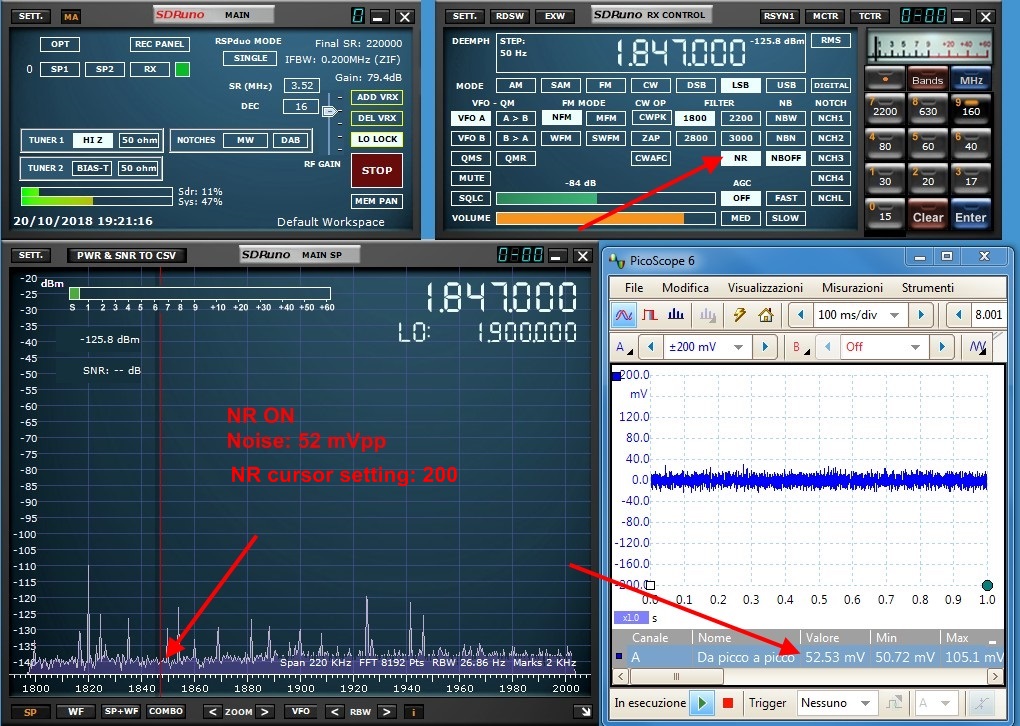

Here below NR action documented at 1.8 MHz. Noise attenuation with cursor @ 200 is in excess of 14 dB. Lest someone notices an unbelivable noise floor @ 1.8 MHz, PC screens taken with RSPduo in operation with an antenna attenuation of 20 dB. The NR facility is of course useful with weak signals. With average to strong signals (e.g. 10/12 dB above noise floor) NR is best kept OFF.
1.8 MHz - NR OFF
1.8 Mhz-NR OFF Oct. 20 19.20.jpg (314.51 KiB) Viewed 23610 times
1.8 MHz - NR ON with cursor @ 200
1.8 MHz-NR ON Oct. 20 19.21.jpg (303.64 KiB) Viewed 23610 times
