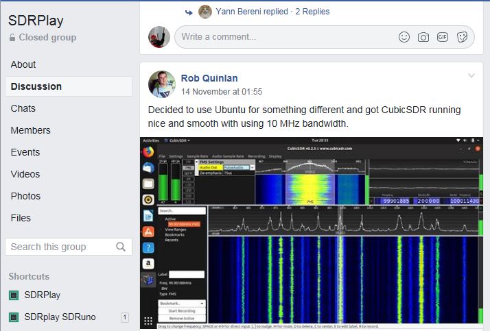

Richard,
I approved your post despite it appearing to be solely intended to embarrass the company and paint us in negative light. For the record, we don't censor posts unless they are spam, abusive or aggressive. You post was just the right side of the line where the latter was concerned.
I want to correct one point that you are making. The RSP drivers DO work on Linux and we have many users using RSPs with a Linux OS. It is just not currently working with your system.
You initially posted on this forum looking for help with Linux. If you read the banner at the top of the page, you will have seen that it clearly states that for support you should go to http://www.sdrplay.com/support
When after just one day, you didn't get a response from the community, you placed another post stating that the Linux drivers clearly don't work. I suggested that you should open up a support ticket and that if you did so, the company would try to help you resolve the problem. at 5:06pm on Saturday afternoon, you opened up a ticket. The person best positioned to help you is away this weekend, but at 6:39pm they posted an initial response from their hotel room. At 7:55pm you posted back stating that the problem was still not resolved. At this stage, we do not know whether you have a faulty device or a software problem, but as far as were understood it, this ticket is still in progress. When the person who has being trying to help you returns, we would be moving the ticket forward to try to resolve your problem in a systematic and methodical way.
You have a few options open:
You can try your unit on a Windows machine or a R-Pi to check the unit is definitely functional.
You can wait until Sunday night or Monday morning when we will continue to try to help you via the ticketing system.
Or finally, you can simply return your device from where you bought it for a refund.
