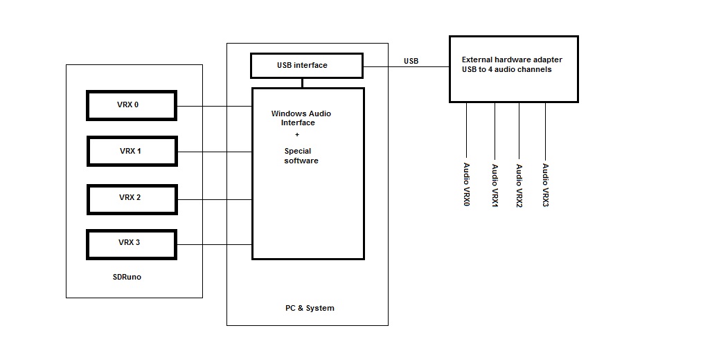

I really hope some forum member has alredy worked out the multiple output setup I have uploaded below and would be kind enough to provide an in depth detailed explanation on how to do it! The external USB / audio channels should ideally be a commercial, ready made unit or an adaptation of something already existing.

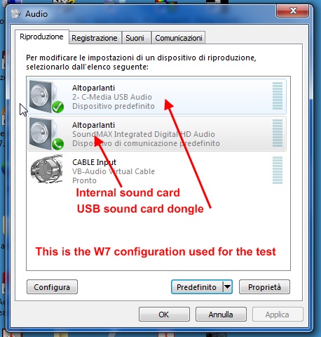

Hi Mike 2459, it works fine! To provide the sound outputs is much easier than anticipated.
- The PC sound card, being Stereo, has two channels already.
- An external USB sound card dongle provides two additional channels. Figure 1 shows the two sound cards enabled and in use. With this setup we have four VRX's available, each with its own sound.

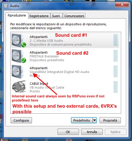

- Furthermore adding an additional USB sound card dongle, it is true that we have exhausted the PC/W7 capability (only two sound cards can be accessed) but luckily SDRuno accesses the internal sound card by default even if not set in use. This is shown in Figure 2. With this setup we can have six VRX's available, each with its own sound.

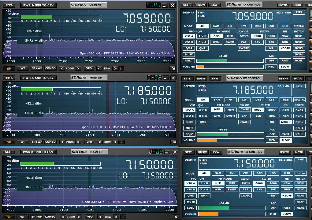

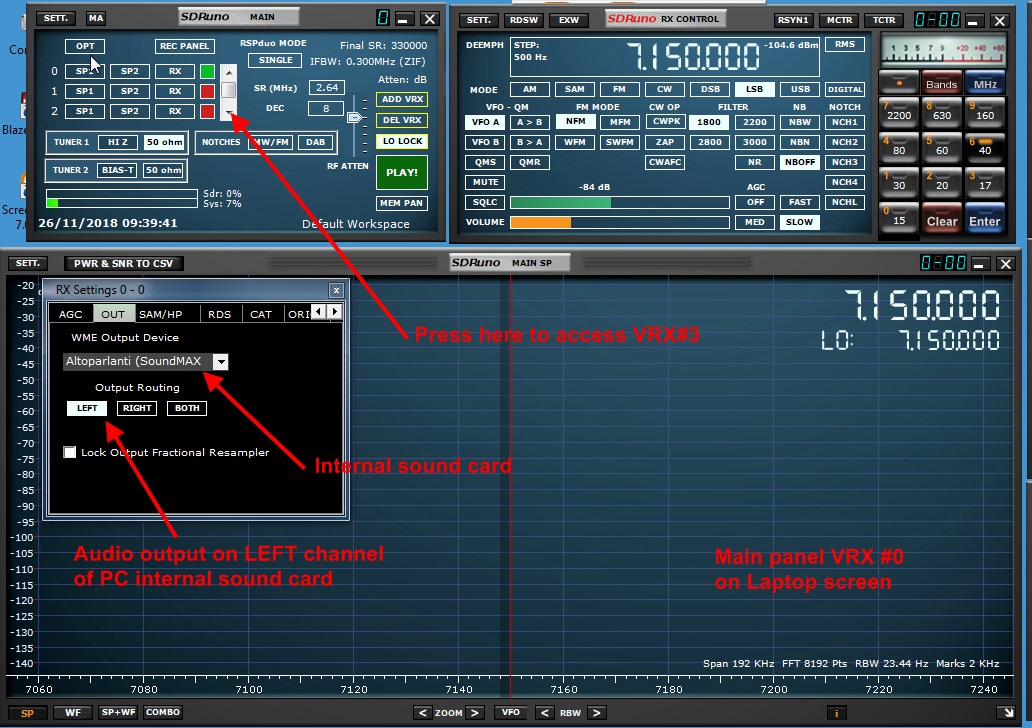

The system has been tested with 4 VRX on a 2 MHz bandwith and PC screens are shown in Figures 3 & 4.

- Figure 1 - Settiing up with one USB dongle
- 1. Single USB sound card.jpg (79.79 KiB) Viewed 30267 times
- Figure 2 - Setting up with two USB dongles
- 2. Double USB sound card.jpg (87.26 KiB) Viewed 30267 times

More PC screens below.
- In operation.png (434.54 KiB) Viewed 30263 times
- Figure 3. PC screen of laptop and VRX#0 with main SDRuno system panel
- 3. Main panel, VRX#0.jpg (285.16 KiB) Viewed 30267 times

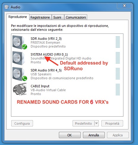

Like this? See figure 5.
- Figure 5. This is better when several VRX's have to be managed!
- 5. Renamed sound cards.jpg (73.97 KiB) Viewed 30246 times
