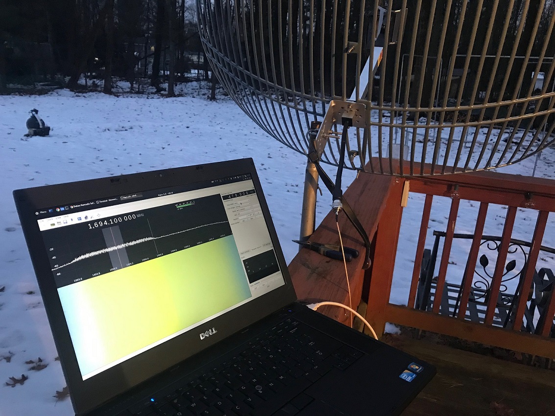

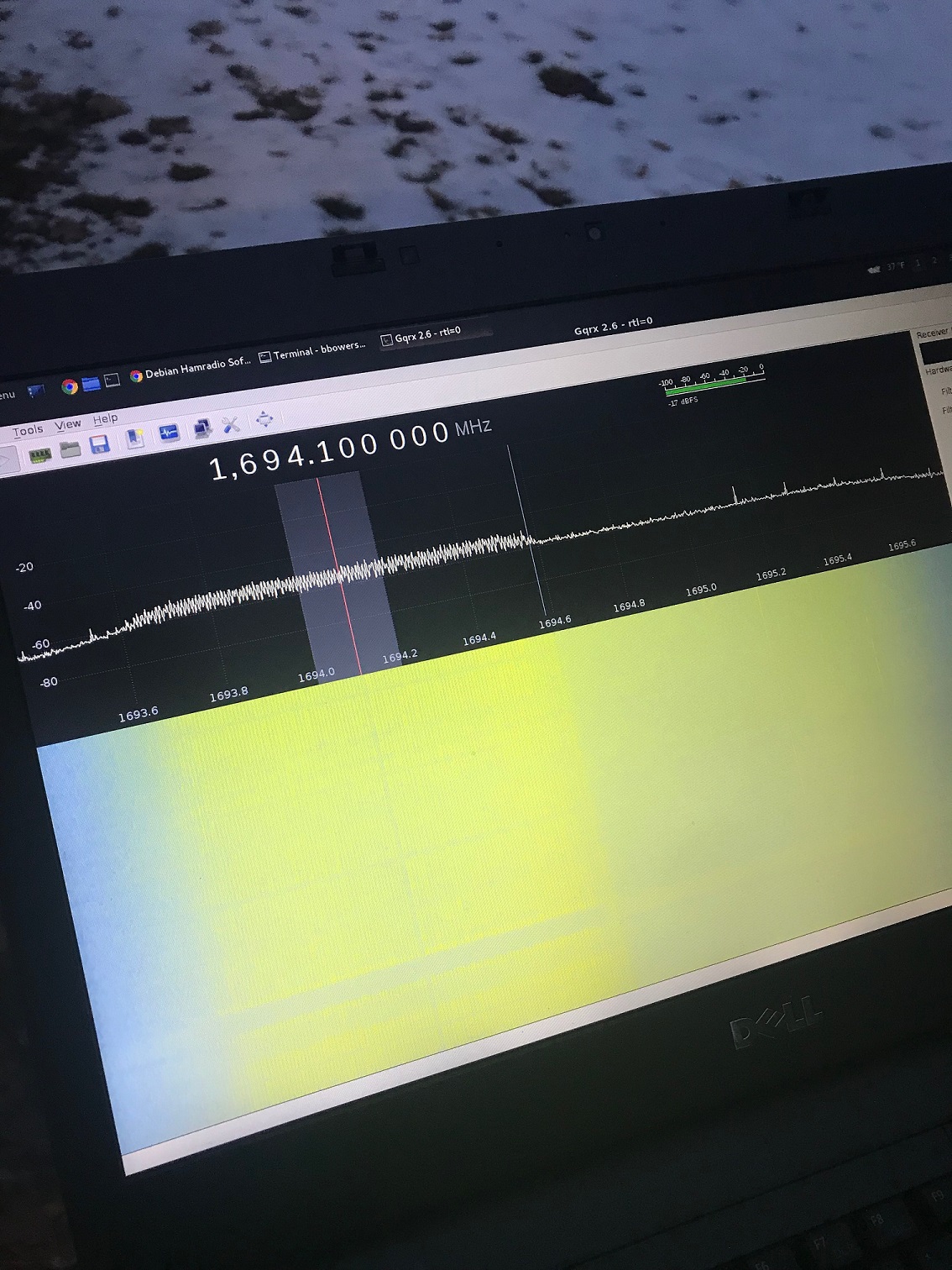

Hi all,
I just started playing with reception of GOES 16 from upstate NY. As it sits from my house I'm looking at ~40deg elevation and around a 185 heading. This puts it just at the tops of the trees in my back yard.
First question is, will a few sticks in the way really kill my signal that much? I understand leaves will be a whole other story which I'll likely find myself climbing a tree with a chainsaw later to tackle.
I have the 2.4GHz 24dbi parabolic grid antenna currently. Also running a NESDR SMArTee XTR (alternatively I tried a RTL-SDR v.3 dongle), also running a SAWBird+ GOES LNA. I can't seem to get any signal at all, or at least any compared to my noise floor. I'm trying to figure out if it's the LNA or the antenna causing the issues. I'm basically running the thing direct to the antenna, so no coax loss.
I've tried flipping the sub-reflector, placing the dish diagonal, horizontal, vertical, etc. The only thing I haven't done is extended the dipole for 1694mhz to get it closer to the freq. So I'm running out of options here and it seems hard to find people that know what they're talking about with this kind of thing even in the amateur radio community.
Last night was my first success even seeing anything on the waterfall... Unfortunately after switching to the v.3 dongle and back to the XTR I wasn't able to replicate the signal reception again... and it was cold and my fingers were frozen so I gave up.
So, where to go from here? Attached some photos.

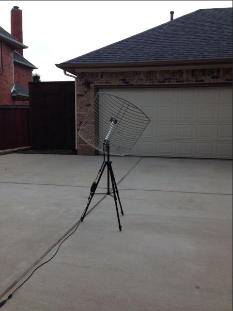

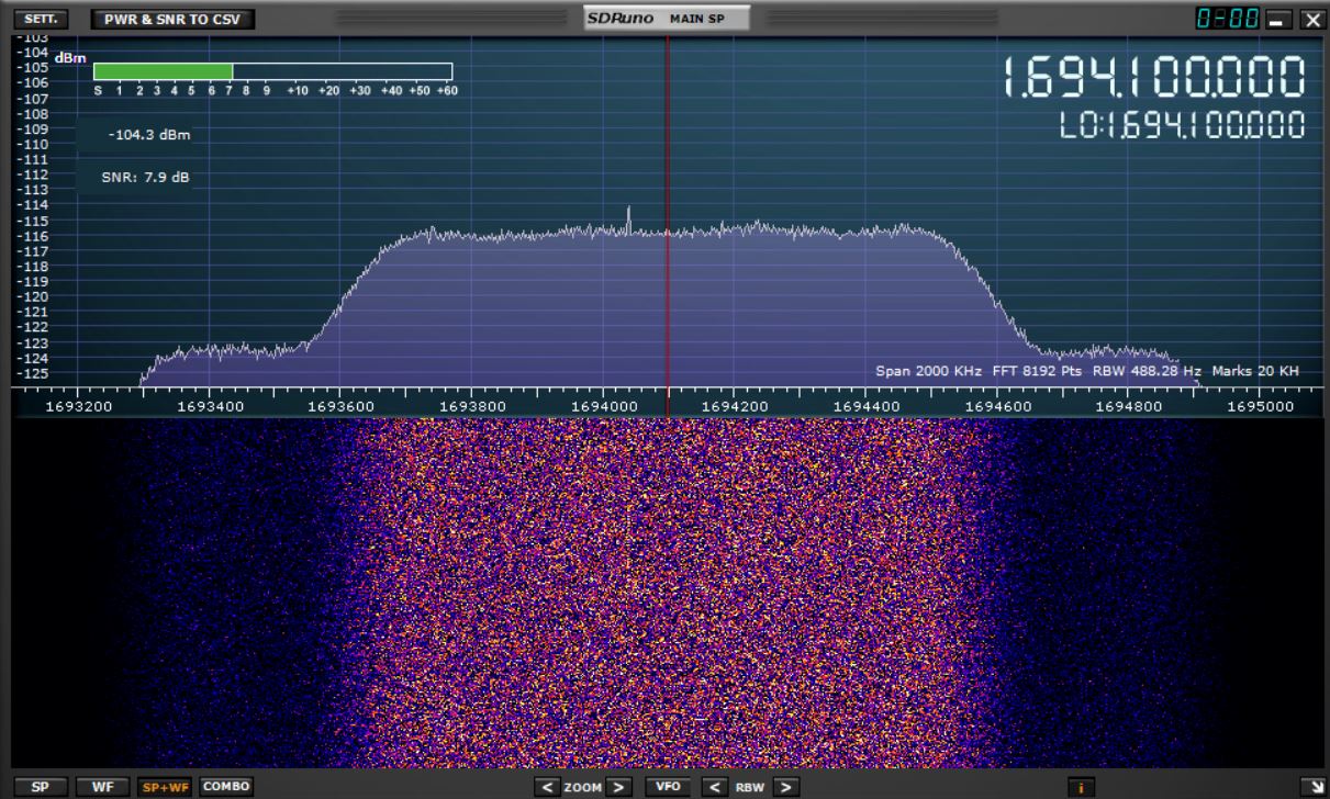

Looks like you are receiving the GOES HRIT signal fairly well, though it is hard to tell for sure based on the scale you have selected. The signal circled in red below is the GOES HRIT signal (when sending its "null" data pattern and not yet transmitting images). You need an SNR of around 6.5 dB or more to decode the signal well. If you can change your scale to 1 dBm per division and take a screen shot of the signal, it will be easier to tell if the signal will be good enough for proper reception. Also, you may want to rotate your antenna using the feed tube as the axis about 45 degrees counterclockwise when facing the GOES 16 satellite in order to achieve the optimum polarization and best reception (rotate the position of the grid antenna and feed tube together on the mounting bracket, which has 8 holes to allow for a 45 degree position). The NOAA specification for GOES 16 HRIT is for vertical polarization; however, many have found that using a 45 degree polarization offset as described here works better for GOES 16. For GOES 17, a vertical polarization works well. It is best to check the signal level for comparison once the antenna has been adjusted for the appropriate satellite signal polarization. Do also tweak the antenna position for best reception on a scale showing 1 dBm per division.
Image showing the optimum polarization setting for the antenna for GOES 16:
Image showing the signal level (note the scale used and that the sample rate was 4 MSPS for testing). For testing, the filter bandwidth was set less than 10kHz, since the decoding software uses the IQ samples directly and applies different receiver and IQ streaming software:
