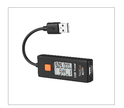

This is the one I use. Bought it on Amazon for about 7 USD. https://www.tacklifetools.com/product/p ... dex/id/150 Gives voltage, current draw in milliamps and energy used in ma-hour.DF1KZ wrote:There are many cheap devices you can insert between the USB plug and the cable. They show you the voltage and the current.brooksjo wrote:Hey guys,
