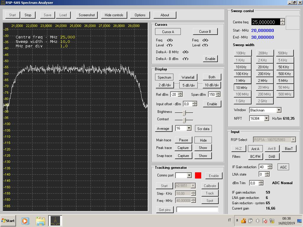

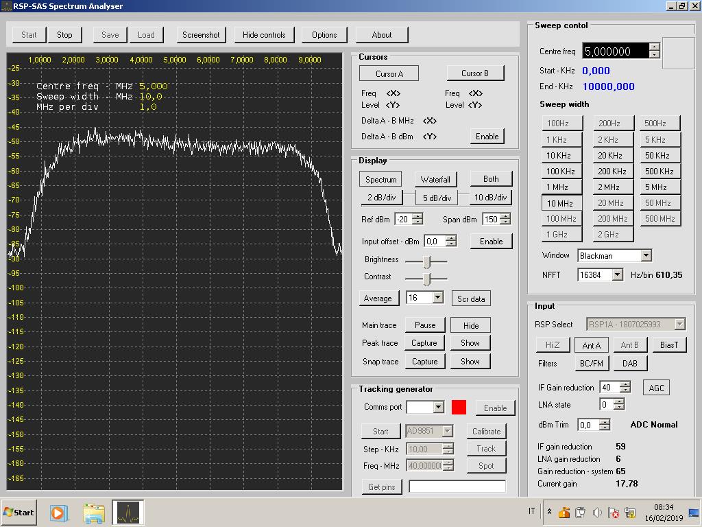

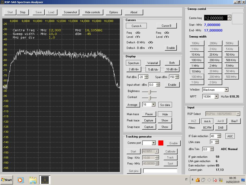

- NOISE GEN 8-15 MHz.jpg (156.97 KiB) Viewed 52893 times
- NOISE GEN 11-22 MHz.jpg (156.43 KiB) Viewed 52893 times
- NOISE GEN 21-29 MHz.jpg (156.01 KiB) Viewed 52893 times

As we can see, we go from -50 dBm @ 2 MHz to -58 dBm @ 29 MHz, but this difference is not important, in LP / HP filter work, because what we are concerned with is the frequency range above above and below the cutoff frequency, where the noise output is flat within measurement limits, just look at the screen uploaded below. Furthermore far off the output difference is known (the Spectrum Analyser tells us) and allowance can be made. If we also have an $ 60 Network Analyser, then the Return Loss measurement will complement the far off measurement.

- NOISE GEN 1-8 MHz.jpg (155.24 KiB) Viewed 52893 times
