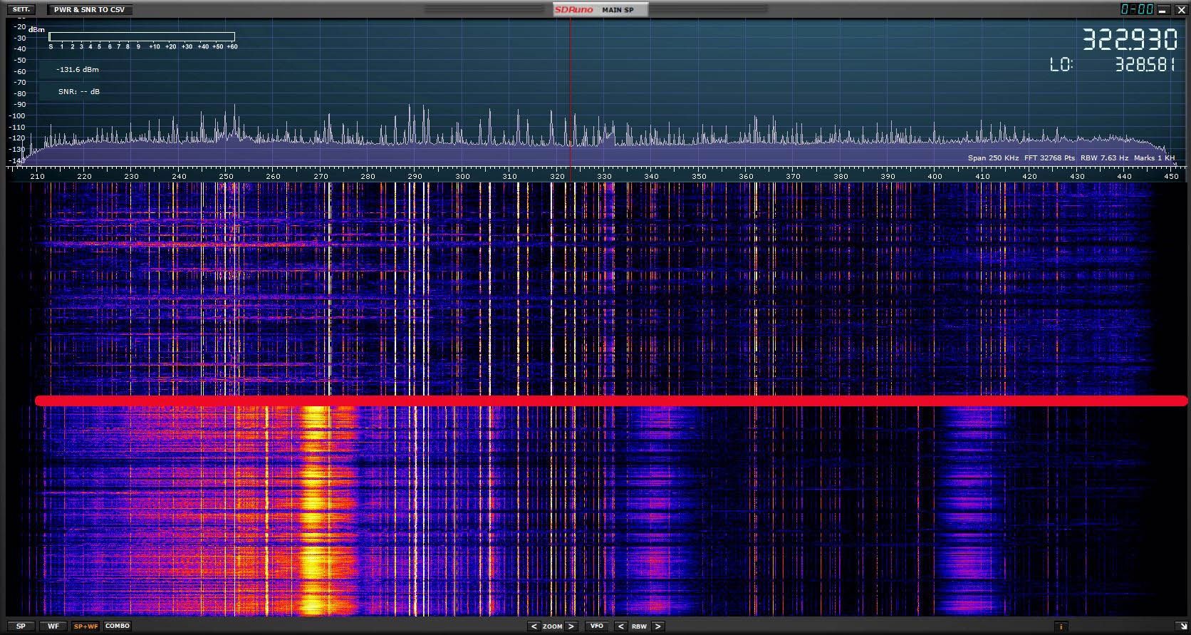

Above Red Line: RF Isolation transformer in circuit:
Below Red line:Ground loop created by bypassing ground around RF isolation transformer:
Ground_ Loop.jpg (410.9 KiB) Viewed 32565 times
The horizontal streaks are due to distant thunderstorm activity. Primary noise source, among others, is the PC's SMPS
