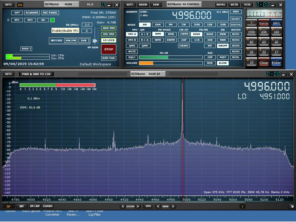

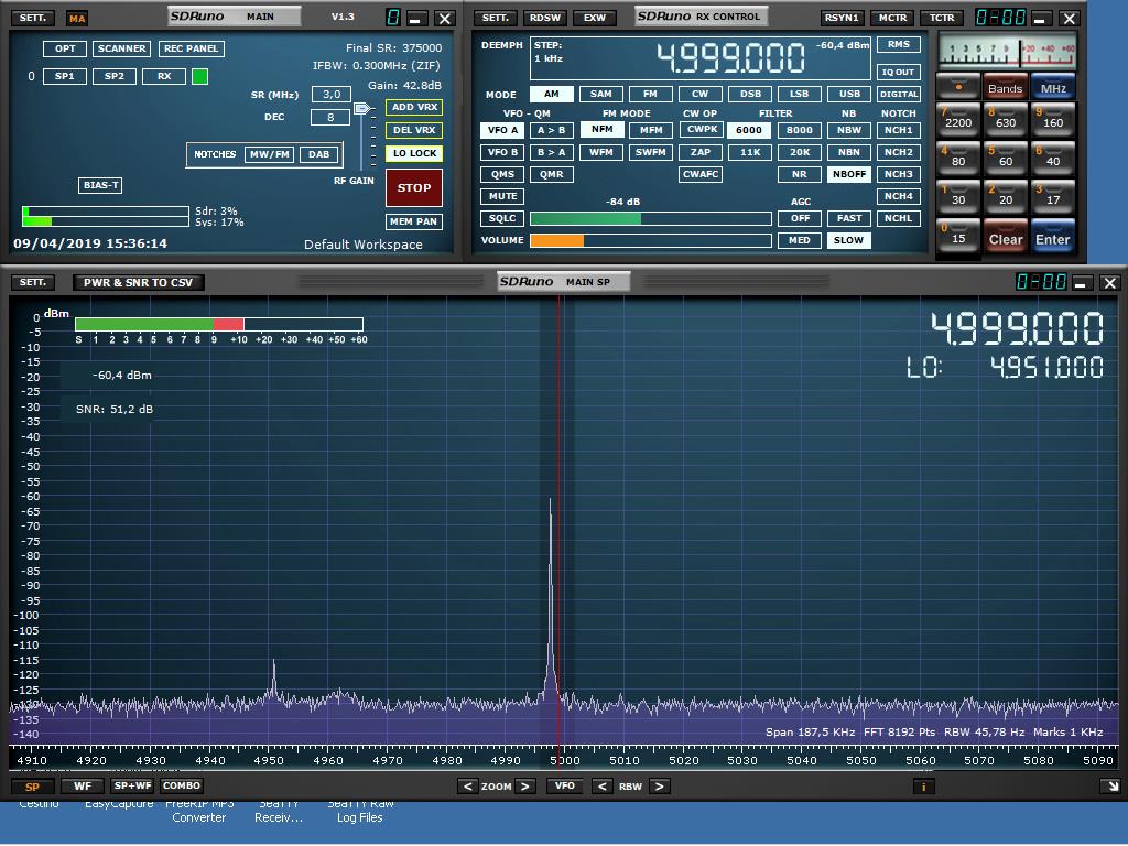

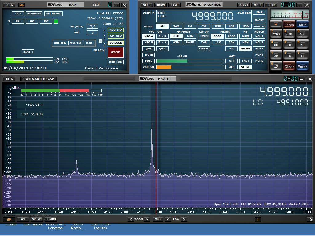

An RSP Processor is capable of measuring up to 0 dBm with a specified precision of better than 1 dB. My own RSP-1A + SDRuno has consistently given me a precison of +/- 0.4 dB and gave same precision today, when I did the tests uploaded below. To check this of course you must extend the range in SETT, as shown below.
Tests were done at 5 MHz, but precision has been the same at all frequencies I ever tested. When you increase the level above - 50 dBm you must start reducing the gain, in order to avoid the OVERLOAD ALARM. Also, when you come up to 0 dBm the RSP becomes "nervous": it shows the right level for a few seconds, then it starts "complaining" and the level shown becomes erratic, but please consider you are pushing in ONE MILLIWATT of power!
I even dared to go for a split second to + 10 dBm after setting the gain to minimum and the darn thing showed +10 dbm all right! No time to take a pic., though.
In any case it is so easy to make a PI attenuator using precision resistors I do not see the point of gettig this far and risk burning out the front end. The beauty of it is that you can CALIBRATE the attenuator with the RSP itself and SDRuno, so there is no danger whatsoever of making measurement errors.
