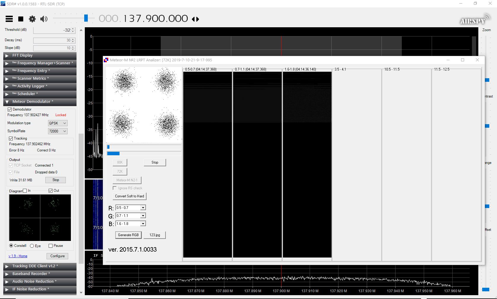

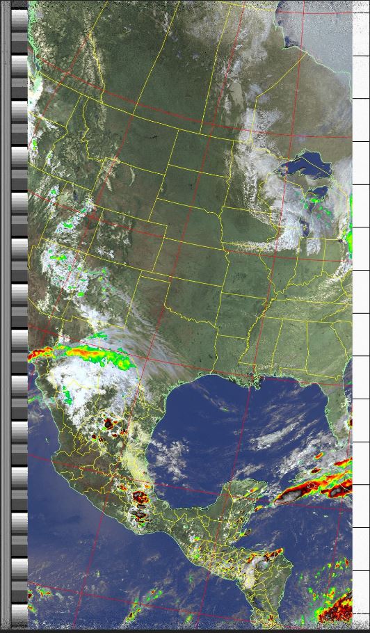

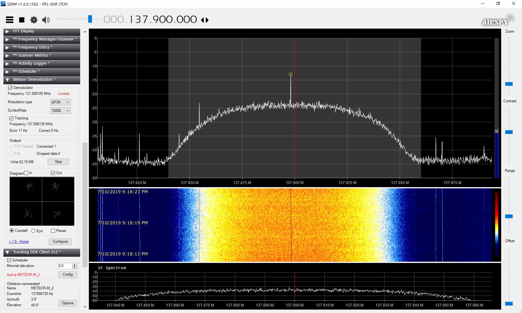

Here are some screenshots of the initial tests connecting to Meteor M_2 (the old one)and NOAA19:
SDRPlay/SDRSharp locked on to Meteor's QPSK signal :

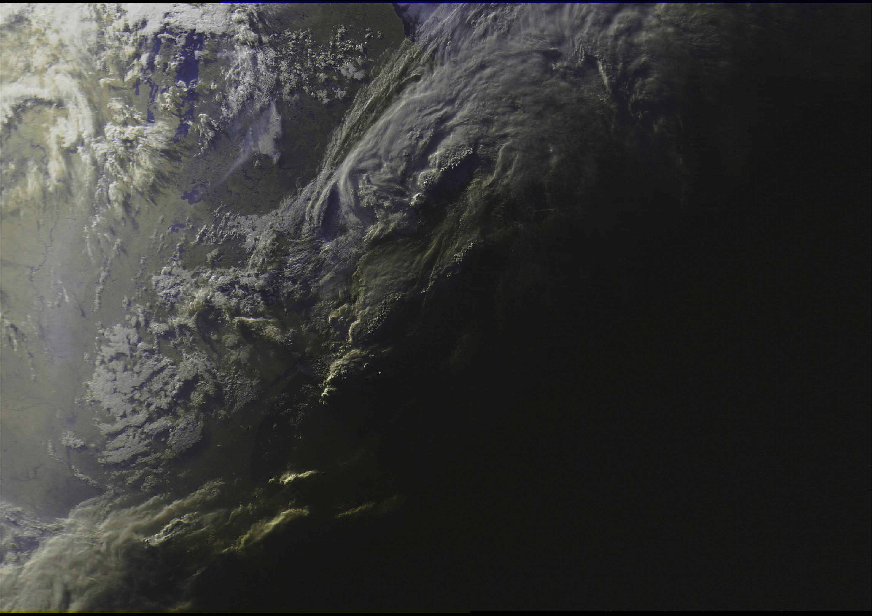

The demodulator view:
Resulting image:
Meteor's Infrared sensor is out of service, however a small portion of visible light in the northwest is captured in this shot.

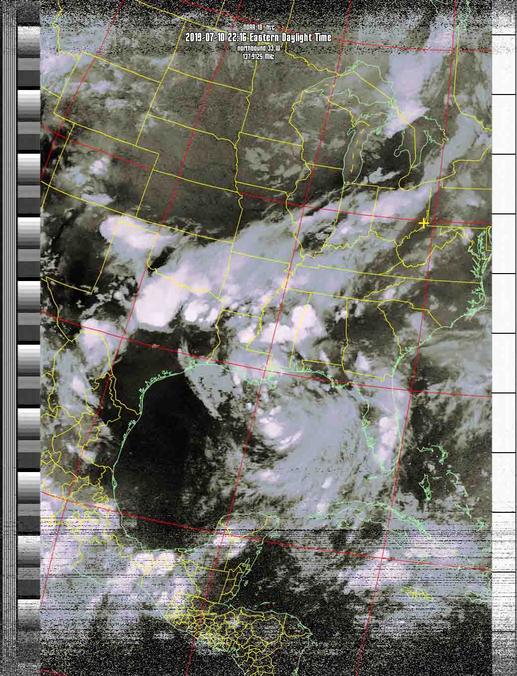

NOAA-18 captured earlier this evening (IR Channels 3 and 4 composite):

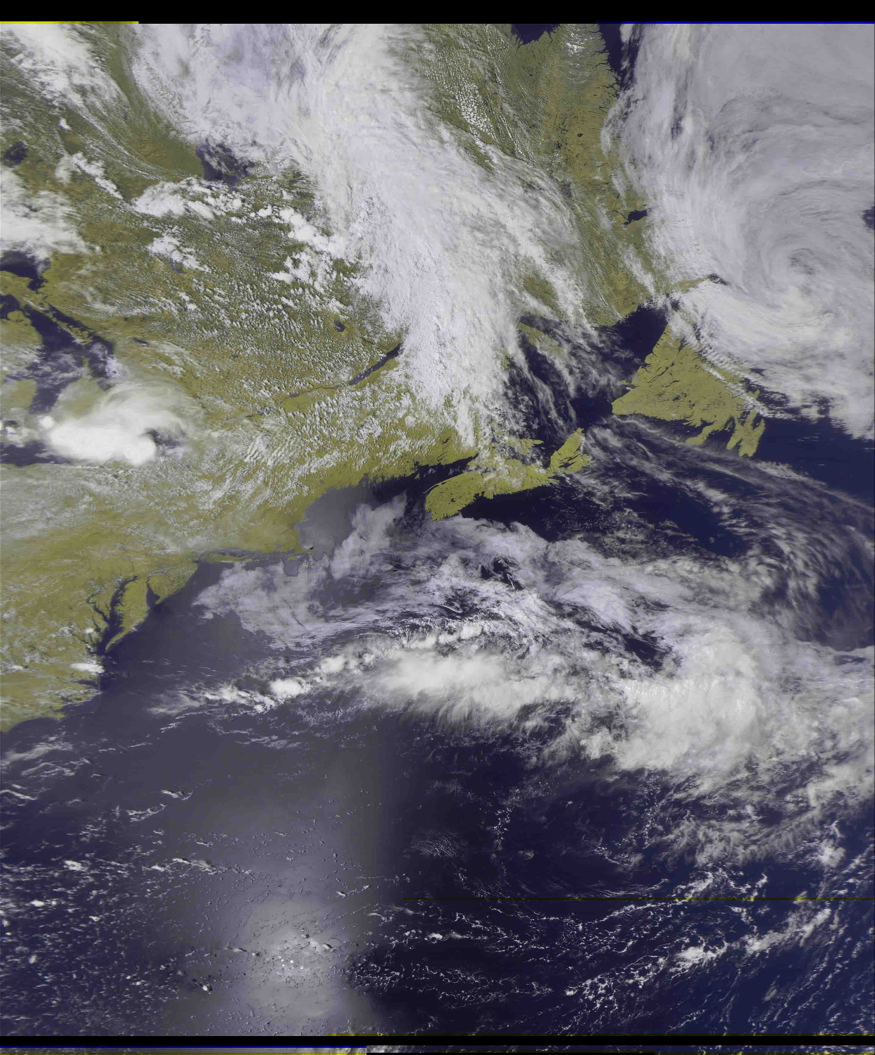

Meteor-M2 2 Image launched July 5th has begun sending LRPT images:
From this afternoon: The US Northeast and the Canadian Maritime provinces.
