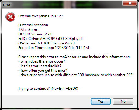

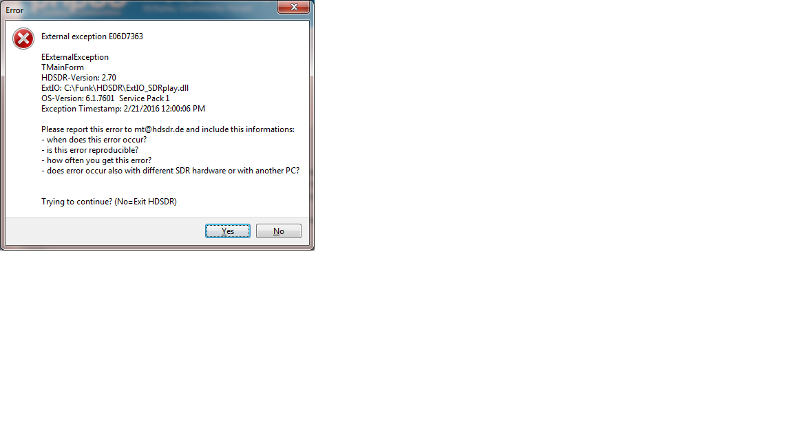

Post by 13dka » Sun Feb 21, 2016 11:18 am
After enabling station names in the menu and restarting HDSDR I'm getting this:
The plug-in no longer works and I have to roll back to 3.7. Windows 7 64-bit.

Post by sdrplay » Sun Feb 21, 2016 11:41 am
Just been fixed - V3.8.1 on the website (http://www.sdrplay.com/windows.html)

Post by 13dka » Sun Feb 21, 2016 12:21 pm
Umm for some reason my previous post disappeared.
Anyway, not fixed here, new screenshot, same content:
