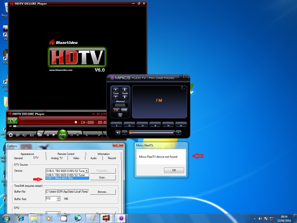

I downloaded the Mirics TV/DAB software as you suggested and installed it ...
But it does not find the Mirics (SDRplay) Hardware ...even though this is clearly present as indicated in Blaze to the left of the screen ...
Red arrows indicate both ..
So ..for some reason this Mirics Device ...or at least in this form as SDRplayer ...is incompatible with this pci USB 2 card ...
I guess I'll never know ..and it forces me to buy another pci card and no guarantees that would work either..
doh!
doh!

Re: SDRplay incompatibility with usb 2 pci card ?
I suggest ordering one with a NEC chipset. They are known to work with all the SDRs I've read about. Amazon carries them under various names. I have 2 USB PCIe cards from Renesas, both bought from Amazon. My particular cards have 4 sets of chipsets each, allowing full bandwidth 5.0Gbps per port, or 20.0 Gbps total). I got those cards because I use multiple SDRs simultaneously. I mention it only because if you plan to use more than one simultaneously you will need either more than one PCI USB card, or a single card with with multiple ports AND multiple chipsets, like I got. If you'll use only one SDR at a time, there's no need to spend the extra money, unless you plan to use the SDR AND other devices on the USB card simultaneously. The point is that SDRs take a LOT of bandwidth. Don't expect to use a SDR and anything else on the same card unless that card has multiple chipsets.
Back to the chipset type...remember NEC, and find a newer version (there are many versions out there). I went through 10 different cards before I found one that worked reliably. HOWEVER, that particular SDR used USB 3.0, so that was a whole different issue (as we all know, USB 3.0 SUCKS when it comes to compatability).
Just a suggestion...
Best regards and good luck.
