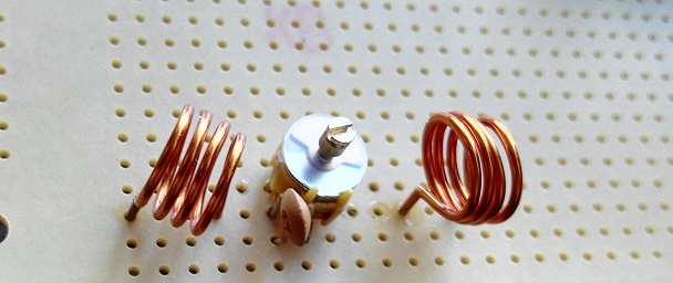

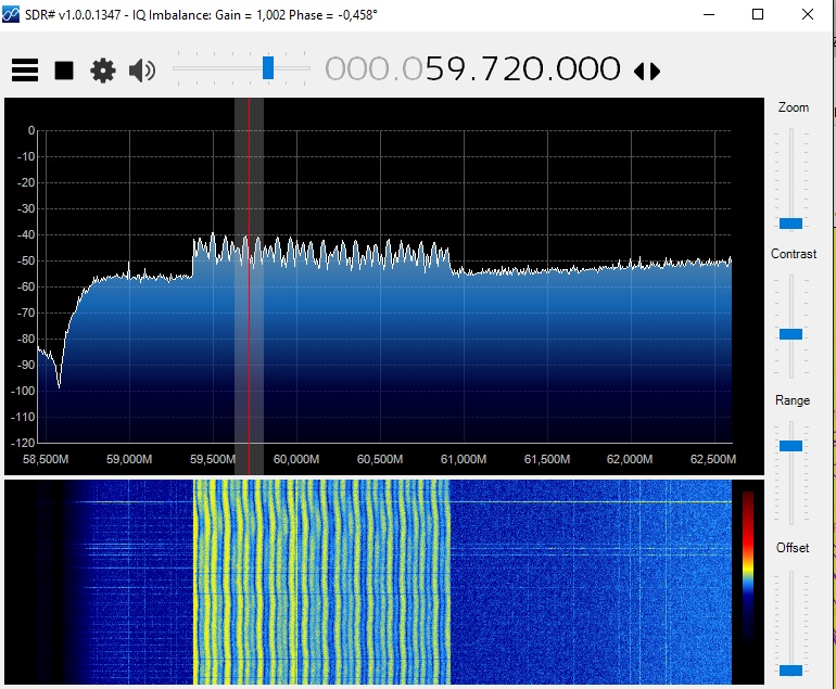

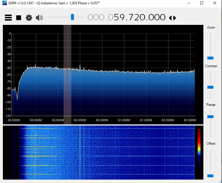

As experiment did I make a small low-pass filter with two coils and two capacitors. See the attached files for the results.
I still have some problems with signals from HF so next project will be to build a bandpass filter. But for now I am already very happy with this result.
Thanks for all your help.

Hi glad you had an improvementF1BJB wrote: My guess is that in most cases it should be at least 40dB stronger and this is not a bad result
It seems that ,as far as DAB signals around 60Mhz are concerned, I was a bit optimist in the above statement.
DAB is rather weak here but reception is only attenuated by 15 dB.
So there may be room for a low cost design improvement of the SDR play here
