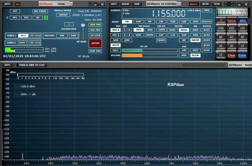

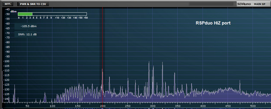

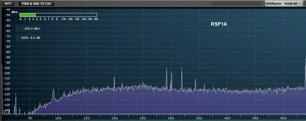

The RSP1A does not perform as well on LF as the RSP2 and the RSPduo when using a poor antenna. This is because the RSP1A has a higher noise floor. See screenshots below (same antenna - an HF G5RV) That said you can still get some signals by doing the following.
1. Turn off the LO Lock and set to Low IF mode
2. Spin the frequency until the LO is at 1000 kHz and then Lock the LO
4. Turn on the MW filter. Check IF AGC under SETTings in Main window. Adjust RF Gain to max (Attenuation to minimum). If you get AD overload you need to reduce gain (add attenuation) However this will increase the noise floor of the receiver.
5. You can use the zoom feature to show only the signals below 500 kHz.

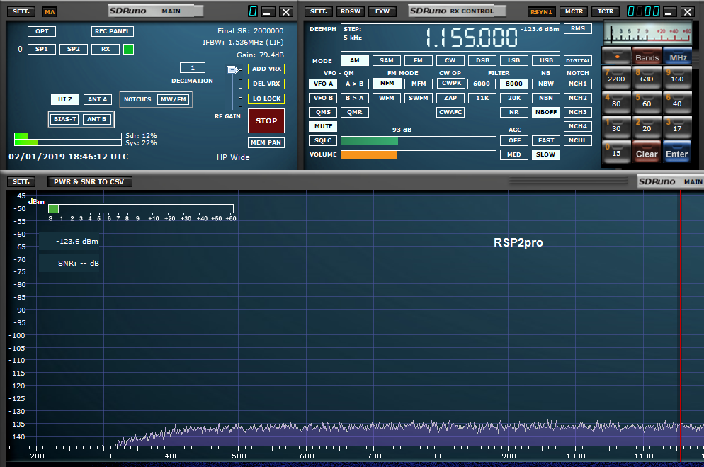

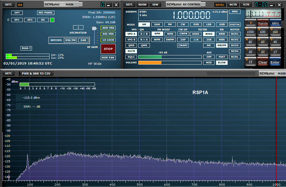

The RSP1A will work down to 1 kHz. but was not optimized for operation in the VLF, LF and MW bands. It only has one input and not three like the RSPduo and RSP2. The HiZ port on the RSP2 and RSPduo has better performance below 30 MHz. because it uses a different front-end RF and mixer section on the Mirics chip. You can really see this when operating under 2 MHz. Below you will find three screenshots which show the noise floor on LF for the different models. In all cases maximum IF and RF gain was used and all inputs were terminated with a resistive load. The MW filter was turned off for these tests. Spurious signals and high-order mixing are an issue for LF operation and using Low IF (instead of Zero IF) helps somewhat. Reducing the RF Gain actually adds attenuation and increases the Noise Figure (NF) of the receiver. External MW rejection filters, proper antenna selection and the use of a preselector will improve reception with any of these RSP devices.
