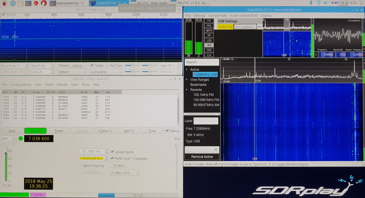

Hi all.
I tested the last OS image from SDRPlay Team, WSJT-X from https://physics.princeton.edu/pulsar/k1jt/wsjtx.html and ALSA virtual audio cable - it works, WSPR messages can be autonomously decoded.
So, it makes sense to add WSJT-X and alsa init command to the OS image.
