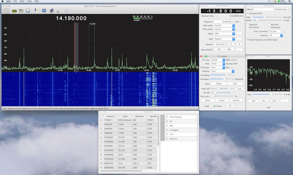

Gqrx has been really great on my Mac for the last few weeks, I've come to like it a lot and use it on Linux and OS-X
It was a little flaky though, more often than not after being launched for the first time in a while it would fail to find the RSP hardware.
Trying to fix that I downloaded and reinstalled the API/HW DRIVER – V2.11 (15TH NOV 2017) from the Mac SDRplay downloads.
And that killed it properly. I thrashed around in annoyance at myself for ages, re-downloading Gqrx Macintosh binaries and even rebuilding it entirely from source using MacPorts. Finally I hit upon the solution: Gqrx appears to rely not just on the SDRPlay drivers but on SoapySDRPlay.
I'm familiar with Soapy from Linux but had not installed it on my Mac. Installing the Macintosh version is easy (from here https://github.com/pothosware/SoapySDRPlay/wiki). Using Terminal:
git clone https://github.com/pothosware/SoapySDRPlay.git
cd SoapySDRPlay
mkdir build
cd build
cmake ..
make
sudo make install
The OS-X binary version of Gqrx (available here https://sourceforge.net/projects/gqrx/) now (mostly) finds the SDRPlay hardware with it's appropriate antenna options etc and works very well with both RSP2 and RSP1A.
"Mostly" becomes "every time" for me when I run CubicSDR first, use Cubic to select my RSP1A or 2, quit Cubic, then immediately run Gqrx.
Of course there is a small learning curve and everyone's mileage is going to vary but it's really sweet and great for HF DX and has a very neat simple memory-file system. Forgive the extremely crappy band conditions, it's been very noisy and a closed band for the last several days here.
Regards, Phil VK7JJ
