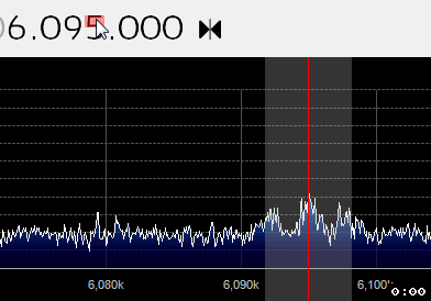

-- I just got inexplicable distortion in zero IF mode at 200kHz IF bandwidth (wider bandwidth too) in the SW BC bands. If a strong signal in the band would cause this, reducing gain should fix, right? It doesn't, only switching to low IF mode (and no AGC) does. That's a bit unsettling too. Please hear this series of recordings from RCI: First zero IF, after the gap low IF and then zero IF again, with AGC on and me tuning 1kHz up and down to show the "pings". Click
My main suspect is again DC correction, even though there is nothing visible of it on HF in general, no spike, no gap.

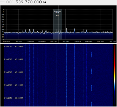

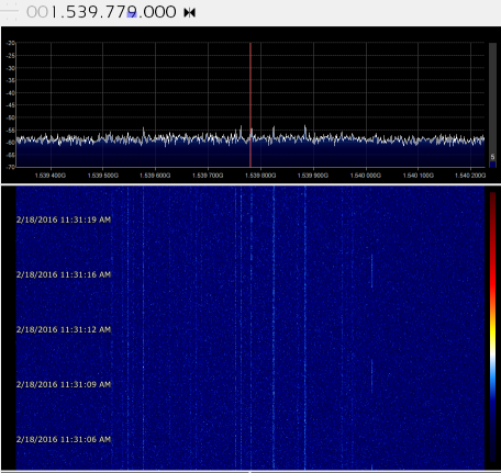

- Maybe the external noise in that band was limiting the possible results, so I made another, probably more apt comparison - I used (half indoors) a puny AX-31B amplified planar LPDA to get some Intelsat AOR signals, so I could leave the internal LNA off (which is not really "off" as I recently learned) on the RSP1 and this time the RSP1 clearly won the comparison in terms of "SNR without the LNA" as expected. Reception is on the edge with this setup, and the RSP's visibly better SNR gives JAERO a sufficient signal to decode.
RTL-stick:
RSP1/LNA off:
So despite the criticism about the built-in LNA in a recent review, it clearly does increase SNR on VHF and higher for me and SNR is better even without it. The added SNR makes all the difference between only seeing a station on the waterfall and listening to it, or decoding it.
My main suspect is again DC correction, even though there is nothing visible of it on HF in general, no spike, no gap - it sounds like the carrier is getting suppressed a lot then, if I tune +/- 1kHz to the side the distortion disappears and the carrier gets much stronger:
This is happening to a lesser extent in low IF mode as well. Observations regarding the distortion problem: Unlike SDR#, HDSDR does not respond to low IF mode and distorts in both modes, only offset of the LO frequency helps, offset of Tune frequency doesn't. SDR Console can't switch IF mode but doesn't distort.
