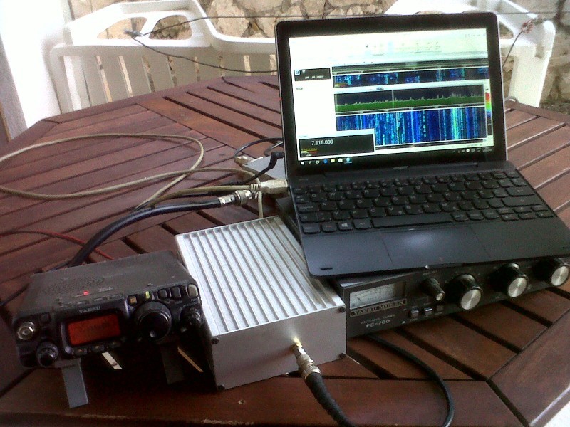

My metal box solution.... no more trouble with RF noise from PC PS.
In working position with FT817, antenna splitter, tuner, 10" PC

9a4db,
very nice solution! I'm going to try it here.
Wolf, DK7OB
