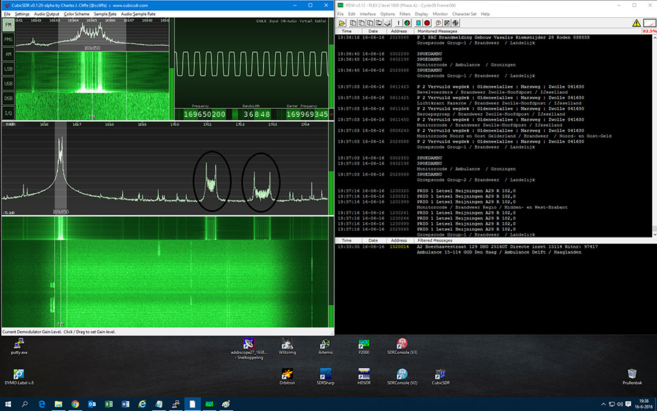

Post by fvdijke » Thu Jun 16, 2016 6:36 pm
It's working!!!!
Now for the final test i received some POSAC (P2000) signales and it looks great! Except for the 'echo' It covers some other signales completely. But i will figure that out, hopefully!
Second test, FMB radio. Works OK when set the samplerate to 1M. I see a lot of USB overflows (also in the first test)
Third test, LW and MW, no luck yet. Some weak signales on 1028KHz. Need the try with another antanna i think. I'm using now a Quadrifilar Helix Antenna (137 MHz) for NOAA.
So the last test will be the NOAA passes.
After these test i continue to do the ADS-B test. As for as i know i don't have a pre-amp connected, only a bandfilter for 1090MHz.
I let you know when i have better results!
For now, thanks for your tips and help!
