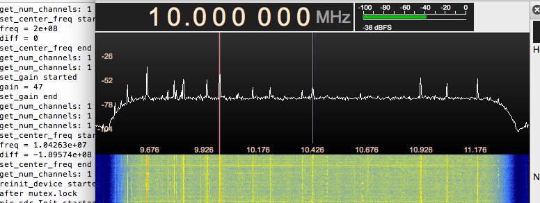

I managed to add SDRplay functionality for gqrx and gnuradio-companion with Macports under Yosemite last night and using El Capitan this afternoon. With, Yosemite you create a 'soapy' option for gqrx. With, El Capitan you get a 'sdrplay' option.
The simplest way is to first install CubicSDR and SoapySDR as other people suggested.
Next, do the standard install for gqrx and gnuradio, 'sudo port install gqrx', ...
Next, from the link (https://trac.macports.org/ticket/48451) that you pointed out you get the "gr-osmosdr_sdrplay_1.7.diff" file and copy the changes into the gr-osmosdr "Portfile" (/opt/local/var/macports/sources/rsync.macports.org/release/tarballs/ports/science/gr-osmosdr/Portfile - I used TextWrangle).
Next, you need to create the "mir_sdr_api_MacOSX_1.7.tar.gz" file. Create a folder called "mir_sdr_api_MacOSX_1.7" and 'cp /usr/local/include/mirsdrapi-rsp.h mir_sdr_api_MacOSX_1.7/mir_sd.h' and 'cp /usr/local/lib/libmirsdrapi-rsp-i386-1.8.1.so mir_sdr_api_MacOSX_1.7/libmir_sdr.so'. Note the name changes. Then 'tar -zcvf mir_sdr_api_MacOSX_1.7.tar.gz' to create the tar file. Then, you copy that into place - 'sudo cp mir_sdr_api_MacOSX_1.7.tar.gz /opt/local/var/macports/distfiles/gr-osmosdr/'.
Next, do the upgrade 'sudo port -d upgrade --enforce-variants gr-osmosdr +sdrplay' - this will fail because the checksums are wrong, but it tells you what they should be - put the new checksums into the PortFile and the upgrade should succeed.
That gave me a gqrx working with SDRplay

Re: SDRplay and Mac OS, installation questions -making progress but still..
bash-3.2# soapysdrutil

SDRPLAY support.. can you help ? It works but my rtlsdr stick has better reception right now and I bought the sdrplay to get more bandwith and better signal.

Can you explain what port you are trying to use on the RSP2 and what your config is currently. I can see you are at maximum IF gain but can you say what RF gain you have set? The AGC is trying to go even higher so it suggests you may not be connected to the port that has been programmed?
Yes my antenna is on port B. RFGAIN on 1.
Can I send new sdrplay soapy driver default settings to the device with a script before I open up the gqrx application ?
apparently the gqrx driver settings are not getting sent.
I moved the antenna over to the other part (noticed what you mentioned as well so I figured it's easier just to move to the antenna to antenna port a to see an the agc was still
trying for more.
I
trying for more.
I
