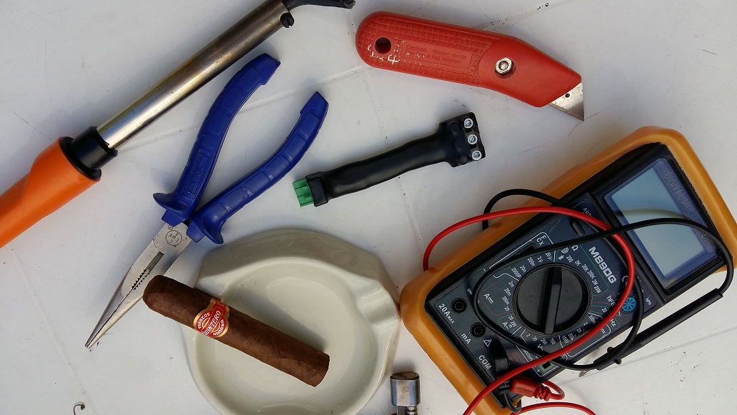

Ok, here it is, in the middle. 2MHz low-pass filter. Plug-in version. Cute as a small pig, as we tend to say hereby.
