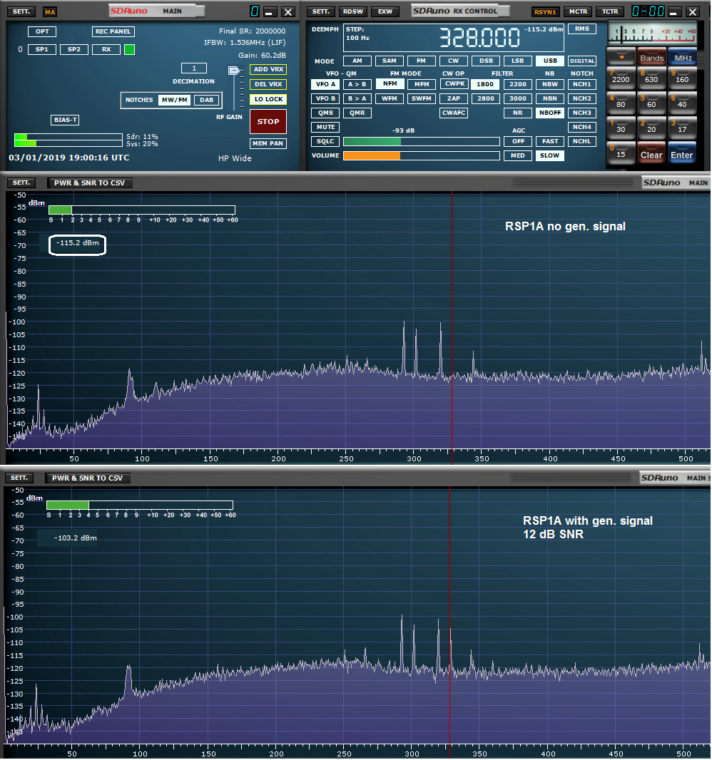

In order to verify these figures I did some tests on my own equipment using a signal generator.
LO locked at 1 MHz. and Low IF enabled. The results are as follows:
Tested Sensitivity for SSB/CW signal @328 kHz, - 1.8 kHz. BW - 12 dB SNR
RSP1A SMA 1.86 microvolts (-101.6 dBm)
RSPduo Tuner 1 SMA 1.97 microvolts (-101.1 dBm)
RSPduo Tuner 1 HiZ 0.16 microvolts (-123.2 dbm) **** Normalized to 50 ohm
Results were very close to those published by SDRplay
You can see screenshots showing test results on my Google Drive >> https://drive.google.com/open?id=1tmoS3 ... NeSfi9Dy78
Tests were also done using on-air signals and these are in the next post...

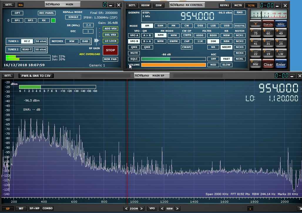

In my previous post I showed that the RSPduo performs better than the RSP1A in the LF band under lab conditions. How do these receivers perform when connected to an outside antenna?
I live in a semi-rural area and the nearest FM or AM radio station is many kilometers away. There is very little man-made noise at this location. So it is a good place to do LF DXing. I do receive a number of aviation non-directional beacons (NDB) on my doublet antenna which is not optimum for LF by any means.
In this test an RF signal combiner was used so that I could connect the antenna and a signal generator to the input of an RSP1A and a RSPduo HiZ port at the same time. This way it was possible to inject a signal from the RF generator while receiving band noise and signal activity. The screenshot below shows some local NDB's being received on an RSP1A. LO was locked at 1 MHz. and Low IF enabled. I tuned to a vacant channel so that I could measure the background noise in 1.8 kHz. Then I turned on the signal generator and adjusted it to get a 12 dB signal-to-noise-ratio (SNR). It required -103.2 dBm (1.58 microvolts) to get the desired SNR. This is shown in the lower spectrum display.
RSP1A - with antenna.png (378 KiB) Viewed 38838 times
The same test was done with the RSPduo on the HiZ port using a balun designed to convert 50 ohms to the HiZ port 1000 ohms. Then a signal was injected into the RF combiner to get the desired 12 dB SNR. The RSPduo HiZ port required -118 dBm to get an SNR of 12 dB. The results are shown below.
RSPduo - with antenna.png (381.3 KiB) Viewed 38838 times
Conclusions
- Under these test conditions one can clearly see weaker signals are now being received with the RSPduo.
- The noise floor is lower because the RSPduo has a better Noise Figure on this band.
- The difference in power required for the same SNR is 14.8 dB (-103.2 dBm - -118 dBm) at the test frequency
