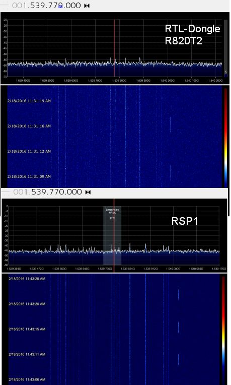

I take it you have one of the BA5SBA designed "direct sampling" variants of the RTL SDR that should employ a R820T2 tuner, which is surprisingly sensitive (better than my pricey but crappy DJ-X11!). It has been a while since I compared the sensitivity of the RSP1 (RSP2 is identical in this regard) vs. an RTL-stick but I think this screenshot proves there is (or should be) a difference:
This is a little active log-periodic antenna delivering Inmarsat signals to both receivers, I could see the Inmarsat ACARS transponders on the RTL, but only the much better SNR of the RSP1 enabled me to actually decode something.
