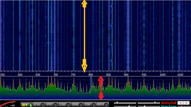

Thanks octave9. I have used the slider but that is not the solution.
Please see the attachment. I wish to expand the window marked with red arrows and decrease the window marked with yellow arrows.
Is this possible? It seems possible when one looks at the Youtube clip from Mile Kokotov.
Can anybody help me to achieve this improvement?

Re: HDSDR visualtization with RSP2
Hold the right button of your mouse over the bottom line of your waterfall and stretch it upwards. This will shrink the waterfall and increase the height of the spectrum display.
Thanks a lot to Tech. Support. It works fine!
